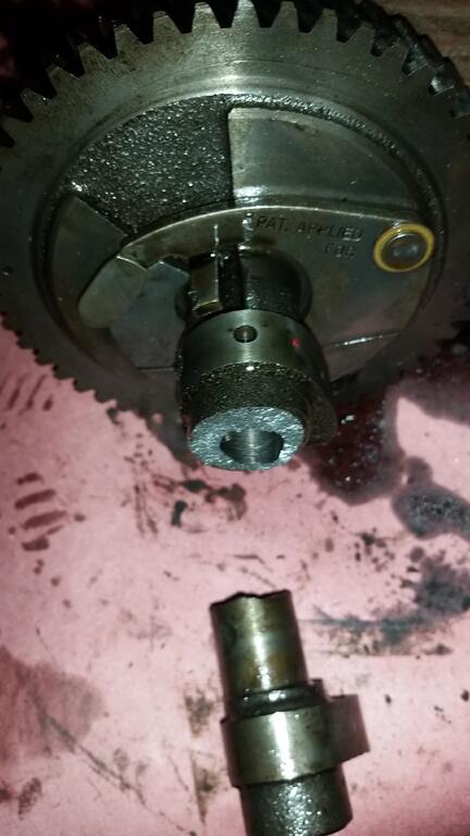

gt14rider 1,291 #1 Posted January 14 (edited) Started pulling this apart about end of August, just got it in the basement, pulled the engine apart, too have a look see. (See video ) Found it. think I have a nother cam around here 20260114_101853.mp4 Edited January 14 by gt14rider 2 Share this post Link to post Share on other sites
ri702bill 13,392 #2 Posted January 14 (edited) Hmmm. is the cam the source of the problem or is it the victim here?? Did you break the connecting rod?? I ask because I bought two C81's years ago. One ran but was tired; the other broke the connecting rod, snapped the cam in two and blew out the back cam mount. And ventilated the block bigtime. I did save the head, flywheel, tins, oil pan , points & coil though... Edited January 14 by ri702bill 2 Share this post Link to post Share on other sites
gt14rider 1,291 #3 Posted January 14 Hi all @ri702bill , rebuilt that k181 in spring of 2018, put it together with a bunch of parts, so could be it was cracked when installed, it all ways had a tic, but not bad enough to pull apart, the dreaded kohler tic. Anyway got to dig up another cam. Share this post Link to post Share on other sites

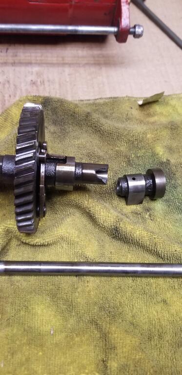

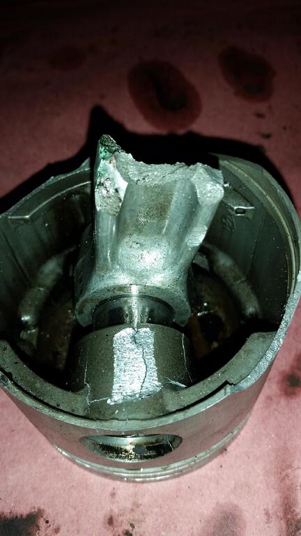

gt14rider 1,291 #4 Posted January 14 Got it apart, what you think? A little JP Weld might work. Got a cat scan done, confirmed, cam fubar. 3 5 Share this post Link to post Share on other sites
pfrederi 21,342 #5 Posted January 14 Love the CAT scan 1 3 Share this post Link to post Share on other sites
kpinnc 19,107 #6 Posted January 14 Cat scan. ...I'm using that one! Share this post Link to post Share on other sites

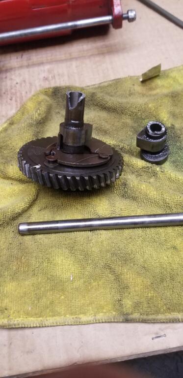

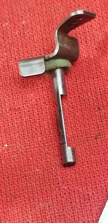

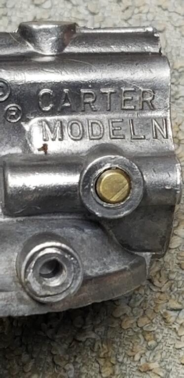

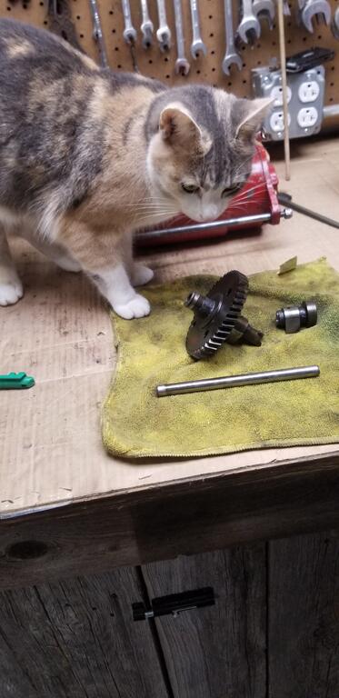

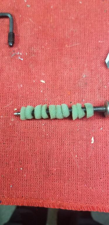

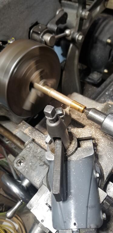

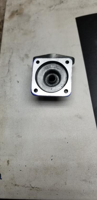

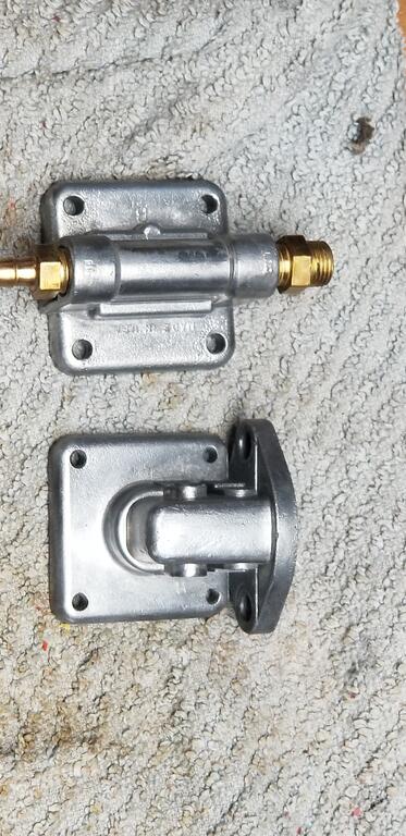

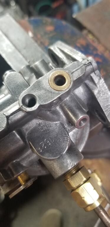

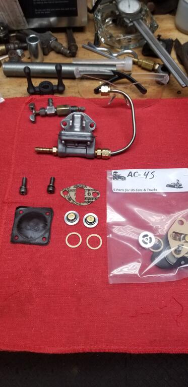

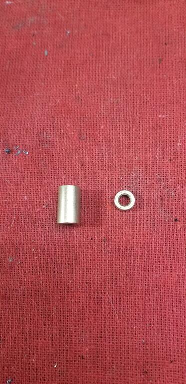

gt14rider 1,291 #7 Posted January 15 Yah she's a humdinger, she has to be right in the middle everything. Found the camshaft, cleaned it up, should work. Will clean up the block, new gaskets, couple seals, I already rebuilt the fuel pump, and carburetor. Had to make bushing NLA, come out great, new shaft and made some foam gaskets out of a pre air filter . 6 Share this post Link to post Share on other sites

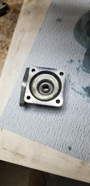

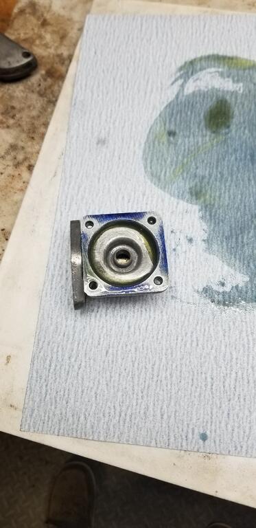

WHX?? 58,388 #8 Posted January 15 What is the blue stuff on the fuel pump? Nice job on the bushing maybe we can make them now @Achto Always thought a o-ring on the shaft wouldn't hurt. Share this post Link to post Share on other sites
Achto 32,963 #9 Posted January 15 10 minutes ago, WHX?? said: Nice job on the bushing maybe we can make them now Shouldn't be too difficult. Share this post Link to post Share on other sites

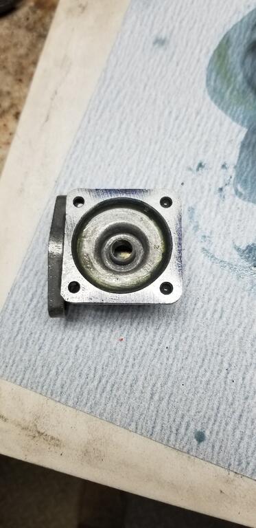

gt14rider 1,291 #10 Posted January 15 @WHX?? the blue is magic marker, poor man's Persian blue. Put it on sandpaper on glass, check the high spots 3 Share this post Link to post Share on other sites
WHX?? 58,388 #11 Posted January 15 (edited) 15 minutes ago, gt14rider said: poor man's Persian blue Thought maybe it was a bluish Permatex sealer I tried once that did't work. We was just talkin about glassing pumps. Good trick ... gonna those pics for my fuel pump instructional. I always misted them with a rattle can like a head but the mist can go where you don't want it to. Edited January 15 by WHX?? 1 Share this post Link to post Share on other sites

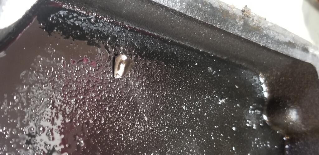

gt14rider 1,291 #13 Posted January 15 @WHX?? I don't think it was broken al the way, in the video you can see a chunk out of the cam,but it didn't break till I took the cam pin out. This was in the pan. It ran when it was parked. Lasted 8 years 1 Share this post Link to post Share on other sites
WHX?? 58,388 #14 Posted January 15 (edited) 3 minutes ago, gt14rider said: broken al the way, Ahhh Can't see the vid my internet too slow and sucks. Especially with vids. Edited January 15 by WHX?? Share this post Link to post Share on other sites

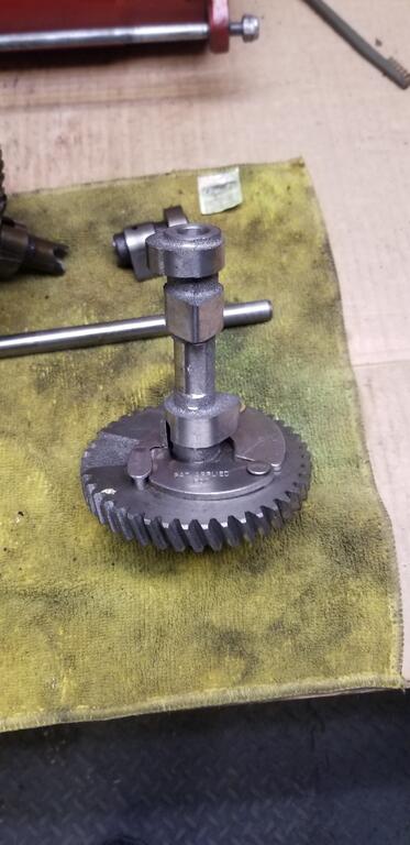

gt14rider 1,291 #15 Posted January 15 Here's a picture of cam 1 1 Share this post Link to post Share on other sites
WHX?? 58,388 #16 Posted January 15 Good thing that chip didn't go through the timing gears. 2 1 Share this post Link to post Share on other sites

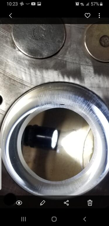

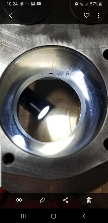

gt14rider 1,291 #17 Posted January 16 Got a couple of questions, should I just hit the cylinder with dingle balls, and reinstall piston. 2-4 thousands,top middle and bottom. 2.956 - 2.959 (measurements may vary, used telescoping gauge and calipers) don't have big enough micrometer. No ridge Share this post Link to post Share on other sites
gt14rider 1,291 #18 Posted January 16 (edited) double posted. Edited January 16 by gt14rider Share this post Link to post Share on other sites
WHX?? 58,388 #19 Posted January 16 Your gonna get yelled at by the guys for using calipers but hey we don't have mics. Yeah a little out but you were using calipers so your dims might be questionable. Did it smoke? What did the top of the piston look like... oil wash? Try Richard's trick. 2 Share this post Link to post Share on other sites
sqrlgtr 4,225 #20 Posted January 16 3 hours ago, WHX?? said: Your gonna get yelled at by the guys for using calipers but hey we don't have mics. I know a caliper is no replacement for a good mic but I would have no trouble trusting the measurement's from the telescoping gauges if we are using a known repeatable caliper. Could always double check by using @953 nut 's trick. Which by the way is a great post if you haven't had a chance to read it. 1 Share this post Link to post Share on other sites
gt14rider 1,291 #21 Posted January 17 @WHX?? @sqrlgtr took my time and measured the cylinder, top, middle, bottom and below ring line. Side to side and front to back. Piston is 20 over. Here are the numbers. Share this post Link to post Share on other sites

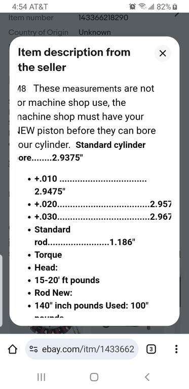

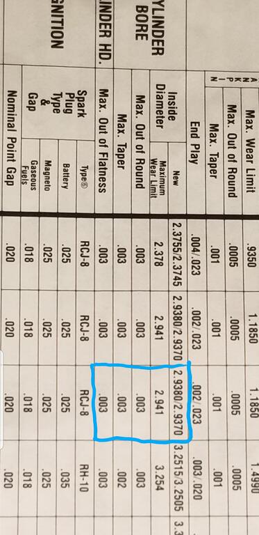

gt14rider 1,291 #22 Posted January 17 Kohler specs. Share this post Link to post Share on other sites
sqrlgtr 4,225 #23 Posted January 17 I would think with those numbers you could just hone and set of rings and should be good. Share this post Link to post Share on other sites
gt14rider 1,291 #24 Posted January 17 Ok just ordered genuine kohler rings, and a 3" dingleberry hone. Now we wait. Connecting rod and crank journal look good so not going to change. Already glassed head and lapped the valves. 1 Share this post Link to post Share on other sites
