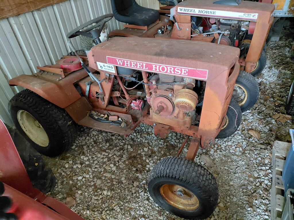

sqrlgtr 2,620 #28 Posted January 14 Im a C160 With the k341 Kohler fan so my vote goes to it. 1 Share this post Link to post Share on other sites

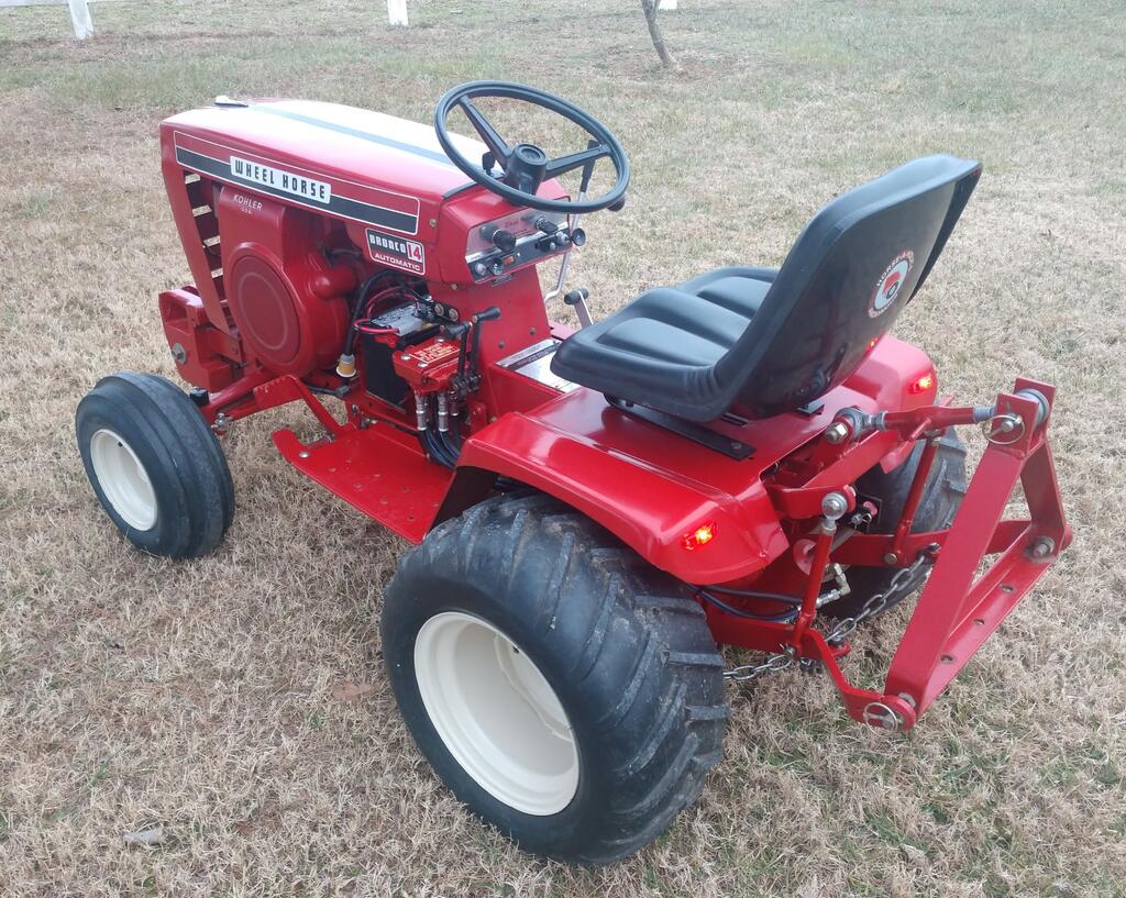

kpinnc 17,928 #29 Posted January 14 Definitely the C160 if you're planning on a hydraulic setup at the rear. My Bronco is basically the same, and I just added a D series spool valve to control the rear separately. Plus the Sundstrand has 4 bolts on to to work with attaching fabrications to. Not sure if that black hood has an Eaton or not, but those only have two bolts to work with. I just fabbed a 1/4 inch plate steel toolbox and added pivots for the upper lift arms and a seperate cylinder. No way that same design would work with (1) a fuel tank under the fender and (2) no room with an Eaton. 3 Share this post Link to post Share on other sites
Handy Don 16,286 #30 Posted January 14 34 minutes ago, kpinnc said: lus the Sundstrand has 4 bolts on to to work with attaching fabrications to. Not sure if that black hood has an Eaton or not, but those only have two bolts to work with. Plus the Sunstrands have internal pressure relief for the hydraulic pump so chaining tandem center control valves is straightforward 1 Share this post Link to post Share on other sites
kpinnc 17,928 #31 Posted January 14 35 minutes ago, Handy Don said: Plus the Sunstrands have internal pressure relief for the hydraulic pump so chaining tandem center control valves is straightforward Excellent point! Share this post Link to post Share on other sites
Easton Rich 1,139 #32 Posted January 14 Is there any difference in strength between the two? How do I strength test one? Share this post Link to post Share on other sites
kpinnc 17,928 #33 Posted January 14 1 hour ago, Easton Rich said: Is there any difference in strength between the two? How do I strength test one? Both make around 700psi on the hydraulic pump. So far as torque at the wheels, I don't have numbers. But on a decent model of either one, you'll break something internally before stopping one. I have a couple Eatons and Sundstrands, and either will spin wheels under load. 1 Share this post Link to post Share on other sites
Handy Don 16,286 #34 Posted January 14 I would go to the specs. Both use equivalent WH final drive gears. Both run the hydraulics at 700psi and similar volumes (a bit over 1 gal per minute at full pressure). The Eaton 1100 can transfer on the order of 17hp for motion I don’t know about the Sunstrands and it may depend on the model Share this post Link to post Share on other sites
kpinnc 17,928 #35 Posted January 14 1 minute ago, Handy Don said: The Eaton 1100 can transfer on the order of 17hp for motion The only numbers I remember was the Eaton 1100 has 3 times the output torque over the 700 model. Can't speak for the difference between Sundstrands. 1 Share this post Link to post Share on other sites

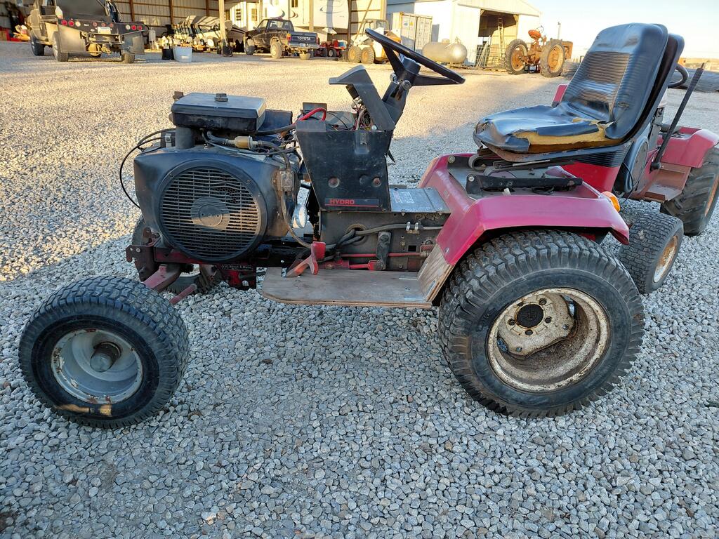

Easton Rich 1,139 #39 Posted January 15 Oh and I'll make sure to get pictures of the parts tractor on Monday. Share this post Link to post Share on other sites

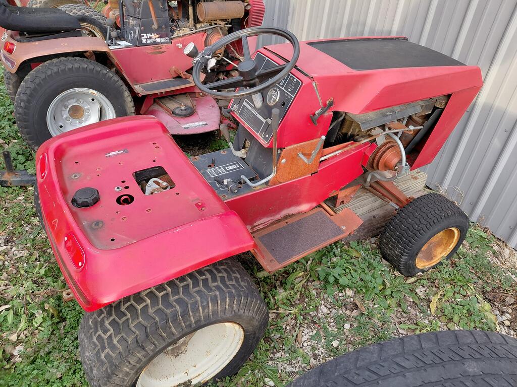

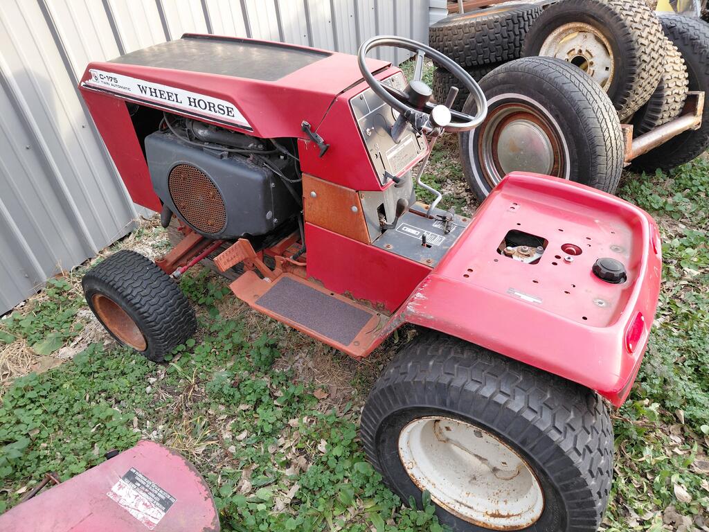

Easton Rich 1,139 #40 Posted January 20 Well Monday went by fast. I bought the parts tractor sight unseen.... I gotta stop doing that. It's the super rare woody anniversary edition... 1 of 1. You'll just have to wait to see what I mean 1 Share this post Link to post Share on other sites
Easton Rich 1,139 #41 Posted January 20 Here she is in all her glory! I gotta stop buying them sight unseen. Or just stop all together! 1 Share this post Link to post Share on other sites
Easton Rich 1,139 #42 Posted January 21 I forgot to mention that's the parts machine. It fell off a truck at 55mph. Frame is welded, axle is welded (Which I have another of), and the trans needs new seals, but all in all it is a great parts machine. I'll probably be getting rid of the Eaton out of this unless the C-160's sunstrand is bad. Share this post Link to post Share on other sites
kpinnc 17,928 #43 Posted January 21 There's alot of Wheel Horses in those pictures. Are they all yours? Parts machines are very good to have. I have had a couple myself. Side note- I just modded my 523H with a taller steering column. Your parts 520H looks to have a factory extension on it. I've not seen that before. Share this post Link to post Share on other sites
JoeM 9,768 #44 Posted January 21 On 1/19/2026 at 9:10 PM, Easton Rich said: super rare woody anniversary edition... 1 of 1 Maybe more so then you think, looking at the belt guard, the ultra rare cutting board edition? Foot pads are nicely done tho Share this post Link to post Share on other sites
Easton Rich 1,139 #45 Posted January 22 They are all mine for now. @Shuboxlover bought a few in the background. I didn't even notice it had the extension. Share this post Link to post Share on other sites
kpinnc 17,928 #46 Posted January 22 1 hour ago, Easton Rich said: I didn't even notice it had the extension. All of my 520s were 1990 models, so that may be normal for reduction steering. I wouldn't know for sure. All of mine had the swept axle but no reduction steering. Share this post Link to post Share on other sites
Easton Rich 1,139 #47 Posted January 22 Yeah, I'm pretty sure this is a 92 or 93 model. I just sold my '96 520 to @Shuboxlover and its mostly the same. I'll do some research Share this post Link to post Share on other sites
Lee1977 7,632 #48 Posted January 23 (edited) Somebody removed the 8 1/2" wide rear wheels, thoes are 7" that are on it. The later model three hole steering wheel has a longer extinction on the bottom where it attaches to the shaft. Don't know if that steering wheel ever came on a 520 from the factory. Edited January 23 by Lee1977 Share this post Link to post Share on other sites
Easton Rich 1,139 #49 Posted January 23 I know. I've got the correct steering wheel. Share this post Link to post Share on other sites
