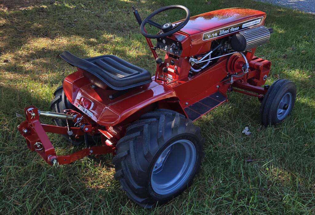

kpinnc 19,107 #6 Posted January 10 2 hours ago, ri702bill said: Depending on the implement being driven by the PTO, the instantaneous engagement of an electric clutch may be an issue; better done with the traditional lever type where you can ease into it. Soft start clutch controller works well for this issue. I've used one for 8 years and it works great. 2 hours ago, Easton Rich said: I’d like to have electric clutch, hydraulics, forward swept axle and gear reduction steering, Eaton 1100 or 5091 8spd? Maybe C-195 3pt? I didn't use hydraulics on this one but it can be done! Not a C-series but has alot of those parts in it. 12 Share this post Link to post Share on other sites
Easton Rich 1,292 #7 Posted January 10 31 minutes ago, kpinnc said: Soft start clutch controller works well for this issue. I've used one for 8 years and it works great. I didn't use hydraulics on this one but it can be done! Not a C-series but has alot of those parts in it. Is there a build thread on this one? 2 Share this post Link to post Share on other sites

kpinnc 19,107 #11 Posted January 10 1 hour ago, Easton Rich said: Is there a build thread on this one? Yes. Frokenstien Build 3 Share this post Link to post Share on other sites
