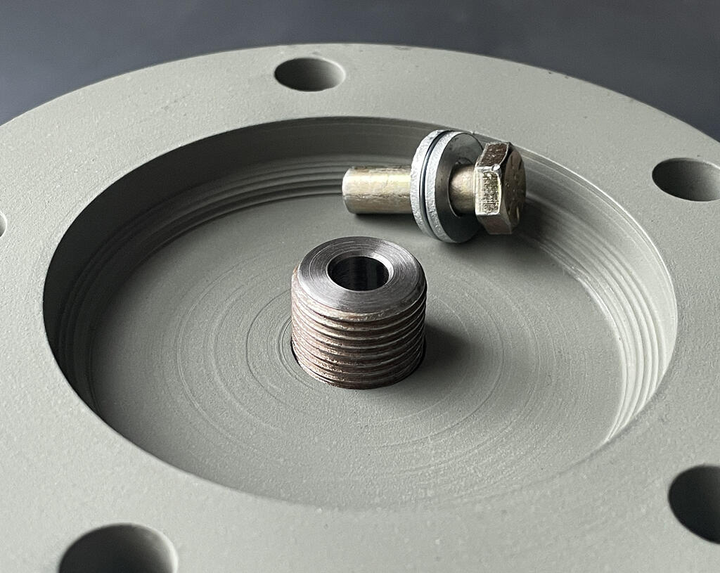

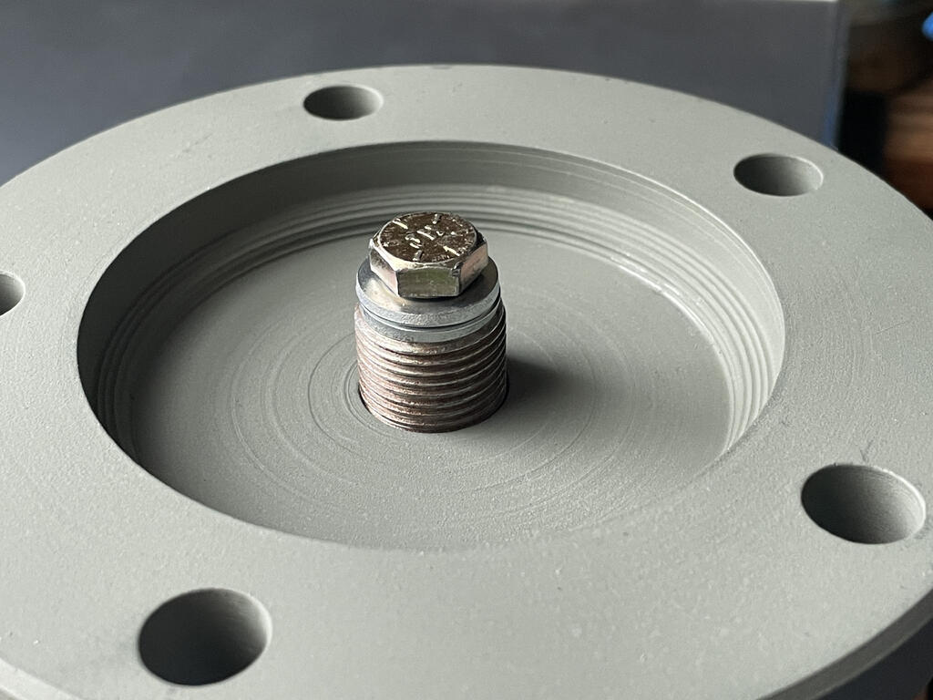

Blue Chips 855 #29 Posted January 9 (edited) Small improvement: I made a very simple 'thrust bearing' for the end of the puller's center bolt. I bored a 5/16"+ hole in the end of the 3/4-16 grade 8 center bolt, squared off the end of the bolt, cut the threads off of a partially-threaded grade 8 5/16 bolt, and added two 5/16 SAE washers. If I wanted to get fancier, I could have cut a groove in the shank of the 5/16 bolt for a small O-ring to retain it in the center bolt, but I figure enough is enough. A dab of grease will hold the 5/16" bolt in the end of the center bolt while the puller is being set up, and a bit of grease or anti-seize or other EP lube (ZX1?) on and between the washers would be a good idea when using the puller. Edited January 9 by Blue Chips 13 Share this post Link to post Share on other sites
