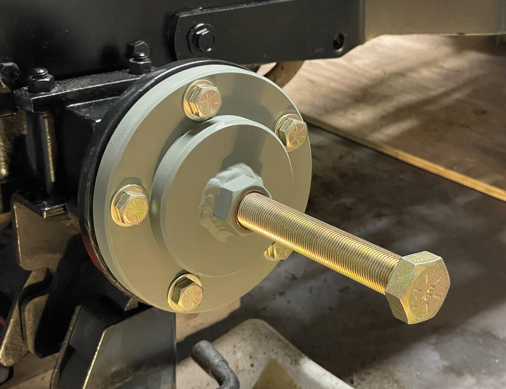

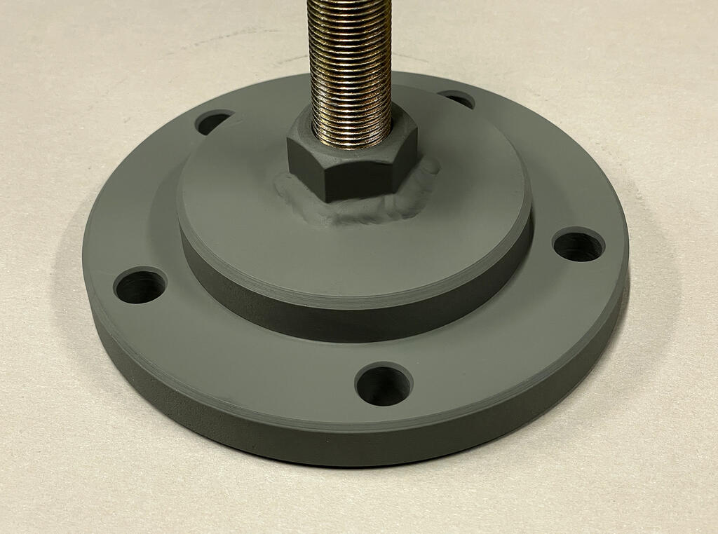

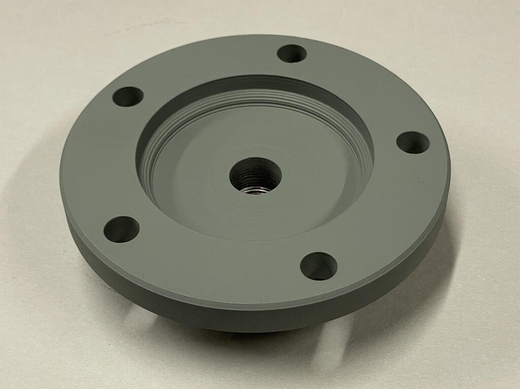

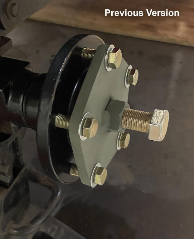

Blue Chips 881 #1 Posted January 8 (edited) I built a hub puller a couple of weeks ago, which worked great (see below), but I thought I could improve upon it, so I fabbed up a new version, which has two advantages over the first one: It has a cavity for the hub spigot, so it can be bolted flat against the hub flange, which can add some rigidity to the flange, and it can be used with hubs that have been retrofitted with studs, as well as those that are still using lug bolts. Mine still has lug bolts, but I used a separate set of bolts and washers with the puller, rather than the lug bolts, in order to prevent any damage to the puller plate or to the tapered part of the lug bolts. The center bolt is longer than it needs to be, but that's what I had on hand. I put a dab of anti-seize on the center bolt threads. Previous version of hub puller: New version: Back of puller (I dressed the weld a bit, just for the heck of it): Front of puller: Edited January 8 by Blue Chips 3 20 Share this post Link to post Share on other sites

ri702bill 13,263 #3 Posted January 8 Grade 8 fine thread bolt - excellent choice. Is there any kind of a bearing on the business end? 4 Share this post Link to post Share on other sites

Blue Chips 881 #12 Posted January 9 2 hours ago, ri702bill said: Grade 8 fine thread bolt - excellent choice. Is there any kind of a bearing on the business end? Not yet, but it wouldn't be hard to put some kind of a simple 'bearing' at the end by drilling a hole in the end of the bolt and inserting a T-cross section piece (like a bolt head) and maybe a washer as well. I may look into that. 3 Share this post Link to post Share on other sites
Handy Don 17,623 #13 Posted January 9 1 minute ago, Blue Chips said: Not yet, but it wouldn't be hard to put some kind of a simple 'bearing' at the end by drilling a hole in the end of the bolt and inserting a T-cross section piece (like a bolt head) and maybe a washer as well. I may look into that. Thrust bearing? 1 2 Share this post Link to post Share on other sites
Blue Chips 881 #14 Posted January 9 Just now, Handy Don said: Thrust bearing? I'll look into possible options. I think the main thing is to prevent the end of the bolt from getting mashed and to prevent damage to the hub from the twisting bolt. A roller-type thrust bearing would reduce effort, but it would have to be a pretty small bearing. Maybe a sintered bronze oil-impregnated washer between the end of the bolt and an inserted bolt head...or something like that. 3 Share this post Link to post Share on other sites

Blue Chips 881 #17 Posted January 9 (edited) 31 minutes ago, lynnmor said: I made a similar one that I considered marketing but the material cost and hours were high and I doubt that it would sell for the price I would need. I think the only way to make anything like a profit on something like this would be to crank them out with something like a CNC laser or plasma cutter and CNC lathe/mill, and you'd have to sell a lot of them to get the unit price down. I like your idea of a removeable handle to prevent the puller from rotating when turning the puller bolt (or if you need to rotate the axle or tighten something else). On mine, I left most of the big hex nut exposed so that you could put a box-end wrench on it while turning the puller bolt with another wrench. Edited January 9 by Blue Chips 7 Share this post Link to post Share on other sites
