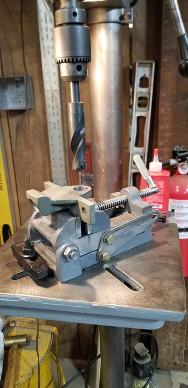

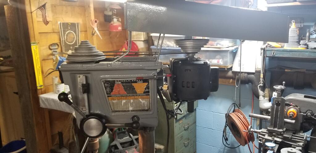

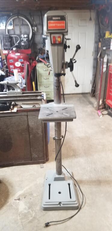

gt14rider 1,278 #26 Posted January 15 Couple of pics 2 1 Share this post Link to post Share on other sites
ebinmaine 80,709 #27 Posted January 15 44 minutes ago, gt14rider said: pics The vises I have ordered have the same sort of grooves but much shallower. Not having ever used one I wouldn't know, but it seems like the deeper groove would be better for holding 3/4 stock. 2 Share this post Link to post Share on other sites

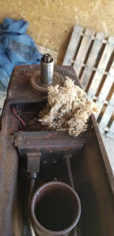

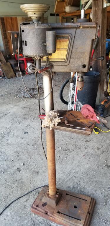

WHX?? 58,136 #28 Posted January 15 On 1/10/2026 at 7:03 AM, WHX?? said: It's got a v groove cut in the front jaw for holding round stock. Could be a little deeper but works ok. It is nice along with the vertical groove. 11 hours ago, gt14rider said: Picked these vices up at a flee market, Heck of a deal. That a Craftsman press rider? Share this post Link to post Share on other sites
Wayne0 1,634 #29 Posted January 15 That first vice looks JUST like my vintage Craftsman. Belonged to my Grandfather. (I'm 71) 2 Share this post Link to post Share on other sites
lynnmor 9,040 #30 Posted January 15 8 hours ago, ebinmaine said: The vises I have ordered have the same sort of grooves but much shallower. Not having ever used one I wouldn't know, but it seems like the deeper groove would be better for holding 3/4 stock. The round stock should contact within the V-groove not the corners. Nearly all vises can accommodate replacement or added jaws, most machine shops make their own for the work they do. For 3/4" stock you can make a simple drawing or do the trig work. 1 Share this post Link to post Share on other sites
ebinmaine 80,709 #31 Posted January 15 57 minutes ago, lynnmor said: The round stock should contact WITHIN the V-groove not the corners That's the part I was looking for. Thanks. Share this post Link to post Share on other sites
gt14rider 1,278 #32 Posted January 15 Yes it is. 8 speed 2 Share this post Link to post Share on other sites

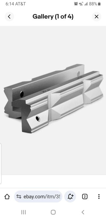

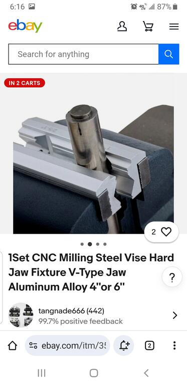

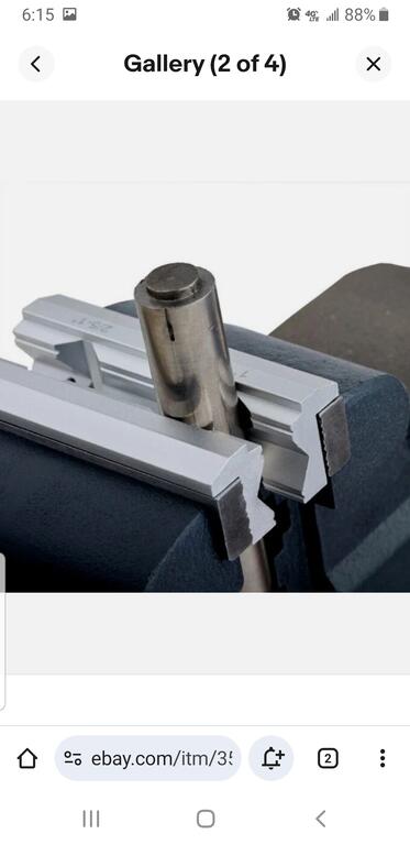

gt14rider 1,278 #33 Posted January 15 @ebinmaine found these on Ebay, just got to know how wide new vice is. Under $10 2 1 Share this post Link to post Share on other sites
ebinmaine 80,709 #34 Posted January 15 4 minutes ago, gt14rider said: @ebinmaine found these on Ebay, just got to know how wide new vice is. Under $10 Can you please send me the link? Share this post Link to post Share on other sites
WHX?? 58,136 #35 Posted January 16 1 hour ago, gt14rider said: Yes it is. 8 speed Wow I have the same exact one. Just had to put a new belt on it after many years of abuse. 1 Share this post Link to post Share on other sites

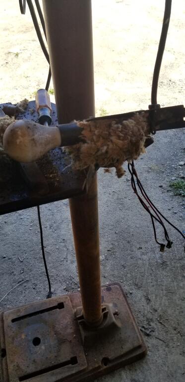

gt14rider 1,278 #36 Posted January 16 Got mine from a friend, $100. Had to clean it up, sitting in a barn for 15 to years 2 Share this post Link to post Share on other sites

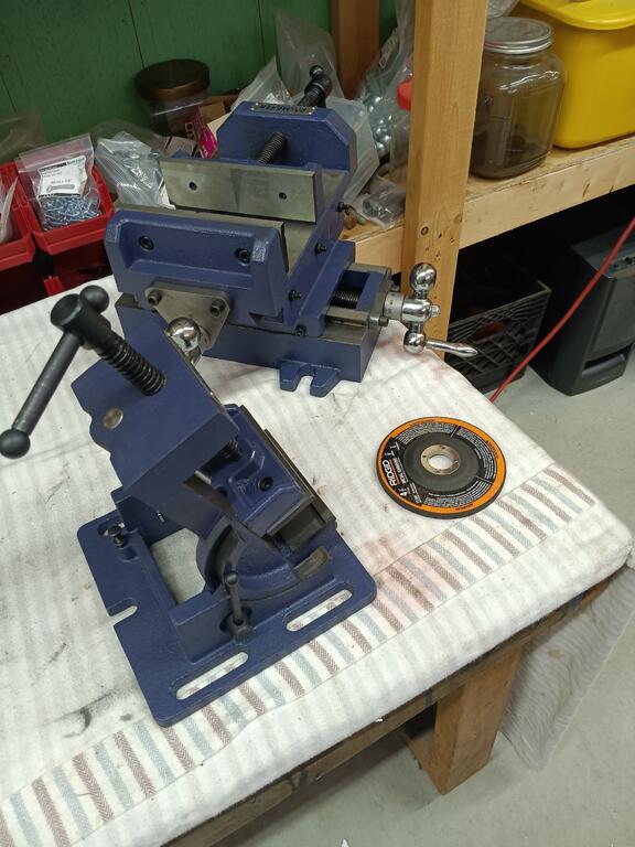

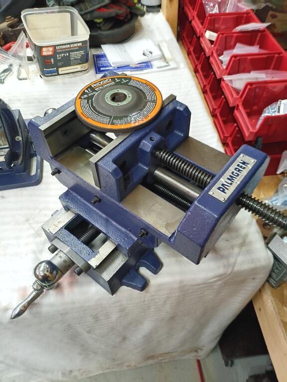

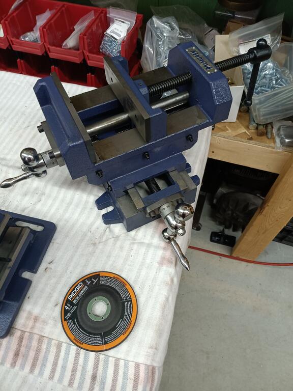

ebinmaine 80,709 #39 Posted January 18 Got these in the post. Grinding disc is for size reference. 3 Share this post Link to post Share on other sites
Wayne0 1,634 #40 Posted January 18 I think they're going to work out for you. 1 Share this post Link to post Share on other sites
ebinmaine 80,709 #41 Posted January 18 1 minute ago, Wayne0 said: I think they're going to work out for you. Yessir. It'll be a bit before I get em set up. Should be very good though. Share this post Link to post Share on other sites
