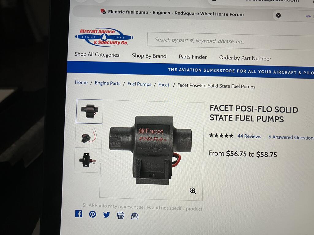

Retired Wrencher 6,989 #4 Posted January 8 (edited) I have installed this brand on my 856. These are designed for aviation but work well on small engines. They make different ones a bit pricey but very well-made. I always say it’s good enough for aviation. It’s good enough for a lawn tractor. Edited January 8 by Retired Wrencher 3 Share this post Link to post Share on other sites

lynnmor 9,040 #8 Posted January 9 13 hours ago, Retired Wrencher said: I have installed this brand on my 856. These are designed for aviation but work well on small engines. They make different ones a bit pricey but very well-made. I always say it’s good enough for aviation. It’s good enough for a lawn tractor. I have posted this before, is there an echo in here? This is a copy and paste from the manufactures website: Not Intended for Aircraft Use WARNING: FACET AND PUROLATOR FUEL PUMPS SHOULD NOT BE USED IN AIRCRAFT AS THEY ARE NOT DESIGNED, TESTED OR MANUFACTURED FOR ANY AIRCRAFT APPLICATIONS. 2 Share this post Link to post Share on other sites

Retired Wrencher 6,989 #14 Posted January 9 10 hours ago, lynnmor said: I have posted this before, is there an echo in here? This is a copy and paste from the manufactures website: Not Intended for Aircraft Use WARNING: FACET AND PUROLATOR FUEL PUMPS SHOULD NOT BE USED IN AIRCRAFT AS THEY ARE NOT DESIGNED, TESTED OR MANUFACTURED FOR ANY AIRCRAFT APPLICATIONS. Ok my bad.But still a great pump. Share this post Link to post Share on other sites
Retired Wrencher 6,989 #15 Posted January 9 10 hours ago, wallfish said: Good thing we aren't flying our tractors! (Although some guys seem to get close every once in a while). Well, John, I guess I didn’t do my research. My bad. Share this post Link to post Share on other sites
lynnmor 9,040 #16 Posted January 9 3 hours ago, Retired Wrencher said: Ok my bad.But still a great pump. Since they are sold by Aircraft Spruce one would think that they are qualified for aircraft use. My thought is that builders of ultralights use the pumps for the small engines they use and there is little regulation on those aircraft. 1 Share this post Link to post Share on other sites
Handy Don 17,474 #17 Posted January 9 4 minutes ago, lynnmor said: Since they are sold by Aircraft Spruce one would think that they are qualified for aircraft use. My thought is that builders of ultralights use the pumps for the small engines they use and there is little regulation on those aircraft. Agree. Also ground equipment--tow tractors, snow clearing, generators, pressure washers... 1 Share this post Link to post Share on other sites
pfrederi 21,150 #18 Posted January 9 I buy the PosiFlo because they seem to last and they are made in Elmira NY USA 2 2 Share this post Link to post Share on other sites
ebinmaine 80,709 #20 Posted January 9 1 hour ago, pfrederi said: I buy the PosiFlo because they seem to last and they are made in Elmira NY USA Same reason for my choice. 2 Share this post Link to post Share on other sites
Retired Wrencher 6,989 #21 Posted January 19 Mark buy a good quality one like this manufacturer. There made in USA. You will not be sorry. 1 Share this post Link to post Share on other sites
