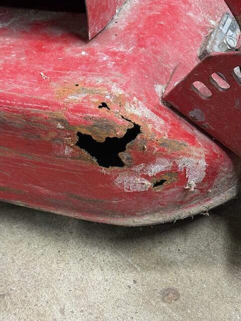

bo dawg 640 #1 Posted January 3 Is there anything on here about repair work on the decks? Like rebuilds, or weld/patch work on the shells? Just curious how others might perform tasks thats needed to keep these old thing still functional. Point at hand..... I need to weld up a hole in the corner of the deck and would like to see how others go about it. Ive done a couple others that were smaller but this one is larger and right in the crown of the corner. Share this post Link to post Share on other sites
ri702bill 12,689 #2 Posted January 3 The damaged area is much larger than it appears on the outside. Once you grind that surface to expose good parent metal to weld to, you will be amazed how much is gone. Folks here have used either metal or fiberglass cloth & resin for that type of repair with acceptable results. Third choice is a replacement shell... 4 Share this post Link to post Share on other sites

ineedanother 2,768 #4 Posted January 3 I went the fiberglass route with one last year. I have a wire welder but molding steel patches was going to be messy at best and the repair I was making was a bit less than what you have. I layered 8 oz. cloth on holes as well as thinned areas and it has held up well so far. 3 3 Share this post Link to post Share on other sites

8ntruck 9,171 #6 Posted January 3 The easiest repair method in that location is fiberglass as @ineedanother describes. But, if you have sandy soil like I do, a fiberglass patch is probably a temporary patch, due to the sand blasting action while the mower runs. Being a retired press & die engineer, I'd get out a ball peen hammer and a log with a shallow depression in the end and try to beat out a reasonable facsimile patch panel. Might be easier to match the contour with a 2 or 3 piece patch. I've got some patch work to do on my decks, so that was more of a pep talk to myself..... 4 2 Share this post Link to post Share on other sites

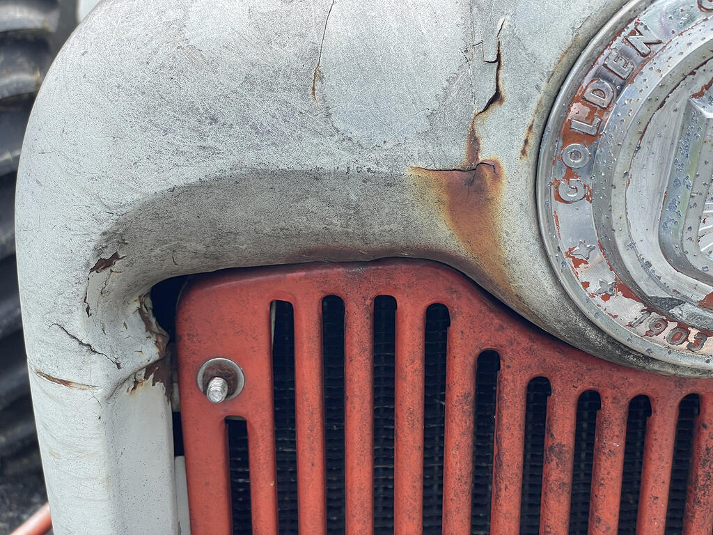

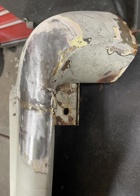

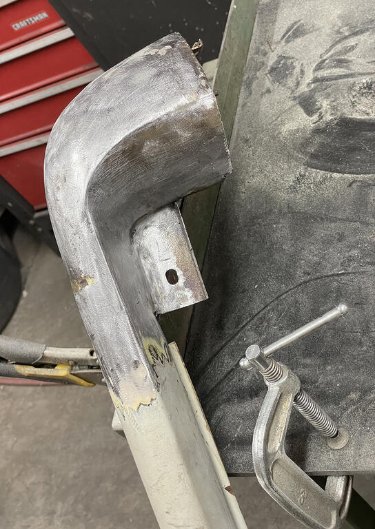

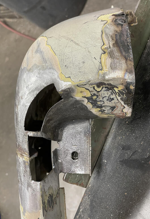

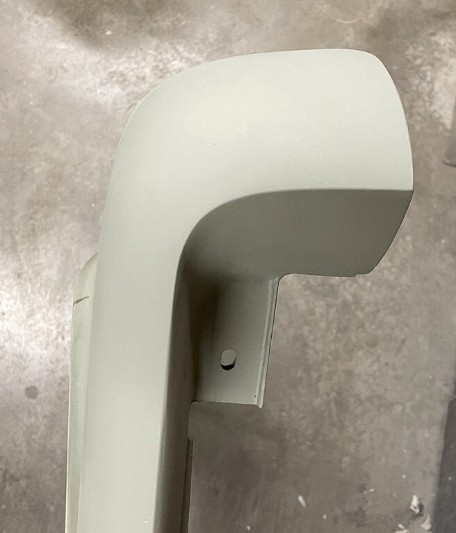

Blue Chips 822 #7 Posted January 3 (edited) If you have enough solid metal under and around the height-adjustment bracket, then I think you could get by with fiberglass and resin. If the height-adjustment bracket has lost much of its support, then if it were me I'd opt for welding. IF it's just a matter of expediency and looks don't matter, then a welded repair should be pretty easy. If appearances are important, it will take a bit of work to do a nice-looking welded repair, which would involve cutting back the rust until you hit good solid metal, and then cutting and shaping the insert(s) to match the opening and the original contours. Some extra strips of metal could be welded across the seams underneath the deck if extra strength is needed. Shaping mild steel sheet isn't terribly difficult for small pieces. If you don't have fancy equipment like a metal stretcher/shrinker, English wheel, bending brake, body hammers, dollies, etc., you can get by with a vise, a leather bag full of steel shot to pound against (or just some soft wood with a depression in it, like @8ntruck suggested) and a couple of sizes of peening hammers. Here are some photos of one of my more recent sheet metal repairs. It's not a mowing deck, but the approach is basically the same. BTW, I'm NOT a professional body man, but I like doing some sheet metal work from time to time. Before (bad welds and repairs by previous owners, rusted and cracked metal): Disassembled and chipped off enough old paint and body putty to assess how extensive the damage was, which revealed several cracks, rust, and bad brazing work: Straightened out a few spots, cut the cracked metal and rust spots back to solid metal, and started welding a few places. Not all of the repair areas are shown in these photos. New metal shaped, welded in, and rough ground: After a few small dabs of Bondo, sanding, and priming: The result after painting and reassembly (plus a new badge): If you haven't done sheet metal restoration before, fixing the deck could be a fun little project. Edited January 3 by Blue Chips 4 2 Share this post Link to post Share on other sites

Lee1977 7,744 #9 Posted January 3 I welded several pieces of 1/8" to the inside it's rough. Then fill in the out side with JB weld, it's held up for at least 20 years and still holding. . 3 Share this post Link to post Share on other sites

bo dawg 640 #13 Posted January 4 I do appreciate all the help and info, I think I will go with welding narrow strips of 1/8' metal running horizontally be easier to control the corner and making shorter and shorter strips to round over the top. (if that makes sense) Starting at the bottom and working up. Or as I was typing this.... I got a thought of going vertical with 1" strips bending over the top of deck butting them up. Am I thinking right about it or is that too much ? Share this post Link to post Share on other sites
