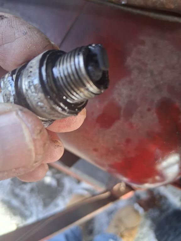

1973Auto 84 #1 Posted January 2 Hello all and happy new year! Thism may be a little long , so please bear with me. I csn not get the RPM's up on My 12hp k301. When it's in idle or out of gear , the rpm's go up , but as soon as I put it in gear or get a load on it , they go down to about halfway. I've turned all the screws on the carburetor can't get the RPM 's up. So my question is , before I start twisting tearing and swearing , could it be the carburetor the fuel pump or the rings. It does burn oil about 4-5 or ounces every hour or so when i'm plowing. The plug pic is after 1-2 hours of plowing. It still plows ok but no speed. The ring job is not happening this winter, so a rebuild carb and fuel pump is my option. Need advice on what direction or if there us something else. Thanks all!!! Share this post Link to post Share on other sites

sqrlgtr 3,702 #9 Posted January 2 Have you replaced plug and seen how it runs after. I have fouled plugs before and sometimes they would just never run right again and the next one you could clean and was good to go. Just sumin easy to try before you get to deep. 2 Share this post Link to post Share on other sites

oliver2-44 11,694 #11 Posted January 2 1 hour ago, sqrlgtr said: Have you replaced plug and seen how it runs after. I have fouled plugs before and sometimes they would just never run right again and the next one you could clean and was good to go. Just sumin easy to try before you get to deep. Definitely start with a clean plug before any other adjustments. I have a Case 180 with a very worn engine. I just take it to shows and it runs amazingly well for about 2 hours. Then won’t even start. Clean plug and it off and running. I have a little Harbor Fright plug blaster that helps keep several clean one available. 4 Share this post Link to post Share on other sites

kpinnc 18,884 #13 Posted January 2 7 hours ago, 1973Auto said: The plug pic is after 1-2 hours of plowing. There are several good options mentioned here, and hopefully one of them gets you through winter. That being said, it would be a good idea to do a leak down test. Compression checkers won't work due to your engine having internal compression release. Just from how that plug looks, you may have some blowby that is robbing torque. Might need a rebuild, but could also be leaky valves. 1 1 Share this post Link to post Share on other sites
Ed Kennell 46,982 #14 Posted January 2 Cleaning the breather may help the oil consumption. 1 1 Share this post Link to post Share on other sites

1973Auto 84 #16 Posted January 2 6 hours ago, sqrlgtr said: Have you replaced plug and seen how it runs after. I have fouled plugs before and sometimes they would just never run right again and the next one you could clean and was good to go. Just sumin easy to try before you get to deep. Plug is new, clean it before each use. Have 4 more new ones on deck 1 Share this post Link to post Share on other sites
1973Auto 84 #17 Posted January 2 (edited) 2 hours ago, Ed Kennell said: Cleaning the breather may help the oil consumption. Where is the breather located. You referring to the gas cap breather? Edited January 2 by 1973Auto Share this post Link to post Share on other sites
Ed Kennell 46,982 #18 Posted January 2 Just now, 1973Auto said: Where is the breather located. You referring to the gas cap breather? There is a vent hole in the gas cap that can become blocked creating a vacuum in the fuel tank that results in poor fuel delivery to the fuel pump. The crankcase breather is on the front of the engine just below the carb. If it becomes blocked it may create a pressure in the crankcase that may force oil into the combustion chamber resulting in burning oil and fouling spark plugs. Please download the manual for your tractor. The breather must be assembled exactly like the drawing to work properly. 3 2 Share this post Link to post Share on other sites
