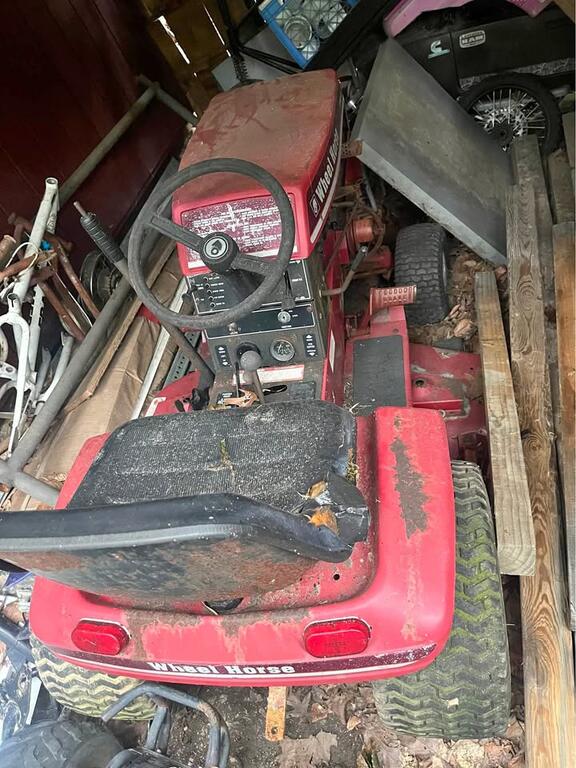

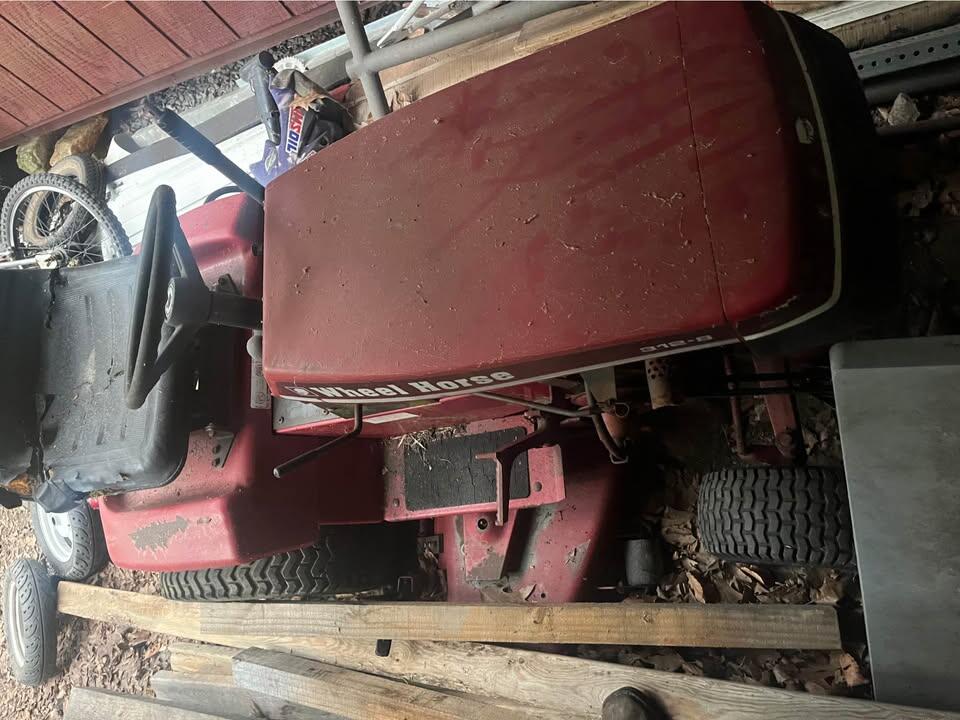

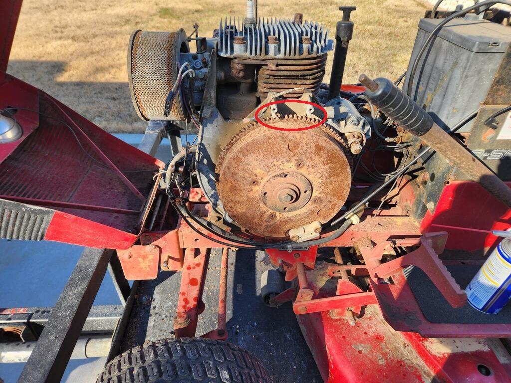

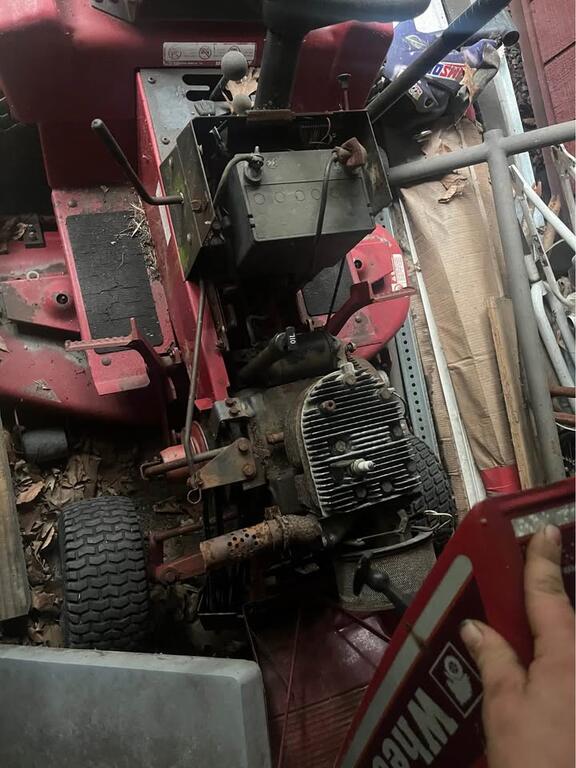

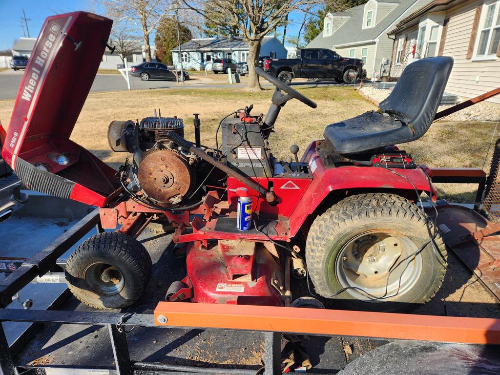

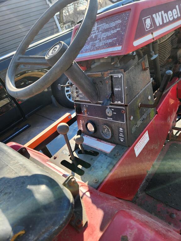

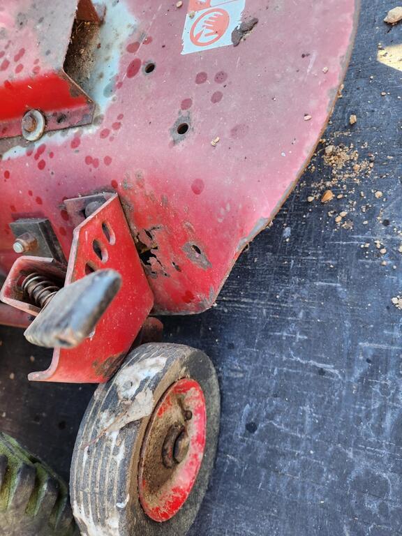

Scored a 1992 Wheel Horse 312-8 today with deck & front blade for 100 bucks. I got homework to do. Engine has no spark plug wire or left side engine cover. Engine does turn over by hand & seems to have compression. Can't get the PTO to engage, the shaft isn't sliding in. Choke cable stuck, throttle cable operates. Deck has minor rot on the right side, but I bought the tractor for snow plowing, I will sell the deck. I had 60s & 70s Cub Cadets & John Deere tractors. I know decks & mule drives were pricey in 2019 when I sold all my garden tractors & bought a new Cub cadet XT1 LT42 with rear bagger, brush guard & arm rests. I missed a garden tractor to plow with. A walk behind snowblower just don't get it done. Snowblower for her is in the future too. Maybe even a sleeve hitch and tiller.

All of the missing engine tins can be found. Any Magnum 10-16hp are the same. The flywheel cover is plastic and the same applies for it.
If turning that flywheel proves she has compression, she WILL run.
A 312 is a great machine. You can definitely use it for what you're planning. A little love goes a long way on these old tractors.
You also already have the rear axle hitch for tillers, snow blades and even grader blades. Well done! :thumbs:

Thank you kpinnc! The PTO issue is repaired for now. I found out the engine needs to be running @ idle to engage the PTO. I served 1970-1990/ Field Artillery- 105 towed, Armor & Cavalry-M551 Sheridan, M48A5,M60A1 &M60A3, I was also a Combat Engineer. Yeah, I loved blowin' things up. Welcome home brother.

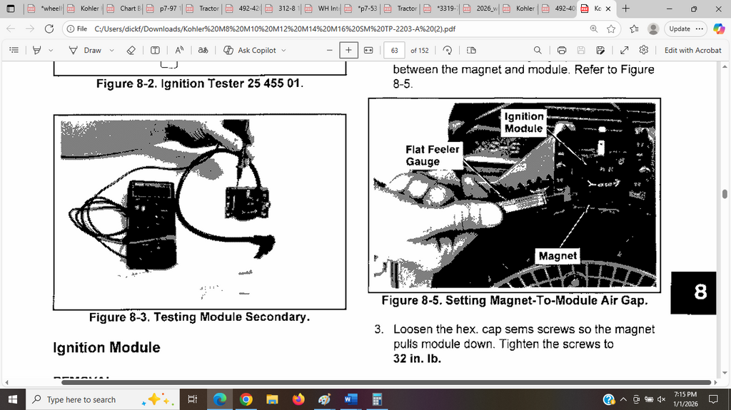

The ignition module is missing from your engine, it should be where I have circled your photo.
The attached manual should be helpful.         PS: ditch the WD-40 and get some KROil or PB Blaster.

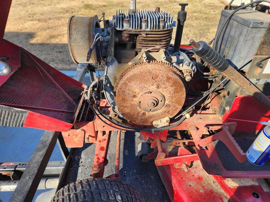

Can someone please tell me about that flywheel? I’ve never seen one with no cooling fins before?
pfrederi
Magnums has bolt on plastic fins
  • Like 2
c-series don
And that explains why I have never seen one before! I have never owned a single cylinder newer than a K-series. Thank you for the info!
