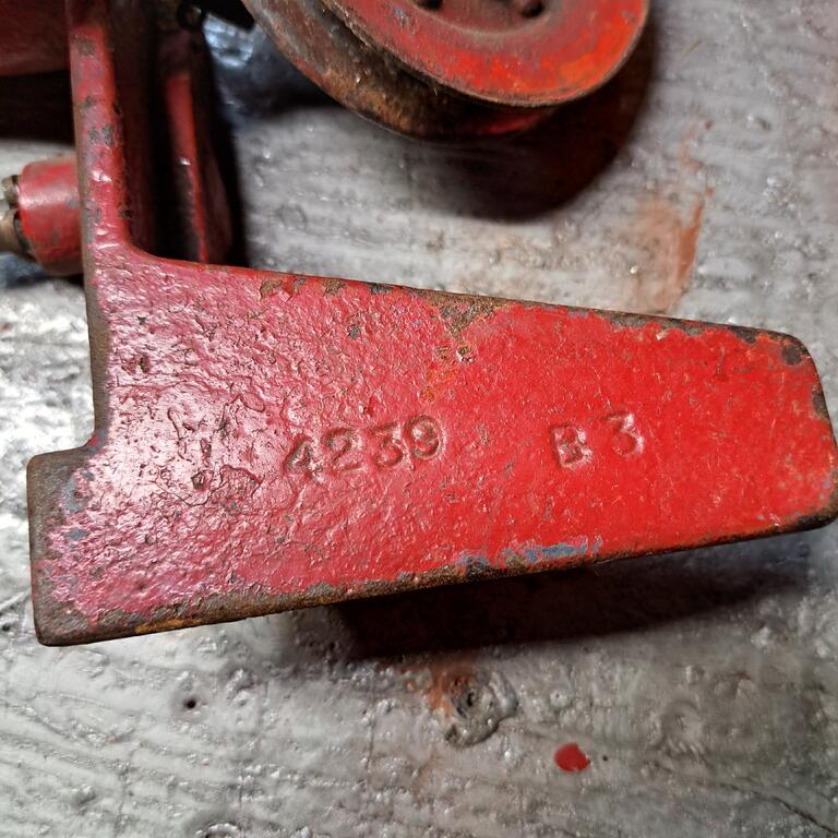

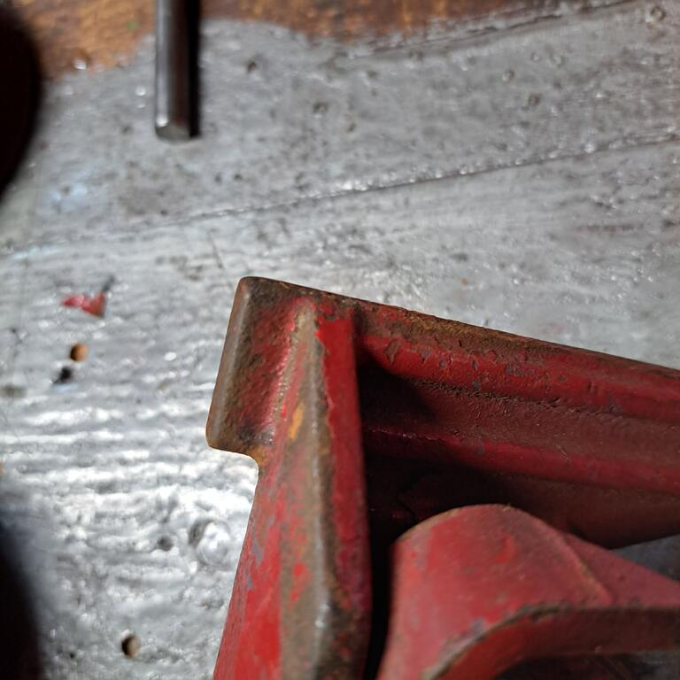

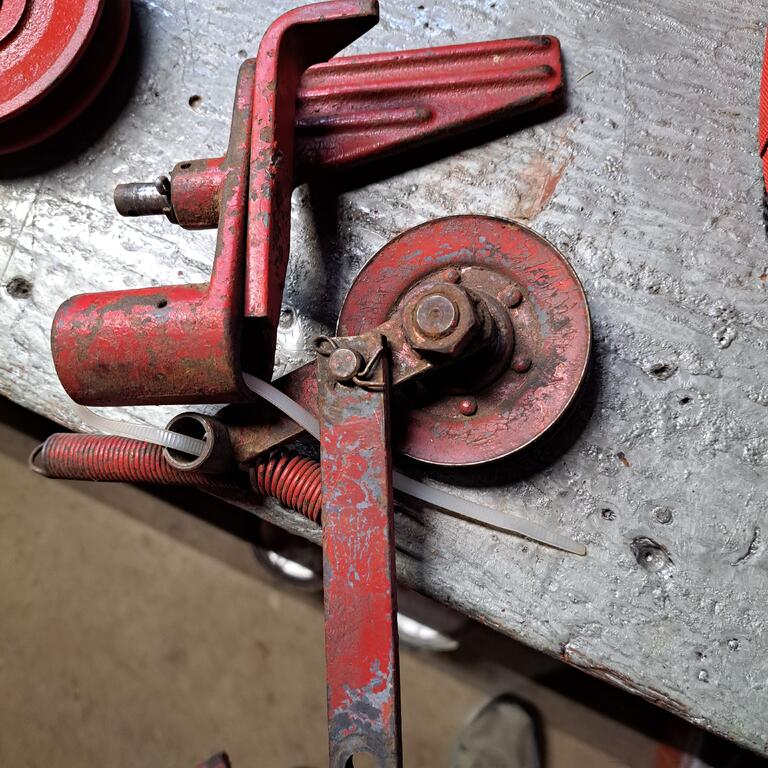

Achto 32,243 #29 Posted January 8 (edited) 12 hours ago, 855project said: That might get eliminated or changed some 49 minutes ago, WHX?? said: @Achto restores them and puts them back on. Like Jim said I like to put them back on if for nothing else so is they don't get lost. They do not interfere with operation or for loading to go to a show. A few pic's to help explain where it goes. Basically the same set up on the square hoods like yours. Edited January 8 by Achto 2 2 Share this post Link to post Share on other sites

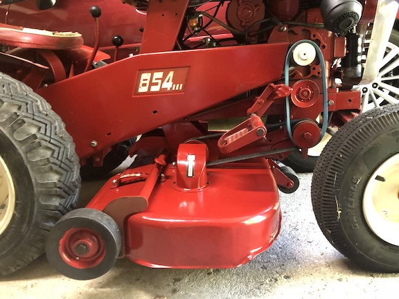

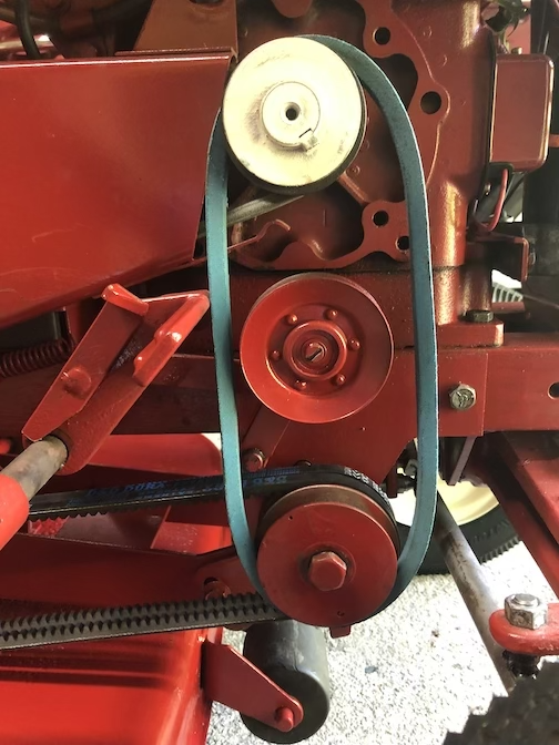

Handy Don 17,167 #30 Posted January 8 (edited) 14 hours ago, 855project said: Ah now it makes sense! Thanks guys, I had suspicions of that but never had a deck with the mower. That might get eliminated or changed some, I don't think I'll have a PTO attachment on this tractor. A couple of images augmenting @kpinnc’s response... The pedal with its spring puts tension on the belt to engage the implement; the lock latch holds it disengaged. I have only the mower deck but I believe it also handled others--tiller, sickle bar, etc. Similar to the drive belt, the PTO belt needs a close-aligned guide to slow/stop the belt when it is disengaged. I hadn’t learned that yet when these pictures were taken! Edited January 8 by Handy Don 1 Share this post Link to post Share on other sites
