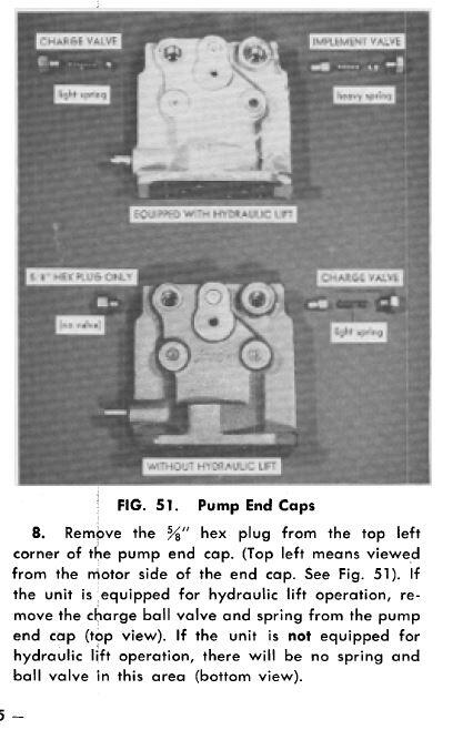

pfrederi 20,047 #3 Posted December 29, 2025 Welcome. You have a Sunstrand Hydro gear system. If you want to eliminate the hydraulic lift You need to make some changes to relief valves. You will remove the implement lift check valve and move the charge pump relief valve over to that position and plug that port. Do not just plug ports. Look a page 35/6 in the manual provided above. I am not sure if you loop idea will cause an issue or not. 1 Share this post Link to post Share on other sites
