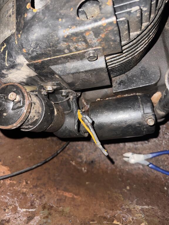

Bill D 3,166 #26 Posted December 28, 2025 10 minutes ago, Krice58 said: I don’t see a regulator on the parts tractor? Would it be unregulated? Likely unregulated 3 amp charging system with separate A/C line for the lights. You may want to swap the charging stator. Share this post Link to post Share on other sites
Krice58 181 #27 Posted December 28, 2025 Two wires coming out of the shroud Share this post Link to post Share on other sites

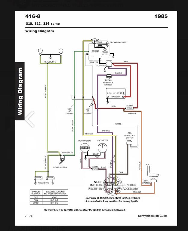

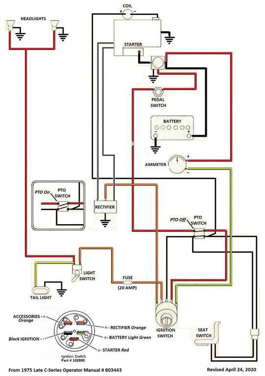

Krice58 181 #28 Posted December 28, 2025 Comparing the two wiring diagrams I’m trying to figure out what would need to be changed. Ignition switch is the same, coil is the same, solenoid is different not sure if that matters, original K341 harness has rectifier K301 does not. Don’t really care about original lights, I have leds wired to a switch. Share this post Link to post Share on other sites
pfrederi 21,215 #29 Posted December 29, 2025 If you are using LED lights. the 3 amp unregulated system should work for you (unless you have a lot of lights and use them all the time) Share this post Link to post Share on other sites
Krice58 181 #30 Posted December 29, 2025 58 minutes ago, pfrederi said: If you are using LED lights. the 3 amp unregulated system should work for you (unless you have a lot of lights and use them all the time) Could I convert it to a 15 amp system? Just swap stator and add a rectifier? Share this post Link to post Share on other sites
Handy Don 17,546 #31 Posted December 29, 2025 14 hours ago, Krice58 said: I have leds wired to a switch. 53 minutes ago, pfrederi said: If you are using LED lights. the 3 amp unregulated system should work for you (unless you have a lot of lights and use them all the time) Note that the lighting circuit shown in the first schematic is un-rectified. Incandescent lights work continuously on AC but LEDs connected to AC will flicker! As @pfrederi notes, unless you’re planning a Disney Light Parade, capacity on the 3 amp DC battery-charging circuit in the second schematic will be plenty. 1 Share this post Link to post Share on other sites
