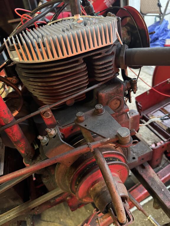

Krice58 176 #1 Posted December 26, 2025 ‘75 C160 Auto 71128a spec K341. Throttle cable opens the throttle fine, but does not return to low idle on its own. I’ll include a video below. Am I missing something? Cable just worn out? Governor settings wrong? It’s been like this for as long as I can remember and I’m trying to fix it. Carb has been changed to one of the copies from IST a few years ago. Cable is original. IMG_9186.mov Share this post Link to post Share on other sites

Bar Nuthin 3,040 #5 Posted December 26, 2025 @Krice58 It looks like you need to loosen the cable where it attaches to the bell crank and give a 1/4" more of relief. 2 Share this post Link to post Share on other sites
gwest_ca-(File Mod) 12,451 #6 Posted December 26, 2025 Suspect there is no casing support near the end of the cable. When you pull on the core the casing can't move because the coils are wound tight. When you push on the core the casing stretches like a spring losing the corer's effectiveness. 1 Share this post Link to post Share on other sites

Ed Kennell 46,982 #8 Posted December 26, 2025 I don't see where the throttle cable sheath is fastened. It needs to be clamped near the end. 1 Share this post Link to post Share on other sites
Krice58 176 #9 Posted December 26, 2025 1 hour ago, gwest_ca said: Suspect there is no casing support near the end of the cable. When you pull on the core the casing can't move because the coils are wound tight. When you push on the core the casing stretches like a spring losing the corer's effectiveness. Toward the end of the cable the casing is definitely pretty nasty looking. 1 Share this post Link to post Share on other sites
Krice58 176 #10 Posted December 26, 2025 2 hours ago, Bar Nuthin said: @Krice58 It looks like you need to loosen the cable where it attaches to the bell crank and give a 1/4" more of relief. So more slack on the cable? Or pull it tighter? Share this post Link to post Share on other sites
Krice58 176 #11 Posted December 26, 2025 33 minutes ago, Ed Kennell said: I don't see where the throttle cable sheath is fastened. It needs to be clamped near the end. It’s hard to see but it is clamped to the valve cover under the fuel bowl. 1 Share this post Link to post Share on other sites

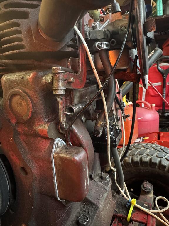

sqrlgtr 3,701 #12 Posted December 27, 2025 Hope this might help. Here is a pic of my c160 throttle cable, and governor set up, works great. 2 Share this post Link to post Share on other sites
Bar Nuthin 3,040 #13 Posted December 27, 2025 1 hour ago, Krice58 said: So more slack on the cable? Or pull it tighter? More slack Share this post Link to post Share on other sites

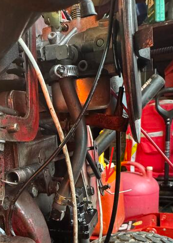

sqrlgtr 3,701 #14 Posted December 27, 2025 The one pic looks like the throttle cable may be rubbing governor arm, might be holding it not letting it idle down? 2 Share this post Link to post Share on other sites

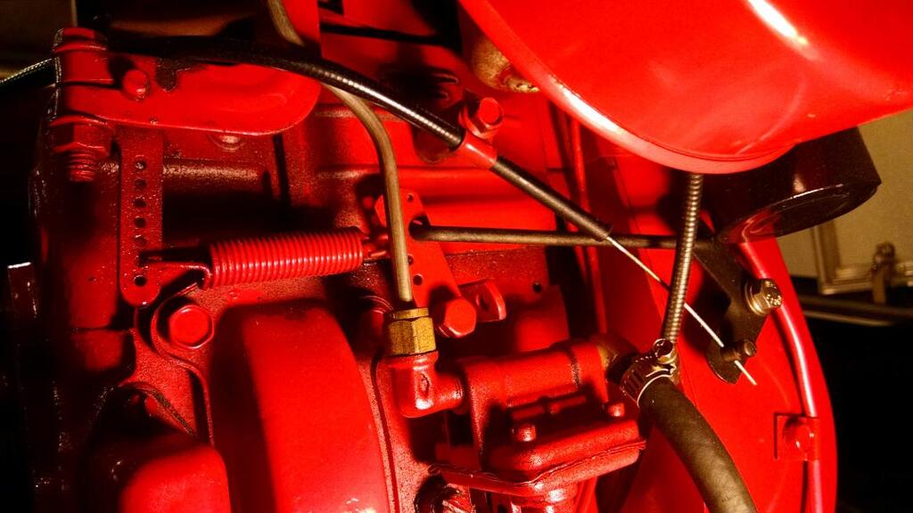

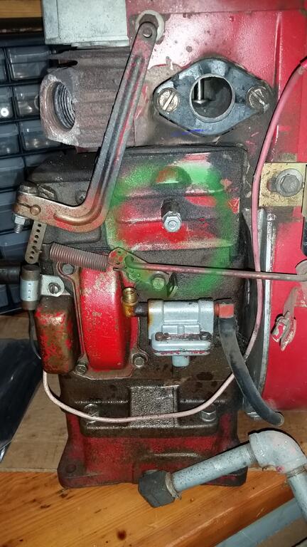

WHX?? 57,797 #19 Posted December 27, 2025 (edited) There is supposed to be a cable clamp on the nut that holds the breather cover on. A 1/4-20 coupling nut on the breather stud with a machine screw holding the clamp on works well and spaces the cable out a bit. Got a pic of it in here ... somewhere ... Here it is on @Achto 's 1076 Never mind looks like you have it but check the bell cranks for binding. Maybe try resetting the governor. That should be done once in awhile anyway. Edited December 27, 2025 by WHX?? 2 Share this post Link to post Share on other sites

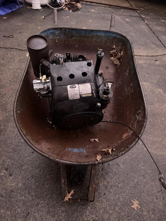

Krice58 176 #23 Posted December 28, 2025 Pulled this sucker out of a 312-8 parts tractor I had. 47812 spec number K301. Tag on the 312 was gone I’m guessing this is mid 80s. Mounting seemed identical to K341, base plate is the same. Should just plug and play correct? Could I use the existing electrical things on my C160? Starter Solenoid? Key switch? It’s old school points like the K341. 1 Share this post Link to post Share on other sites
ebinmaine 80,278 #24 Posted December 28, 2025 Points ignition to Points ignition you should be fine there. What's the wiring connection coming outta the alternator? Same? 1 Share this post Link to post Share on other sites
Krice58 176 #25 Posted December 28, 2025 15 minutes ago, ebinmaine said: Points ignition to Points ignition you should be fine there. What's the wiring connection coming outta the alternator? Same? I don’t see a regulator on the parts tractor? Would it be unregulated? 1 Share this post Link to post Share on other sites
