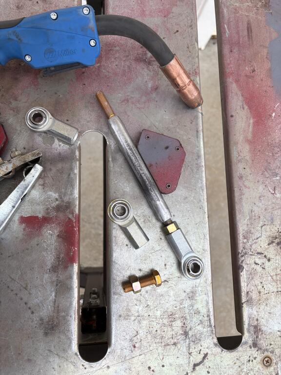

RoubaixRider 284 #28 Posted December 30, 2025 Fabricated some Heim joints for my steering upgrade. Always a good day when you get to spark up the welder. Will be nice to have some adjustability. 1 7 Share this post Link to post Share on other sites

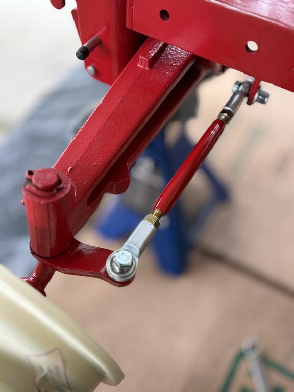

peter lena 10,065 #29 Posted December 31, 2025 @RoubaixRider , happy new year ! been experimenting with heim joints for years , extremely durable , like SUPER LUBE hydraulic oil in them , extreme temp range and rating , love it on the pto lever rod end , replacing the sloppy trundle , the ability to ANGULATE SMOOTH MOTION , for any lever end point , eliminates a lot of sloppy issues . use a DIE NUT 3/8 x 24 right over the original 3/8 x 16 threading , lubricate , heim screws right on , like this , that area is a GOLD MINE for improvement , glad to share it with you , questions ? ask away , pete Share this post Link to post Share on other sites

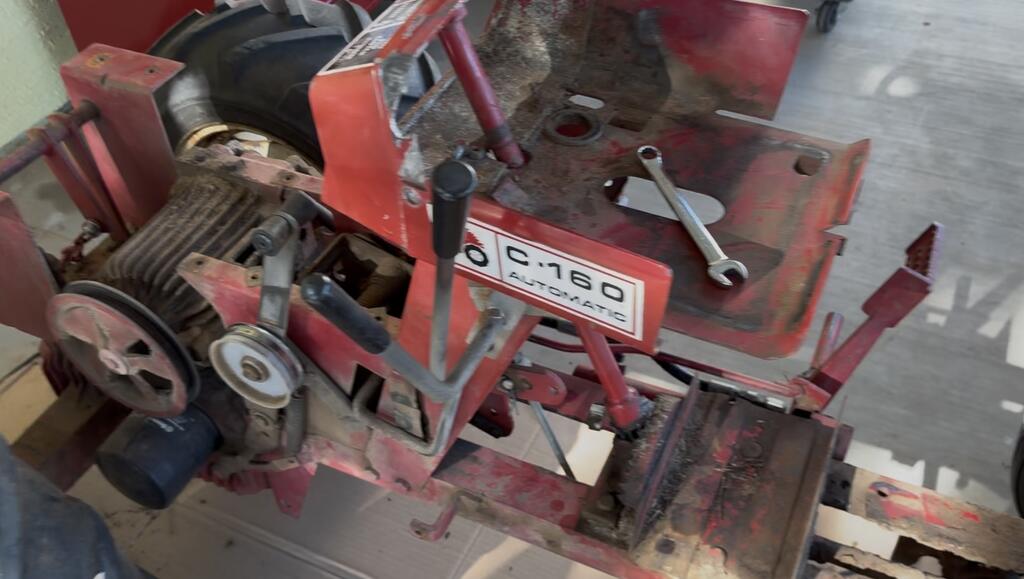

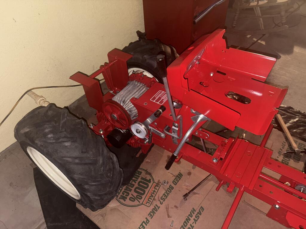

peter lena 10,065 #31 Posted December 31, 2025 @RoubaixRider notice 2nd photo down , the pto outer swing arm , connection slide pin ? there is a light extension spring just visible on the right outside ? have that attached to the frame mount hitch pin clip , rounded end , that tension , eliminates all the buzzing , bouncing , with that set up . always looking for some improvement , love REPEDITIVE ISSUES , ? take them apart and improve as you go , more often than not , its been a pretty simple mod . also like a black vinyl cap on my axel spindle top , initial snug fit is just right . also have heim joint on my clutch linkage , many years no failures . good talkin , pete Share this post Link to post Share on other sites

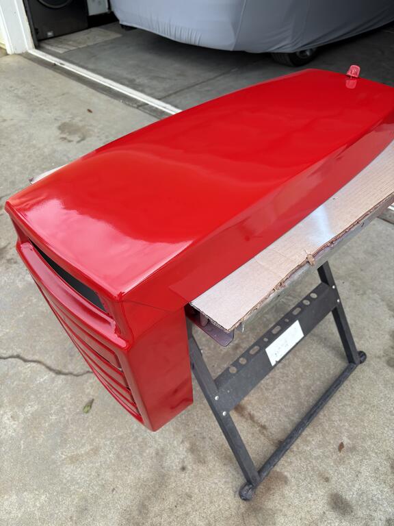

RoubaixRider 284 #35 Posted January 3 Finally got the center console base and hood shot with paint after a lot of sanding some very minor Bondo prep and several sanded coats of primer. normally, I enjoy painting, but this project has been a little more frustrating, but it’s going slowly. Patience. 4 Share this post Link to post Share on other sites
sqrlgtr 3,930 #36 Posted January 3 @RoubaixRider Looks great. Are you still using the Rustoleum Sunrise Red ? Share this post Link to post Share on other sites
AlexR 3,112 #37 Posted January 3 Very nice job on that hood!!! 1 Share this post Link to post Share on other sites
RoubaixRider 284 #38 Posted January 3 1 hour ago, sqrlgtr said: @RoubaixRider Looks great. Are you still using the Rustoleum Sunrise Red ? Yes sir. It’s been a tricky paint to use… Either runs or orange peel… Obviously that is application error. Unfortunately I don’t have my good paint gun with me in the shop at the moment so it’s rattle can action. 1 1 Share this post Link to post Share on other sites
sqrlgtr 3,930 #39 Posted January 3 14 minutes ago, RoubaixRider said: Yes sir. It’s been a tricky paint to use… Either runs or orange peel… Obviously that is application error. Unfortunately I don’t have my good paint gun with me in the shop at the moment so it’s rattle can action. My experience, If I try and go back over it with another coat it will orange peel on me. I have got in the habit of barely covering with first coat (can still see primer/old paint) just barely wet and then quick as I can throw the paint to it or try and cover with first coat and quit after that. If I try and do 2 or 3 coats it will orange peel every time. If i want to go back over it after that may as well figure on a month of cure time before starting to paint again Of course everybody has there on procedure and this might not work for everyone. This is when using rattle cans. If you're for a spray gun you will have more control over cure times and such. Share this post Link to post Share on other sites

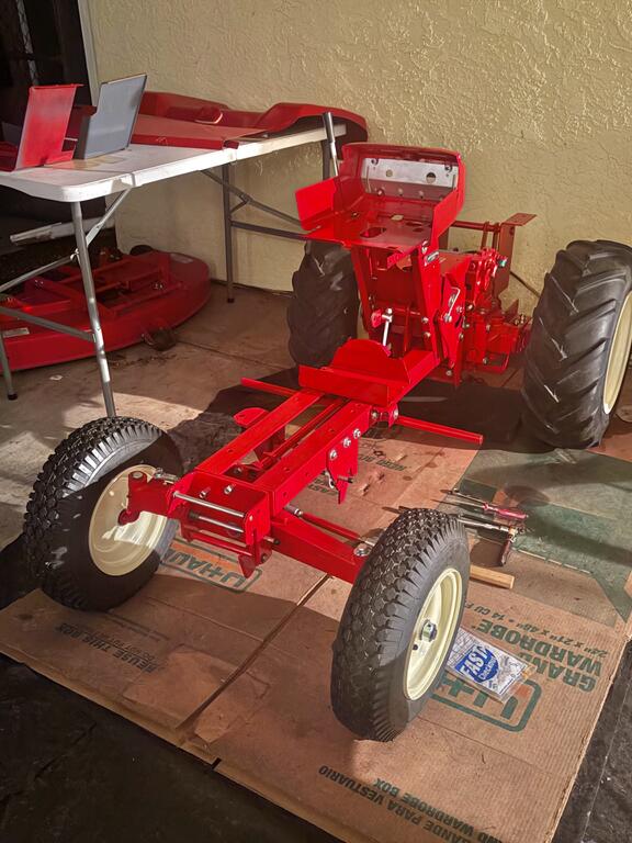

RoubaixRider 284 #44 Posted January 7 (edited) Ran out of daylight, but the reassembly fun continues… right now a lot of it is just dry fitting all the parts and making sure all the holes and everything lineup nice and putting things back in the proper order. Was really happy with the way the aluminum dash console cleaned up on the inside… It was quite a mess with corrosion! I was not able to get the pin out of the steering wheel… No matter what I tried… Even a hydraulic press. So I decided to just sever the steering shaft and it will get reinserted and spot welded. Fortunately, I’ve got lots of leather and fireproof blankets to throw over the machine when I weld the steering shaft back together. should make for an interesting video lol. Edited January 7 by RoubaixRider 2 3 Share this post Link to post Share on other sites
SylvanLakeWH 32,501 #45 Posted January 7 11 minutes ago, RoubaixRider said: steering shaft and it will get reinserted and spot welded. Fortunately, I’ve got lots of leather and fireproof blankets to throw over the machine when I weld the steering shaft back together Could just use a shaft collar. That way you can easily take it back apart if need arises... 2 Share this post Link to post Share on other sites
RoubaixRider 284 #46 Posted January 7 55 minutes ago, SylvanLakeWH said: Could just use a shaft collar. That way you can easily take it back apart if need arises... Very good idea. I picked one up the other day that will do the trick…much easier than re-welding it surrounded by freshly painted parts, even with all my protective blankets.🤓 1 1 Share this post Link to post Share on other sites
