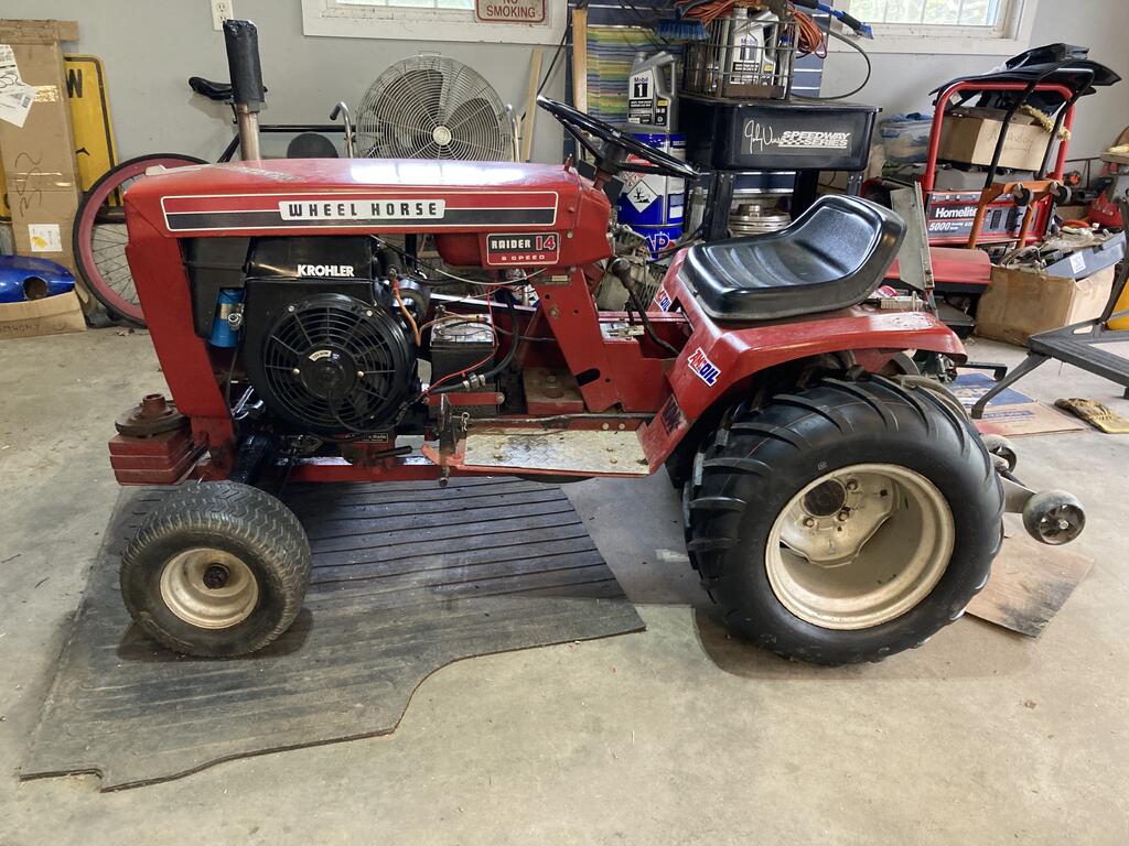

TonyToro Jr. 2,539 #12 Posted December 16, 2025 11 hours ago, ebinmaine said: @TonyToro Anything to add? Looks like I got here before him For ag tires there really isn’t many you can get for 24/12/12. But the new thing for tires all over pulling clubs are called Cheng Shin. They are cheap and man these tires have been great. We’ve been using them I think 3 seasons now. And the good part is they don’t take as much power as say the firestones do. https://www.millertire.com/23x10-50-12-cheng-shin-tractor-lug-4-ply-tire/ 4 1 Share this post Link to post Share on other sites

sqrlgtr 3,932 #14 Posted December 16, 2025 I would be all over them cheng shin if they came in 24's. Looks like the Land Trac's for the money and availability in 24's are going to be hard to beat. Hope someone comes along and elaborates more on the "Jeep" spring upgrade. @TonyToro Jr. is that a 14HP Magnum Kohler with an electric fan? Nice 1 Share this post Link to post Share on other sites

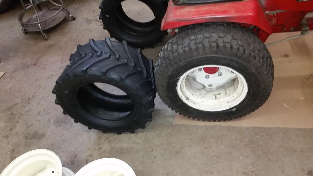

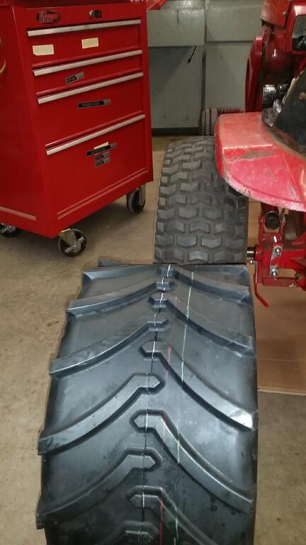

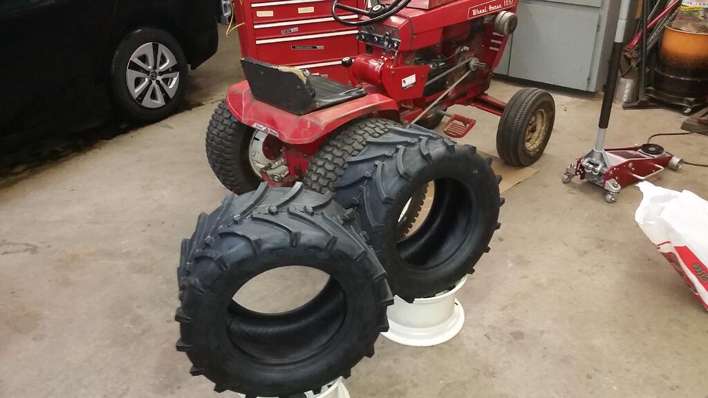

WHX?? 58,134 #19 Posted December 16, 2025 (edited) Land trac ... lawn trac... high run ... all the same tread design. Problem is ain't a one gonna be the same size. When I ordered those on your 1257 I had no idea how wide they were. Or how they would inflate on a rim. Strait sidewall, bulged, flat tread... you just don't know. If I remember right those were 80 a tire and when they showed up I go holy crap. Hard to believe same size. Well the stocks may only be 23-8.5s ...ags 10.5 but still. Edited December 16, 2025 by WHX?? 3 1 Share this post Link to post Share on other sites
SylvanLakeWH 32,517 #20 Posted December 16, 2025 Both Carlisle, both 10.5, one USA one China... you get the picture... 1 Share this post Link to post Share on other sites
sqrlgtr 3,932 #21 Posted December 16, 2025 Which one is USA . I told everyone that the metric system was a conspiracy. 1 Share this post Link to post Share on other sites

TonyToro Jr. 2,539 #23 Posted December 16, 2025 8 hours ago, sqrlgtr said: I would be all over them cheng shin if they came in 24's. Looks like the Land Trac's for the money and availability in 24's are going to be hard to beat. Hope someone comes along and elaborates more on the "Jeep" spring upgrade. @TonyToro Jr. is that a 14HP Magnum Kohler with an electric fan? Nice Well yes kinda.. So running the engine on the Dino and trying stuff we found the magnum air filter gave the most power. But in my class I need to run stock air filter assembly. And magnum air filter to a k series block does match up. So we had to switch everything from a magnum to a k series. And the electric fan is so I don’t overheat since there is no cooling fans on the engine for more power. 1 1 Share this post Link to post Share on other sites

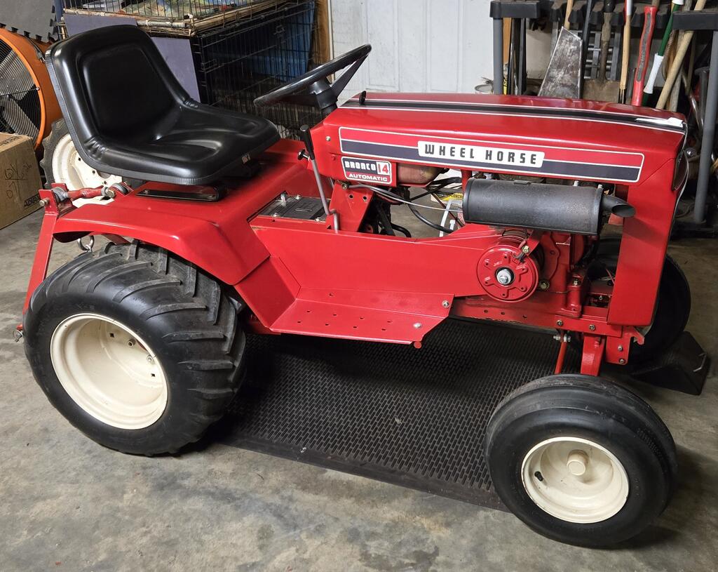

kpinnc 18,965 #24 Posted December 17, 2025 15 hours ago, TonyToro Jr. said: But the new thing for tires all over pulling clubs are called Cheng Shin. They are cheap and man these tires have been great. I have these on my Bronco. Been on there for over 15 years and they have held up very well. 23x10.50-12. 2 Share this post Link to post Share on other sites
