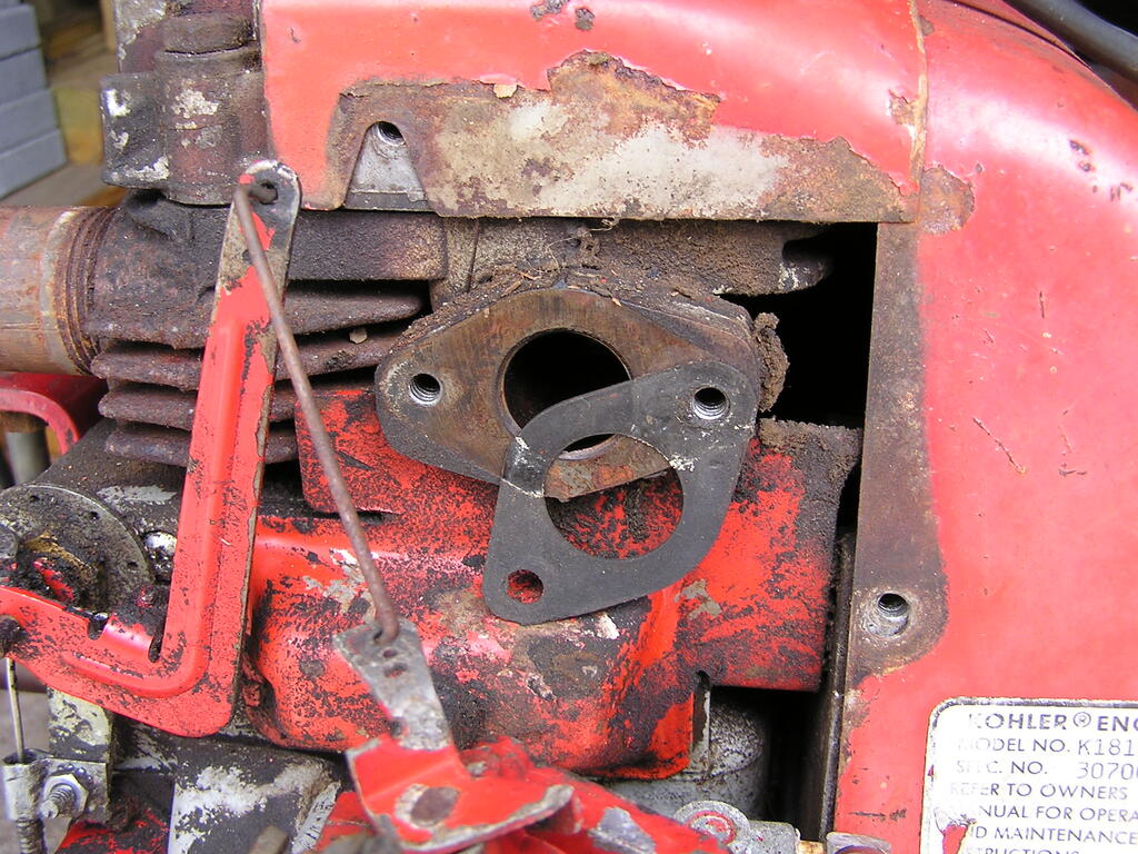

ri702bill 13,392 #6 Posted December 15, 2025 Check to see that your carb to engine gasket is good and sealing all around. Not like this!! On a C81 I bought - that ran!! 1 Share this post Link to post Share on other sites
1988_wheelhorse312 112 #7 Posted December 15, 2025 Hmm ill have to reinspect that Share this post Link to post Share on other sites
