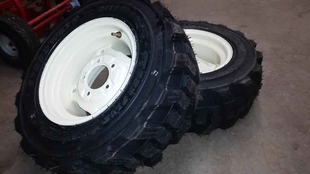

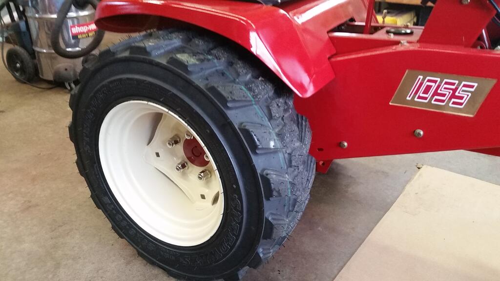

lynnmor 9,040 #2 Posted December 12, 2025 Here ya go: 1 5 6 Share this post Link to post Share on other sites
ri702bill 13,067 #3 Posted December 12, 2025 Ya beat me to it! 1 1 2 Share this post Link to post Share on other sites

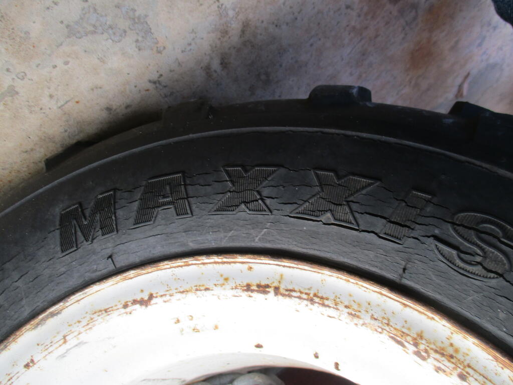

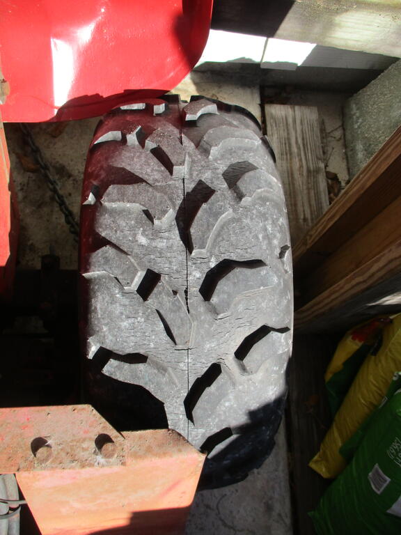

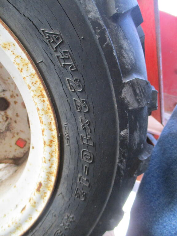

Kenneth R Cluley 704 #9 Posted December 12, 2025 I have 10 acres just south or Bushnell FL, I use my Charger 12 for anything and everything on this property. Hauling dirt, rock, firewood etc, plowing driveway and spreading limestone. It has greenbriar like I have never seen before. Think "Jack and the Beanstalk". One inch thick and better stalks. Raspberry stalks, grapevine, sand spurs and every other manner of pointy vegetation known to man. I am using a Maxxis AT22x10-12. Even wound barbed wire around axle a few times running fence lines. Never flatted. They are tubeless. Work well in sandy leaf littered terrain. The AT tires have a wider flotation type profile and work well in this soft sandy environment. Look at Craigslist in your area, and Ocala, Always see ATV tires listed that will work.; 5 Share this post Link to post Share on other sites

FLtractor 223 #11 Posted December 12, 2025 (edited) 37 minutes ago, Kenneth R Cluley said: I have 10 acres just south or Bushnell FL, I use my Charger 12 for anything and everything on this property. Hauling dirt, rock, firewood etc, plowing driveway and spreading limestone. It has greenbriar like I have never seen before. Think "Jack and the Beanstalk". One inch thick and better stalks. Raspberry stalks, grapevine, sand spurs and every other manner of pointy vegetation known to man. I am using a Maxxis AT22x10-12. Even wound barbed wire around axle a few times running fence lines. Never flatted. They are tubeless. Work well in sandy leaf littered terrain. The AT tires have a wider flotation type profile and work well in this soft sandy environment. Look at Craigslist in your area, and Ocala, Always see ATV tires listed that will work.; Thank you for the pictures and info… I will keep checking marketplace… I might be making a roadtrip back to Florida from Michigan in near future.. so looking at tires on marketplace on way back as well to see if i find anything and hopefully have room. Since there a LOT more Wheelhorse and tractor in general.. parts and tires up north then down here in Florida. Edited December 12, 2025 by FLtractor Share this post Link to post Share on other sites
