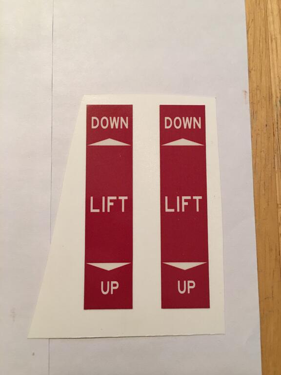

sqrlgtr 3,171 #1 Posted December 9, 2025 Look what I found in mail today. New decal for HY2 lift lever on 1257. Cant wait to see what it looks like on tractor. How lucky are we to have a member like @Vinylguy as a member here????? 5 4 1 Share this post Link to post Share on other sites
adsm08 4,747 #2 Posted December 10, 2025 Those won't work for me. When I switch from the deck to the plow the up and down switch too. 1 Share this post Link to post Share on other sites

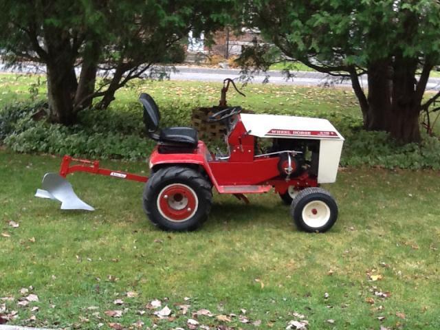

squonk 47,262 #5 Posted December 10, 2025 Terry did these custom decals for Marvin years ago. 2 1 Share this post Link to post Share on other sites

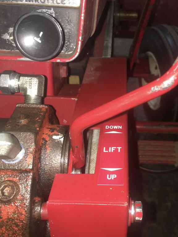

sqrlgtr 3,171 #7 Posted December 10, 2025 Put decal on this morning 1 Share this post Link to post Share on other sites
Handy Don 16,914 #8 Posted December 10, 2025 (edited) 19 hours ago, adsm08 said: Those won't work for me. When I switch from the deck to the plow the up and down switch too. Interesting. When implements are connected at their correct arms to the mid-tractor rock shaft on my 854 and on our 300 and 500 tractors the directions are consistent. If it was otherwise, lifting with the “arm strong” tractors wouldn’t work for all implements. How do your implements link to the rock shaft? Edited December 10, 2025 by Handy Don Share this post Link to post Share on other sites

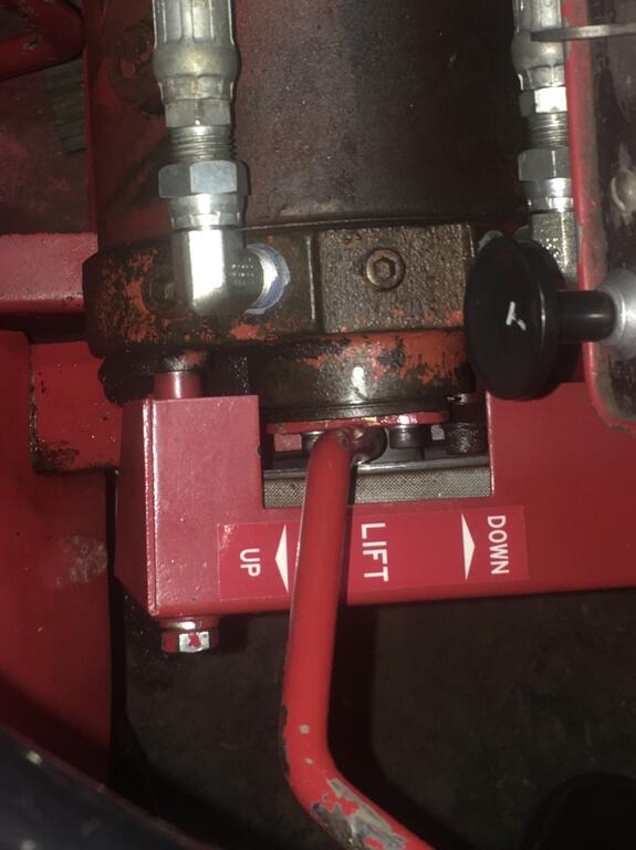

sqrlgtr 3,171 #9 Posted December 10, 2025 (edited) Lift from mid-tractor rock shaft/bell crank. I v Haven't even paid any attention to the rear hitch it may be bass ackwards . I have since replaced thes olid lift link with chain for snow removal, but you get the idea. Edited December 10, 2025 by sqrlgtr Share this post Link to post Share on other sites
Handy Don 16,914 #10 Posted December 10, 2025 (edited) 1 hour ago, sqrlgtr said: Haven't even paid any attention to the rear hitch it may be bass ackwards . I have since replaced thes olid lift link with chain for snow removal, but you get the idea. Yep, the forward-facing arm lifts mowers and the dozer and mid-blade. The downward-facing arm lifts the blower (by pushing it at the bottom) and generator (similar to blower). It also lifts the rear attachment by pulling on the cable to the rear rockshaft. On “arm strong” tractors, pulling the lift lever rotates the rock shaft so that the two arms do their respective jobs. On hydros, the hydraulic cylinder does the pulling. Edited December 10, 2025 by Handy Don 1 Share this post Link to post Share on other sites

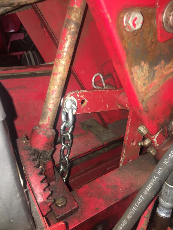

sqrlgtr 3,171 #13 Posted December 11, 2025 Snapped pic of current set up for snow plow and conformed rear hitch works same as decal indicates also. Share this post Link to post Share on other sites
Joker72 96 #14 Posted January 22 (edited) @sqrlgtr Why the chain vs solid shaft? And how long is the solid shaft you used? About to connect mine and not sure of best way to go. ?? Thanks! Edited January 22 by Joker72 Share this post Link to post Share on other sites
sqrlgtr 3,171 #15 Posted January 22 22 minutes ago, Joker72 said: @sqrlgtr Why the chain vs solid shaft? And how long is the solid shaft you used? About to connect mine and not sure of best way to go. ?? Thanks! I'm running an HY2 hydraulic unit and thought I probably couldn't feather the up/down pressure so figured I'd be better off floating on thru brother Share this post Link to post Share on other sites
