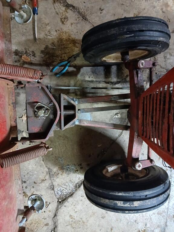

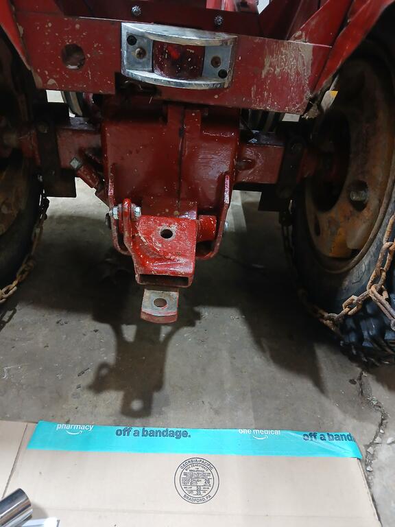

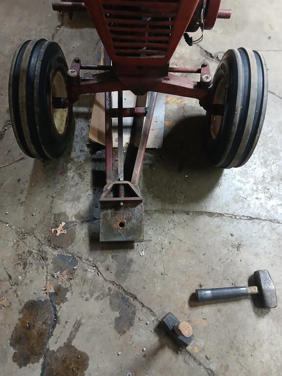

702854boy 1,071 #1 Posted December 6, 2025 Would anyone have a photo of how their BD-4262 plow frame looks from the front? With ours, it's way too far to the right even with both of the angle iron mounts centered on the tractor. It looks like ours is bent to the right but nothing looks broken. This is also causing the left side of the plow to hit the left wheel when the plow is angled to the left. Share this post Link to post Share on other sites
gwest_ca-(File Mod) 12,416 #2 Posted December 6, 2025 Your plow mounts to the front of the rear axle housing with horizontal bolts. Correct? Check your frame at the rear where the transmission bolts to the frame with 4 bolts. They have a habit of cracking around the mounting bolts. Could you add a plate or two between the axle housing and right side mount? Drill two holes in each shim to match the hitch and it may require longer bolts. It would not take much change at the rear to make a big change at the front. 1 Share this post Link to post Share on other sites
702854boy 1,071 #3 Posted December 6, 2025 19 minutes ago, gwest_ca said: Check your frame at the rear where the transmission bolts to the frame with 4 bolts. They have a habit of cracking around the mounting bolts. When we put the transmission in the tractor everything looked all right there. 21 minutes ago, gwest_ca said: Your plow mounts to the front of the rear axle housing with horizontal bolts. Correct? Yes, it is the pre-attach a matic style. 24 minutes ago, gwest_ca said: Could you add a plate or two between the axle housing and right side mount? Drill two holes in each shim to match the hitch and it may require longer bolts. It would not take much change at the rear to make a big change at the front. I could maybe try that sometime this weekend, but another thing I had noticed when looking at it earlier, the right side of the plow appears to be more straight and the left side appears to be more angled in, and the narrowest cross piece appeared to be angled instead of perpendicular to the frame. Share this post Link to post Share on other sites
gwest_ca-(File Mod) 12,416 #4 Posted December 6, 2025 If the mounting bolts have enough length you could back them off on the right side and center the blade up at the front. That would give you an idea of how much shim you would need to add. Hard to say what the blade has gone through over the last 63 years. If it could only talk. 1 Share this post Link to post Share on other sites
702854boy 1,071 #5 Posted December 6, 2025 1 minute ago, gwest_ca said: If it could only talk. Ain't that the truth Share this post Link to post Share on other sites

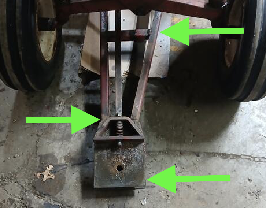

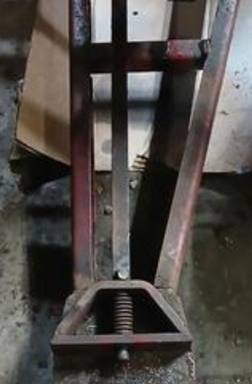

702854boy 1,071 #6 Posted December 6, 2025 Here's some photos of what it looks like right now Share this post Link to post Share on other sites
Bar Nuthin 2,926 #7 Posted December 6, 2025 (edited) 10 hours ago, 702854boy said: Here's some photos of what it looks like right now That frame looks like it's been smoked at one time and improperly welded back together (or not repaired at all). Are you any good at cutting and welding? You're going to need to get it squared up and rewelded. Find a flat area of floor, or maybe a sheet of plywood or drywall, and chalk out a box with a center line, and you'll get some idea of how far out of whack it is. Edited December 6, 2025 by Bar Nuthin 1 2 Share this post Link to post Share on other sites

Handy Don 17,179 #11 Posted December 6, 2025 8 hours ago, Bar Nuthin said: That frame looks like it's been smoked at one time and improperly welded back together (or not repaired at all). Are you any good at cutting and welding? You're going to need to get it squared up and rewelded. Bar you are totally on the money at this frame being distorted. It looks to me like it hit something really hard at the left end of the plow and it simply twisted the quadrant (and the frame) sideways. @702854boy, if it were mine, I’d take it to a body shop with a frame-straighter machine. They might just be able to get it realigned without cutting and welding. Share this post Link to post Share on other sites
702854boy 1,071 #12 Posted December 6, 2025 2 minutes ago, Handy Don said: @702854boy, if it were mine, I’d take it to a body shop with a frame-straighter machine. They might just be able to get it realigned without cutting and welding. Would a bfh maybe work? Share this post Link to post Share on other sites
Handy Don 17,179 #13 Posted December 6, 2025 (edited) 23 minutes ago, 702854boy said: Would a bfh maybe work? Extremely unlikely that you could get the right amount of force in the right place with the frame properly braced for the impact. AND you’d risk making it worse! Frame straighteners use clamps, chains, and hydraulics to carefully pull things into their proper alignment. A tech who knows what they are doing could probably straighten that frame in less than 30 minutes--25 minutes for setup and two minutes to bend it back. Edited December 6, 2025 by Handy Don Share this post Link to post Share on other sites
Handy Don 17,179 #14 Posted December 6, 2025 Notwithstanding my previous post, if I were desperate and low on funds and I had a come-along, some chains, pry bars, and some stout trees and I was willing to chance damaging ithe frame beyond repair, I’d consider kludging up a way to pull it straight by putting it in tension in the right direction and then applying some moderate hits with a sledge. 1 Share this post Link to post Share on other sites
ri702bill 12,689 #15 Posted December 6, 2025 1 hour ago, Handy Don said: the frame beyond repair Not that far from being there right now... 1 Share this post Link to post Share on other sites
Handy Don 17,179 #16 Posted December 6, 2025 (edited) 44 minutes ago, ri702bill said: Not that far from being there right now... Valid point. Complete used plow with a straight (but likely worn) frame would be anywhere from $50-200 around here. I have that same frame on my plow. It is not especially robust and it does flex a bit to let one end of the plow ride higher than the other. Straightening forces would be applied steadily and simultaneously at the arrows. Note that these forces might be a thousand pounds or more and must be kept in the same plane as the frame. Edited December 6, 2025 by Handy Don Share this post Link to post Share on other sites

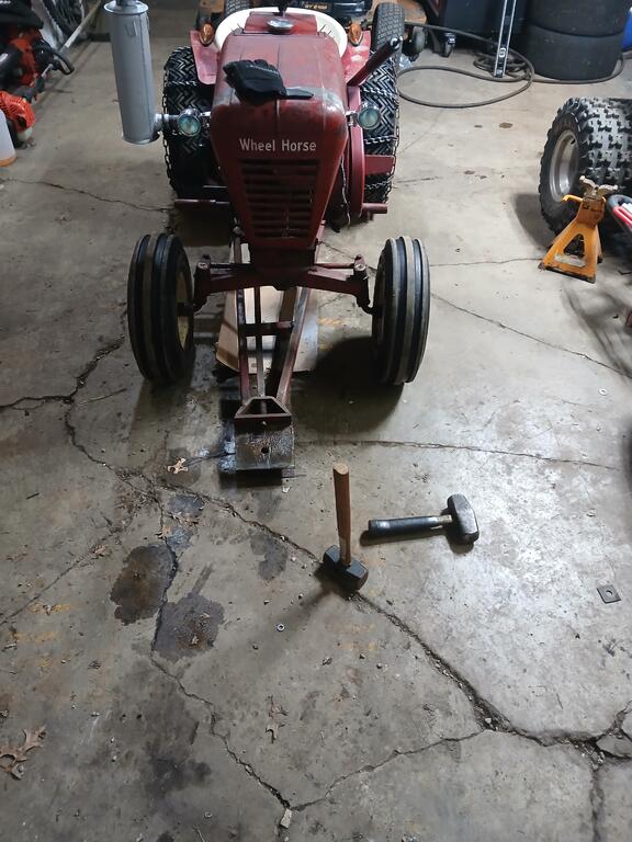

702854boy 1,071 #17 Posted December 6, 2025 1 hour ago, Handy Don said: it does flex a bit to let one end of the plow ride higher than the other. So its not just ours that does that, hm. From the sounds of it, the next time dad's off work and we get a chance we might take a look at it and see what we can do with cutting the welds and bending everything back true and welding it back up. Share this post Link to post Share on other sites
ri702bill 12,689 #18 Posted December 6, 2025 From the movie "Airplane!".... "What's the vector, Victor?" I'm liking the idea of "Cut and Paste (weld)" myself. 1 Share this post Link to post Share on other sites

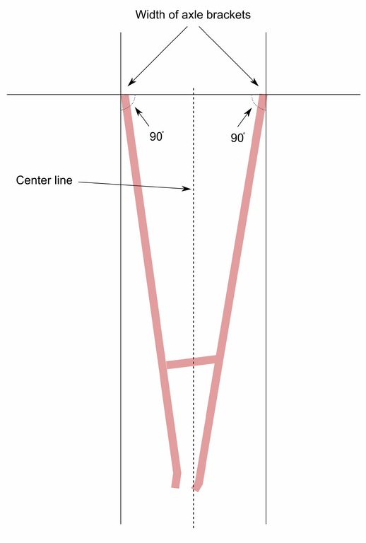

Bar Nuthin 2,926 #19 Posted December 6, 2025 (edited) 2 hours ago, ri702bill said: From the movie "Airplane!".... "What's the vector, Victor?" I'm liking the idea of "Cut and Paste (weld)" myself. I did collision repair and frame work for years. If I had to fix this, I would.... Disconnect the detent rod and get it out of the way Cut the front plate free of the rails Cut out that front crossmember Layout a grid on a sheet of plywood or drywall (drawing from previous post) Anchor the rear attachment points Align the rails back into position - straightening or cutting loose - any additional damage that may be preventing it from lying flat and true. Make sure everything is true and square Replace the crossmember brace with new steel - maybe add an additional one Reweld the front plate - adding reinforcement as best possible by adding some angle iron and maybe gussets. Reassemble and go back to @peter lena's post and fine tune and lubricate Plow some snow. Trying to bend it back into place would most likley only last until the first time you put any force against it. Oh! and if all goes well, clean well and paint! Edited December 6, 2025 by Bar Nuthin Afterthought 1 Share this post Link to post Share on other sites
Bar Nuthin 2,926 #20 Posted December 6, 2025 6 hours ago, 702854boy said: Would a bfh maybe work? No, but a gas axe would be pretty useful 2 Share this post Link to post Share on other sites

702854boy 1,071 #23 Posted December 7, 2025 Here's what the finished product looks like 4 2 Share this post Link to post Share on other sites
