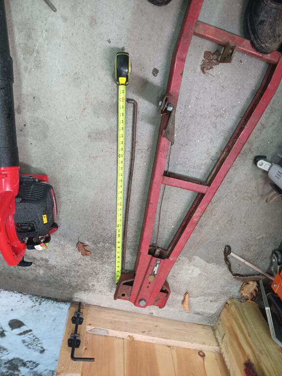

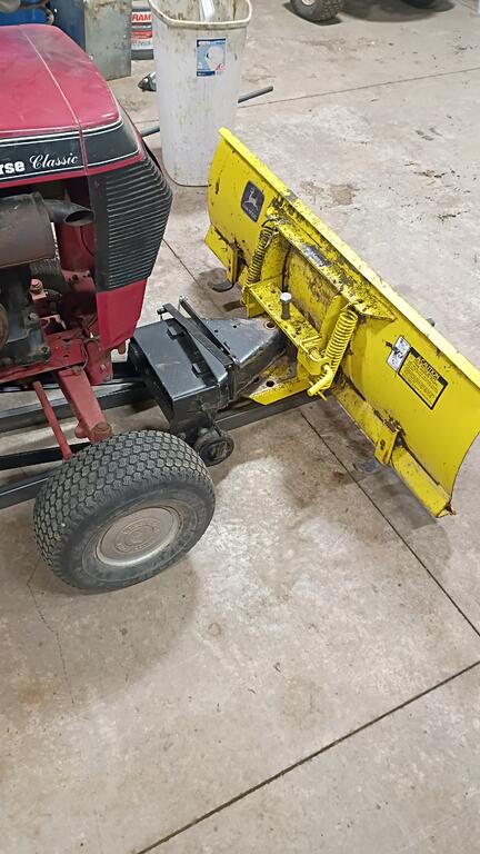

Joe BenHayon 85 #1 Posted November 30, 2025 Being that I live on the Western side of the Continental Divide, and getting a good plow assembly shipped here would probably double my cost, I am looking to build my own frame and will adapt an atv plow to that. I located a axle mount bracket on Ebay, so I have a good attachment. I'm just looking for a drawing or print of the frame. Hoping somebody here can draw it up for me, or point me to a factory print. Thanks, Joe 2 Share this post Link to post Share on other sites

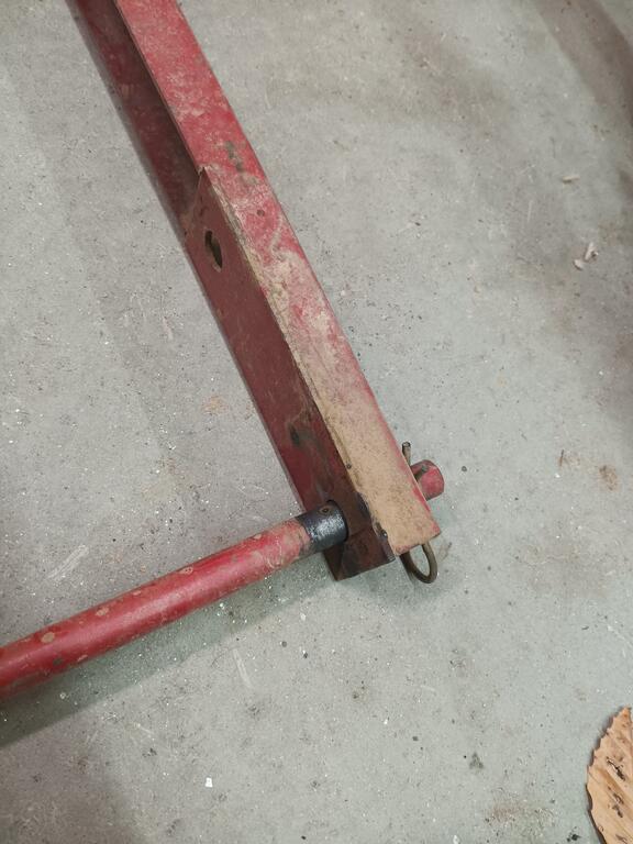

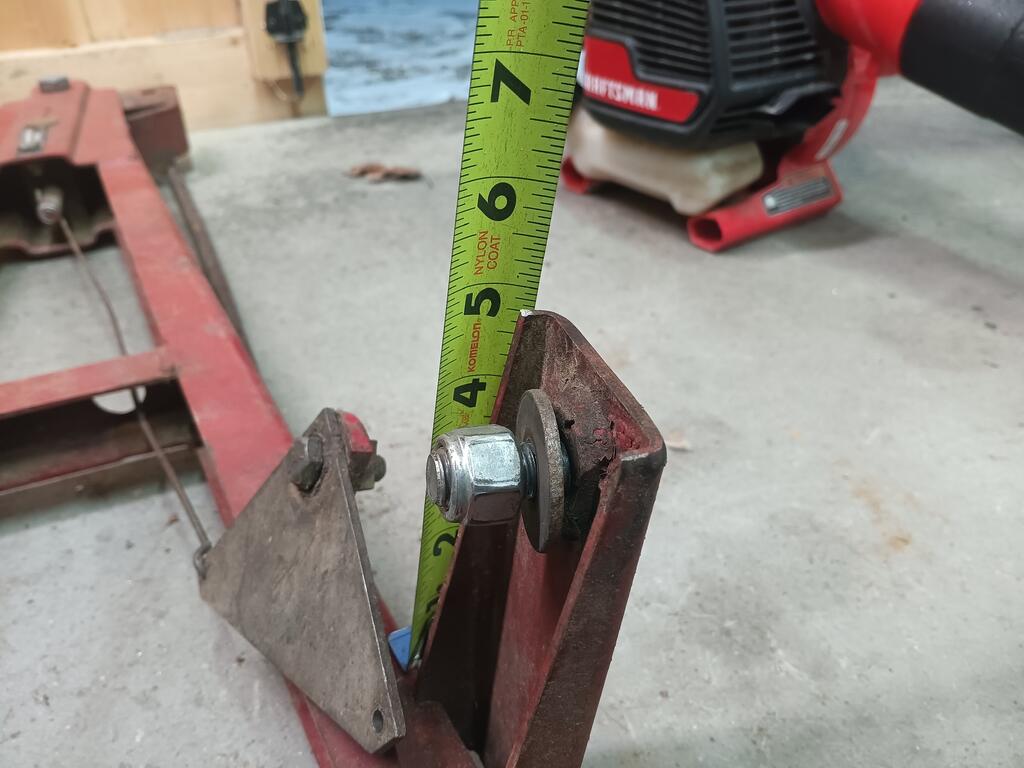

ebinmaine 77,973 #2 Posted November 30, 2025 Joe I'm no artist or anything close it but we do have a bare plow frame setting in the barn for easy access. I'd be happy to get some pics and measurements for you later today. 3 Share this post Link to post Share on other sites

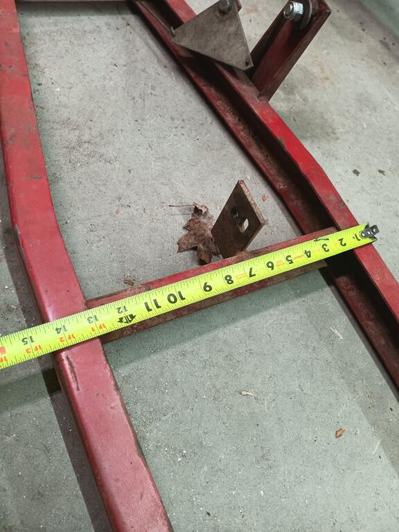

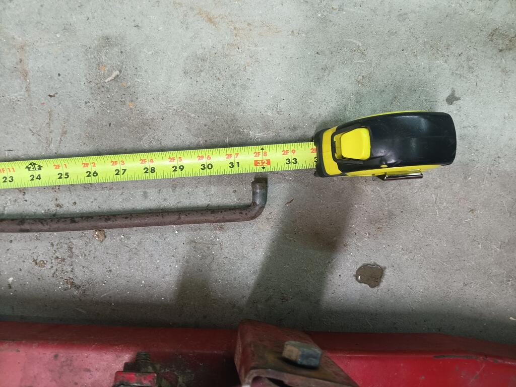

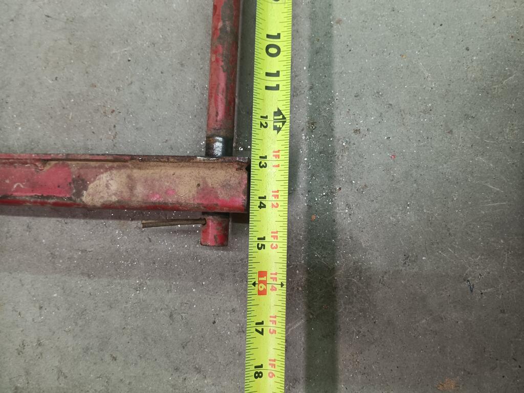

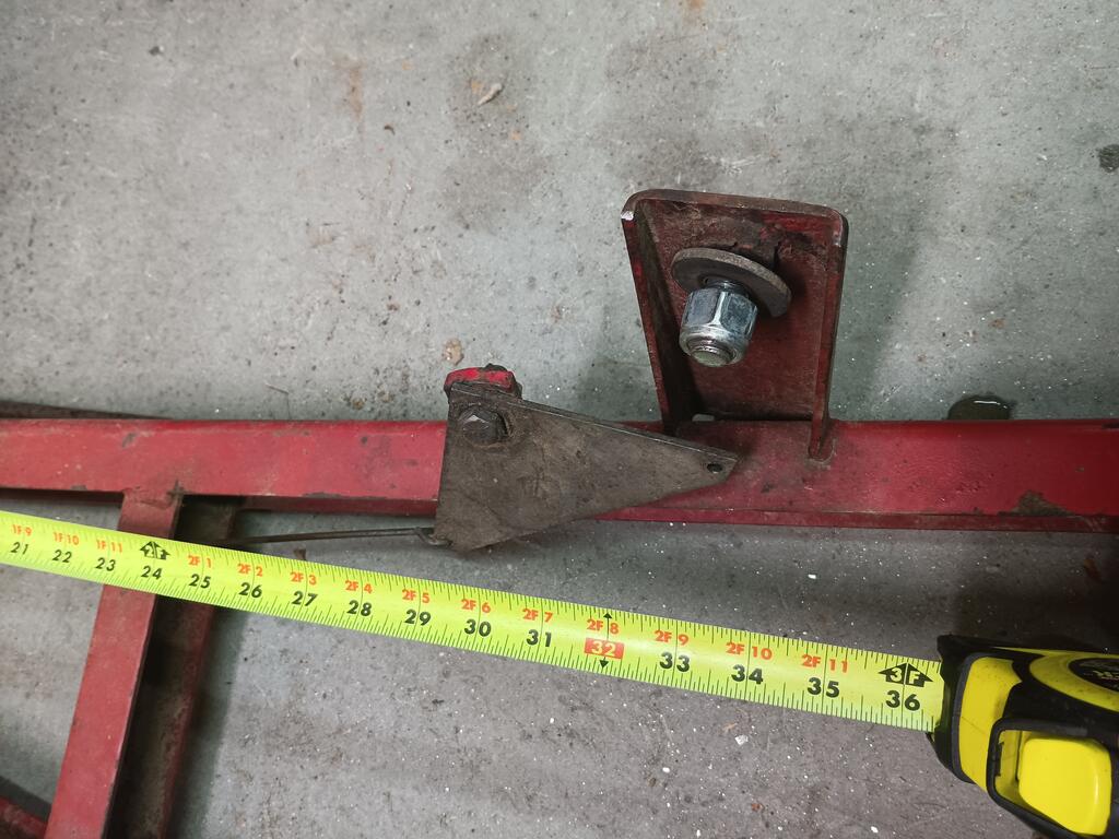

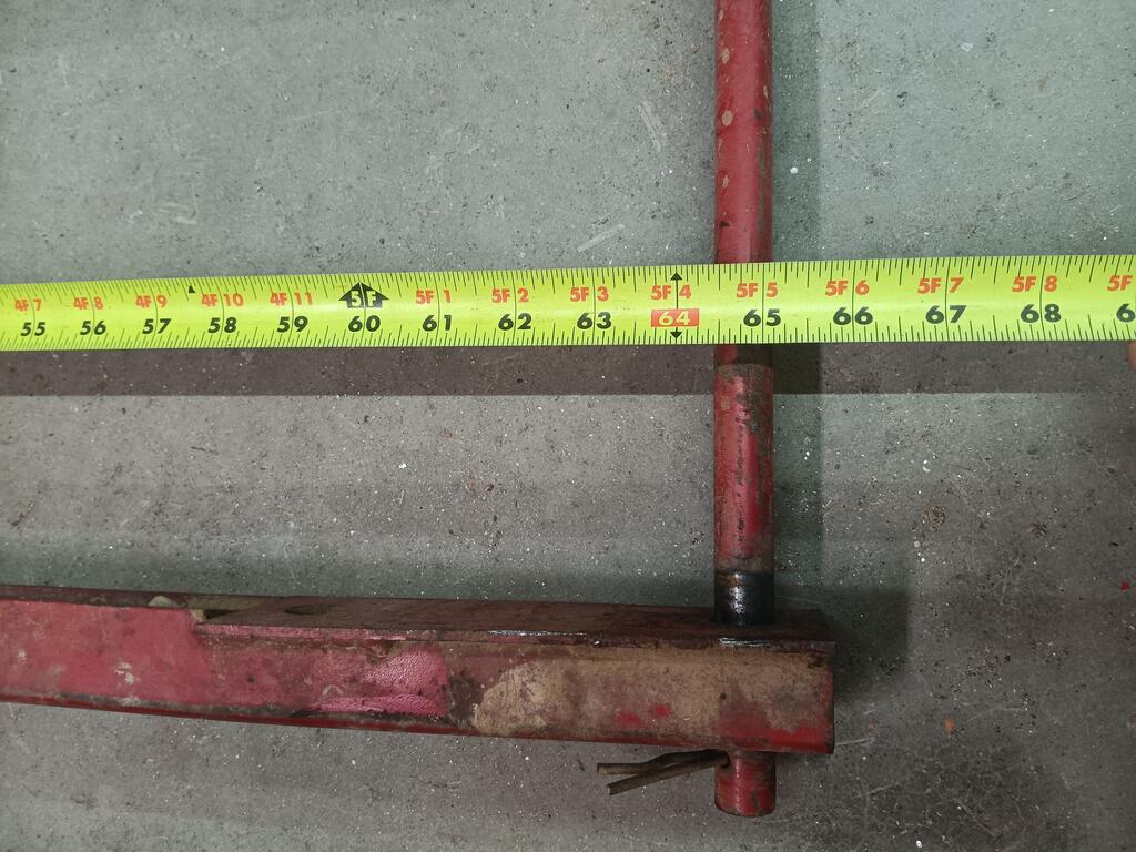

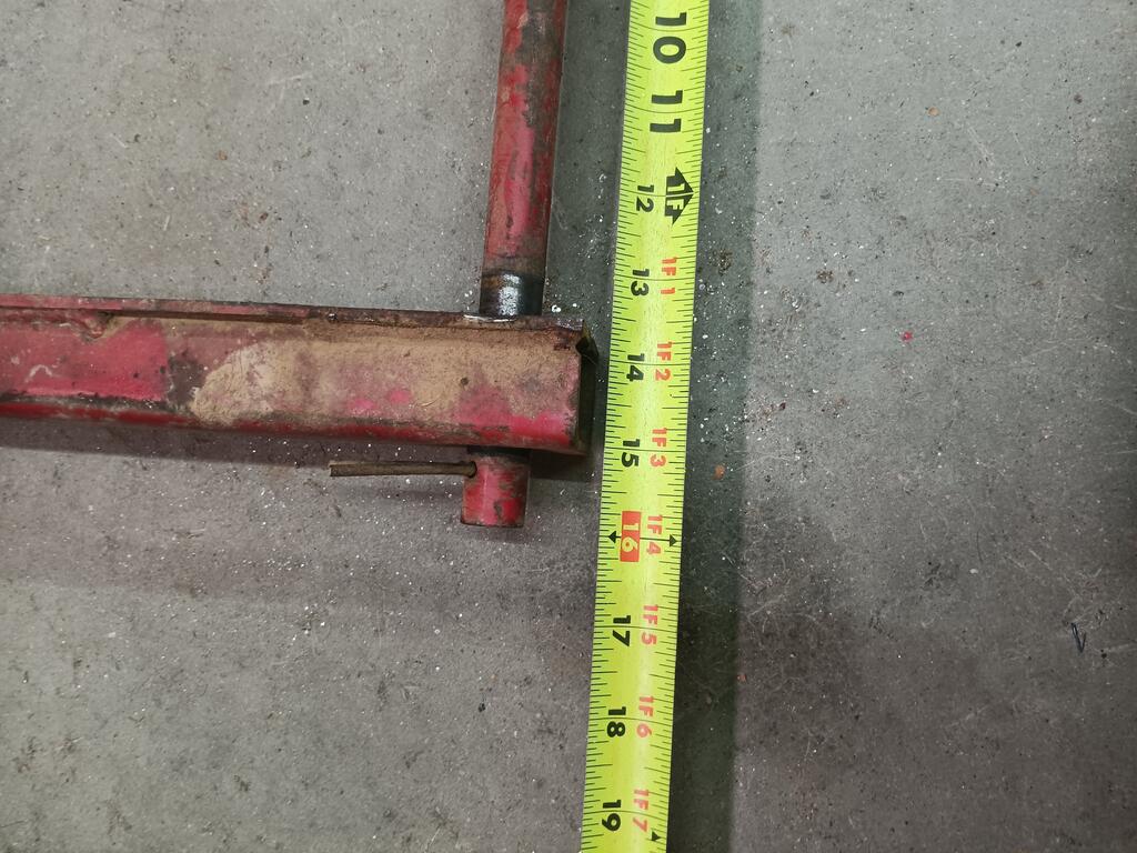

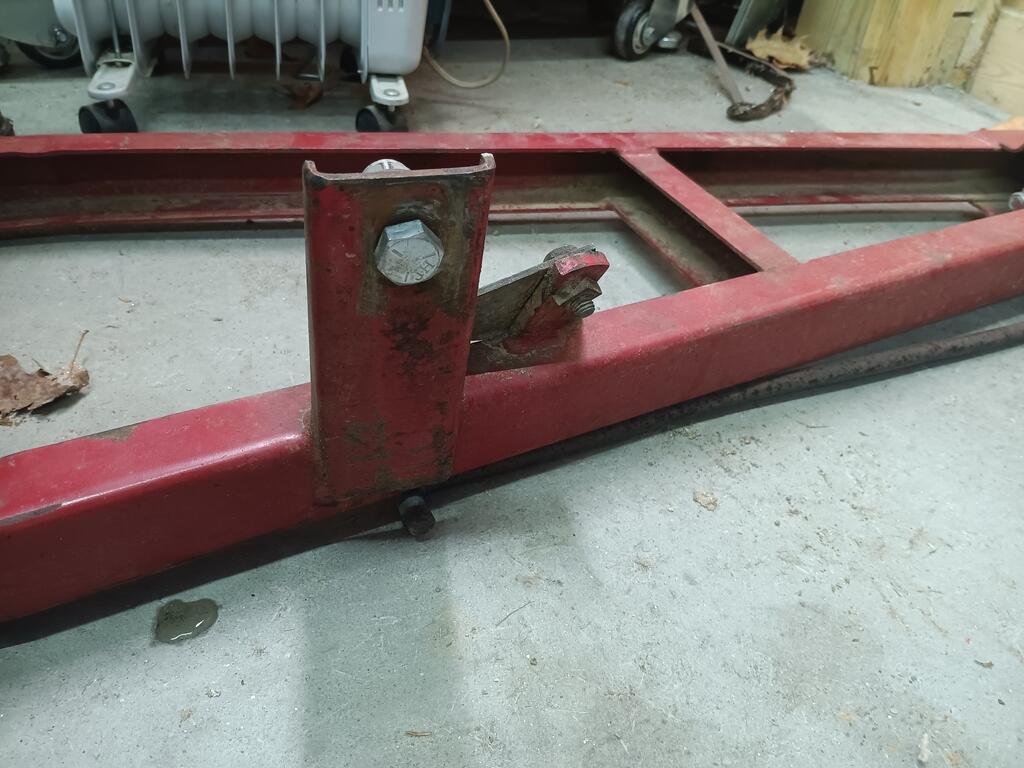

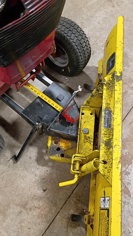

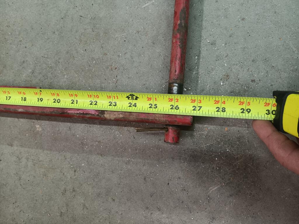

ebinmaine 77,973 #5 Posted November 30, 2025 Here's a pile of pics with a tape measure. 1 Share this post Link to post Share on other sites

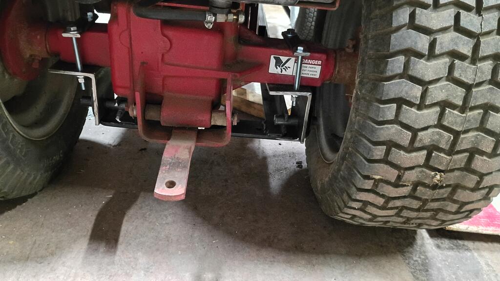

Joe BenHayon 85 #6 Posted November 30, 2025 1 hour ago, ri702bill said: Got the axle bracket??? There are two styles; one for short frame tractors and one for later long frame tractors like your 312. Be sure you get the correct one. The frame is one thing; if the ATV plow does not angle, there are numerous parts needed to do so. And the trip feature - VERY important if you encounter a fixed solid object while plowing... Is there a specific "other" brand of garden tractor in plentiful supply out in Colorado? Perhaps you could buy / barter one that has those features and adapt the frame?? Just my ... There is one on eBay sold by Wheel Horse Parts and More, pn: 104659, that is apparently the right one. I have seen the frame extension kit, but I figure if I have the overall length, I can build/modify another brand to work. As for the plow, I found a JD one that has the trip feature and is steerable. So once I have dimensions, I can modify as needed Share this post Link to post Share on other sites
Joe BenHayon 85 #7 Posted November 30, 2025 Thanks ebinmaine! On the frame, is that regular C-channel or fabricated from flat plate? Share this post Link to post Share on other sites
ebinmaine 77,973 #8 Posted November 30, 2025 12 minutes ago, Joe BenHayon said: Thanks ebinmaine! On the frame, is that regular C-channel or fabricated from flat plate? 22 minutes ago, ebinmaine said: All "C" channel. You can see 👀 😏 it above. I can get measurements on that tomorrow. Note the section that has plate attached to the inside with the 3/4" rod through it. That's the part that attaches to the rear bracket. FYI. If you have the skills to weld up a whole frame, you could probably make a rear bracket too. Unrelated: "C" is for cookie. I learned that from Cookie Monster years ago. 4 Share this post Link to post Share on other sites
ri702bill 11,617 #9 Posted December 1, 2025 2 hours ago, ebinmaine said: All "C" channel But not C shaped Structural Channel Iron. Not that heavy, no square outside corners. Looks like custom bent flat stock. This stuff would weigh a ton!! Share this post Link to post Share on other sites
8ntruck 8,700 #10 Posted December 1, 2025 I'd guess they were roll formed. 1 Share this post Link to post Share on other sites
ebinmaine 77,973 #11 Posted December 1, 2025 56 minutes ago, ri702bill said: But not C shaped Structural Channel Iron. Not that heavy, no square outside corners. Looks like custom bent flat stock. This stuff would weigh a ton!! There's a type of C channel with a rounded outside corner. Much lighter than the picture above. Share this post Link to post Share on other sites
peter lena 9,812 #12 Posted December 1, 2025 @Joe BenHayon would also be a good time to plan some upgrading for functional detailing , that front of frame steering quadrant , slide pin / function runs the whole show , also the , also the swing lever frame mount point , good spot for a shoulder bolt and elastic lock nut , to hold washered / lubricated swing area . would also build that up on milk crates up off the floor , suspended like on the tractor , roller stool heim joints on movement rods . lets you dial in entire movement function , just a suggestion , pete 1 Share this post Link to post Share on other sites
Lee1977 7,629 #13 Posted December 2, 2025 EB is the 65" from the blade pivot or the blade mount? It's a little unclear where you measured from. There is a lighter weight U channel 2" x !" with !/8" on all three sides. Still heaver then the folded plate channel. 2 Share this post Link to post Share on other sites
ebinmaine 77,973 #14 Posted December 2, 2025 5 hours ago, Lee1977 said: EB is the 65" from the blade pivot or the blade mount? It's a little unclear where you measured from. There is a lighter weight U channel 2" x !" with !/8" on all three sides. Still heaver then the folded plate channel. That's measuring the total length of the frame from the nose. Right over the top of the pivot bolt. 2 Share this post Link to post Share on other sites

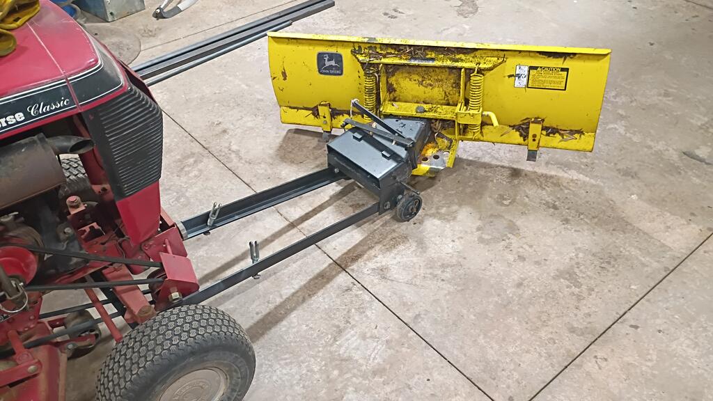

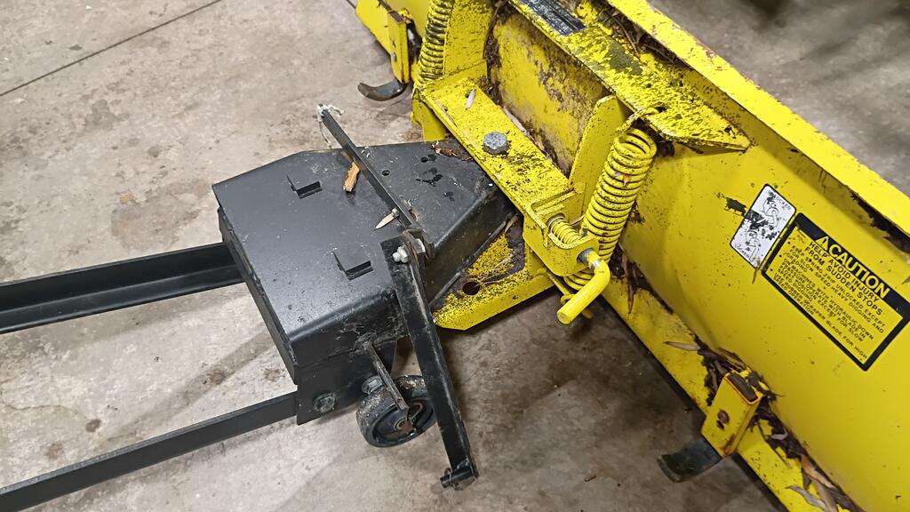

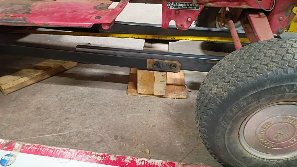

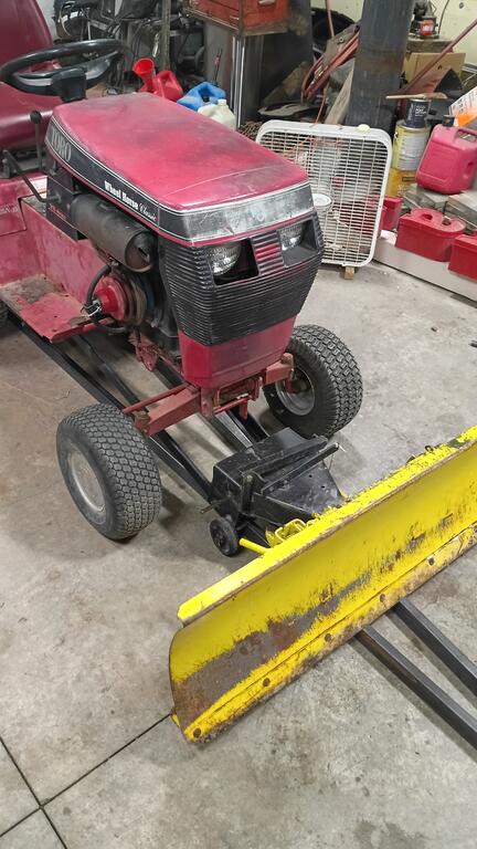

Joe BenHayon 85 #15 Posted December 6, 2025 (edited) And so it begins..... 🧐🧐 I picked up some 1x2 rectangle tubing in lieu of the factory style "U" channel. The JD blade has 5 position angle adjustment and the trip can be locked for dirt work. 😁 It's only 45" wide, but it is wider than my track at the rear wheels. I'll have to modify the front mount, but will keep the wheels as they have proven handy to move the plow around just getting it into position for pictures. 😁😁👍👍 I gave $50 for the plow. Edited December 6, 2025 by Joe BenHayon Added cost. 2 Share this post Link to post Share on other sites

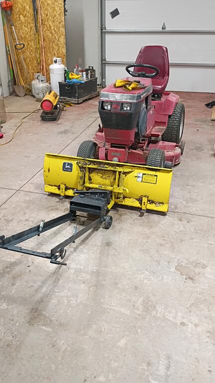

Joe BenHayon 85 #16 Posted December 6, 2025 Mock-up looks promising..... 😁😁 1 2 Share this post Link to post Share on other sites
SylvanLakeWH 30,923 #17 Posted December 6, 2025 Looking good! Gonna need to paint that thing red though... 1 1 Share this post Link to post Share on other sites
peter lena 9,812 #18 Posted December 6, 2025 @Joe BenHayon ever serviced the front end , for wear / lubrication ? thats a lot more plow than original , front spindles and wheel bearings/ related , might need a refresh , your lighter dry snow is a big advantage , good luck with that , pete 1 Share this post Link to post Share on other sites

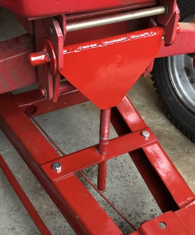

Joe BenHayon 85 #20 Posted December 7, 2025 Anyone have problems with the frame racking sideways when dumping snow off to the side? Share this post Link to post Share on other sites
Joe BenHayon 85 #21 Posted December 7, 2025 Progress... 😁😁😁 1 Share this post Link to post Share on other sites
kpinnc 17,575 #22 Posted December 7, 2025 Looks good so far. What's the offset at the rear for? 1 Share this post Link to post Share on other sites
ebinmaine 77,973 #23 Posted December 7, 2025 8 hours ago, Joe BenHayon said: Anybody have a weight for the factory plow assembly? I can get that this morning. 7 hours ago, Joe BenHayon said: Anyone have problems with the frame racking sideways when dumping snow off to the side? Thw frames don't bend but the entire assembly can absolutely be sent sideways some. Many people make a bracket limiting side motion at the front. 2 Share this post Link to post Share on other sites
peter lena 9,812 #24 Posted December 7, 2025 @ebinmaine think that plow strength / weight alone , will overpower / that entire set up , if it ever gets used , numerous other failures will show themselves . running an original horse plow for many years , only thing that wares out is the , lower blade scraping strip set up . keeping blade slick , really helps snow slide off , unloading it easily . would bet that front axel set up is not going to last long , spindles / bearings etc, that plow weight / strength , will eat that horse , pete Share this post Link to post Share on other sites
Handy Don 16,109 #25 Posted December 7, 2025 12 hours ago, Joe BenHayon said: Anyone have problems with the frame racking sideways when dumping snow off to the side? 4 hours ago, ebinmaine said: Many people make a bracket limiting side motion at the front @Ed Kennell has made a couple and those inspired me to make this one. Ed’s also include weight holders for helping keep the front on the ground and steerable! The key is to limit side-to-side motion within the Attach-a-Matic (I used washers welded to the ends of the rod) and not extend the reinforcement downward too far to impeded lifting the plow. Adding a decal to the front plate is optional--I just haven’t come up with a nifty idea yet! Others have made their down-rod align with holes one of the plow frame side rails. 2 1 Share this post Link to post Share on other sites
