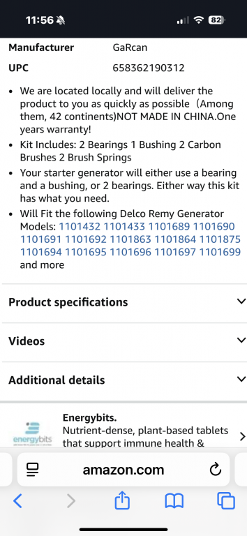

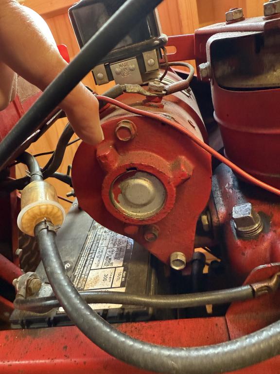

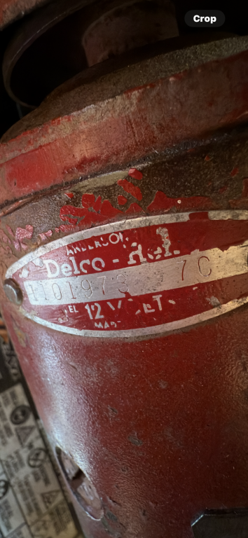

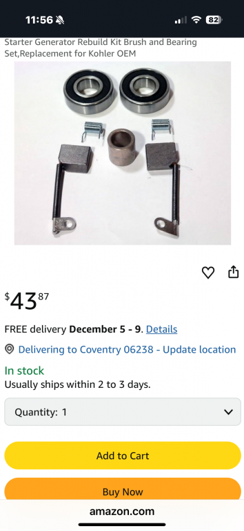

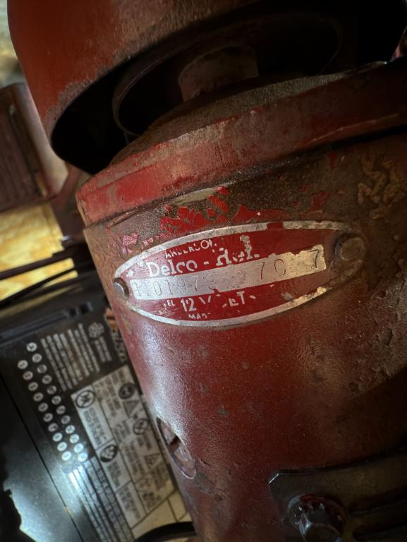

  The starter/generator on my 857 starts and charges well…but it’s noisy. It’s model #1101973.  I’m looking for a rebuild kit. Amazon has what I think is the exact same kit that I Save Tractors was selling (some picture and same write up) for $43.
  The number on mine isn’t on the list that the Amazon ad shows, it lists off many numbers and then says “and many more”. Am I one of the many more? I assume mine is just a standard start/gen from the 60’s?
  The last two pics are off the Amazon page.

That kit fits both styles of S/G's. Early ones with 2 ball bearings, later ones with 1 bushing and 1 ball bearing. Should be fine? Does Yours have two oil cups on it?? My 854 does - 2 bearings.

 Bill, no oil cups on either my 857 or my 867. I can see when the casting has been changed to eliminate em though :ranting:

In the thread linked by @squonk above  - @953 nut posted a link to an ebay seller.
That description shows the 1101973 for your application.
Pricing is very reasonable at $24 to your door but it doesn't indicate country of origin.
