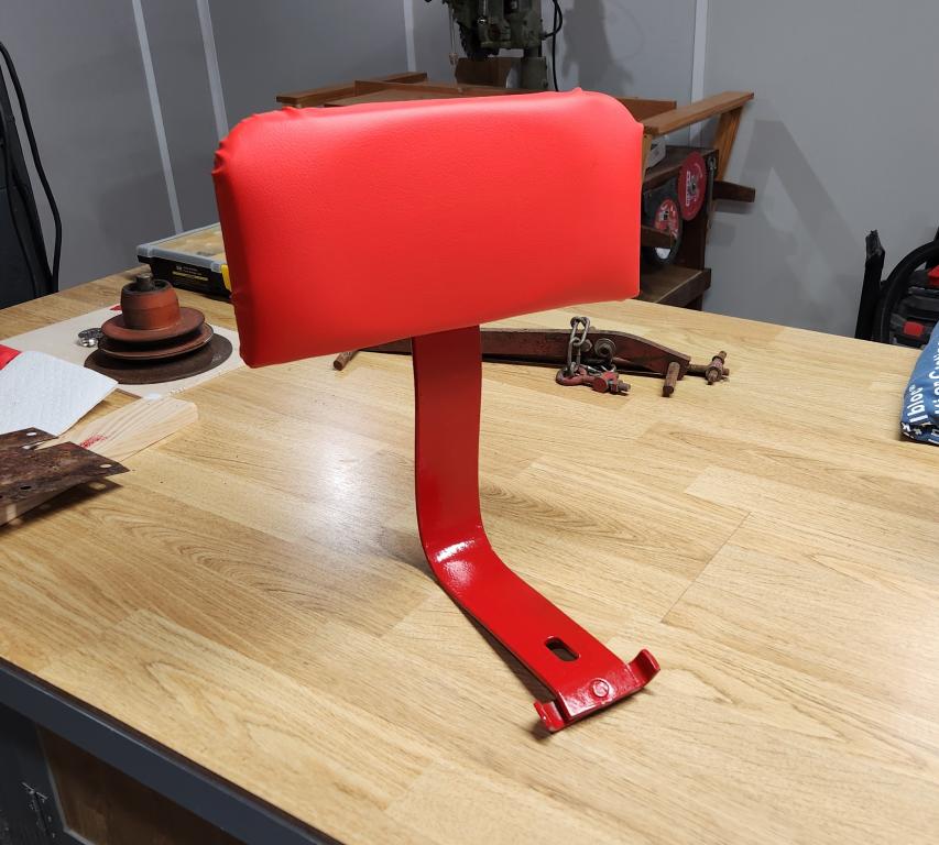

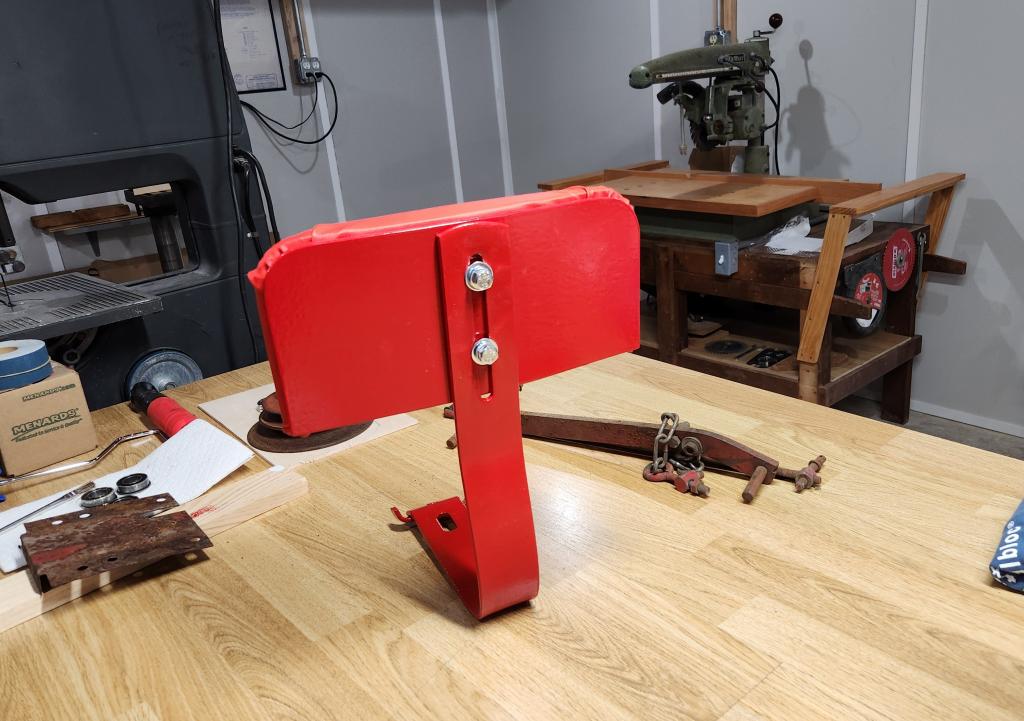

Racinbob 13,106 #2 Posted November 25, 2025 Thanks to @WHX?? I managed a frame for one. It needed to be recovered and I decided to replace the plywood as well. I traced the old back onto a new piece of 9-ply then wet it down and let it sit a few days weighted in the middle to give it the slight curve. Add a coule blind nuts for the bolts. My wife picked up a piece of foam and some red vinyl and did the cover. Since she doesn't have whatever it takes to do the white thing around the edge she simple stapled it on the backside. I cleaned it up with another piece of 1/8" ply. I can get the dimensions later today. 1 Share this post Link to post Share on other sites

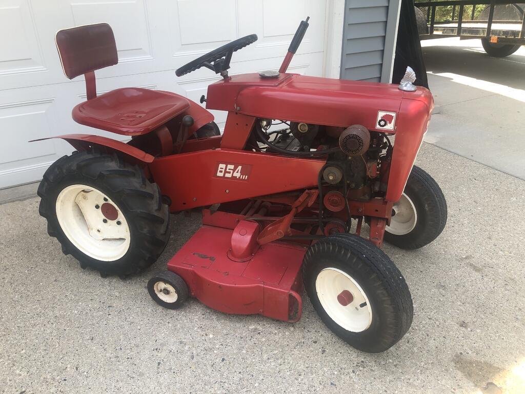

ri702bill 12,790 #3 Posted November 25, 2025 9 hours ago, DBlackston said: I can't bring myself to pay $100+ for I feel the exact same way about genuine WH cast iron wheel weights. Yeah, they are nice, but just how nice do you really need for a seasonal accessory? I thought about cobbling one up for my 854, but it would just make it way too difficult for getting on & off what is now easy with the 36" deck ... nope. Share this post Link to post Share on other sites

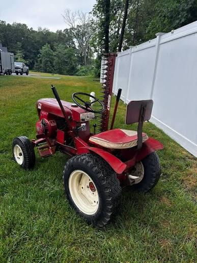

Racinbob 13,106 #5 Posted November 25, 2025 (edited) 6 hours ago, ri702bill said: I thought about cobbling one up for my 854, but it would just make it way too difficult for getting on & off what is now easy with the 36" deck ... nope. Very true but it's mounted on my 854 which wears the sickle mower year round. I have to sorta thread my leg between the bar and tractor and under the bar support so it really isn't a hinderance. Definitely worth it when I spend several hours doing the paths. Edited November 25, 2025 by Racinbob 1 Share this post Link to post Share on other sites
