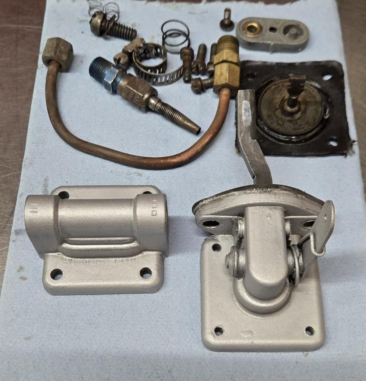

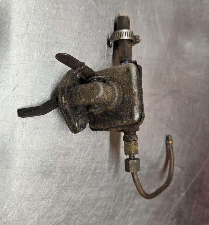

kpinnc 17,149 #12 Posted November 30, 2025 On 11/24/2025 at 8:01 PM, 953 nut said: it must be screeched by holding tension on the arm before tightening the four screws. I screeched several times during disassembly and cleaning , but am unsure what you mean. What is you talkin bout? The pump I am rebuilding is from a K161 on a 701. Mechanical arm plus the outside primer handle. I do believe it has never been rebuilt or cleaned as it took hours just to get the crud out of it. Wasn't so bad outside, but sheesh it was nearly solid deposits inside. Took about an hour to flatten it back out too. 1 1 Share this post Link to post Share on other sites
