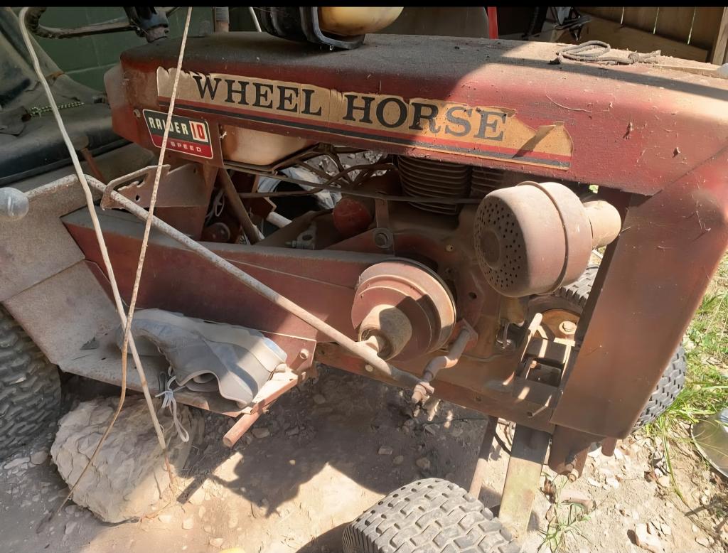

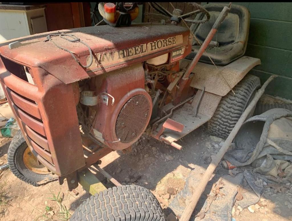

DBlackston 333 #1 Posted November 24, 2025 I thought that Raider 10s were Tecumseh motors? This one is a Raider 10, but has a Kohler and I think an 8 speed, but hard to see. What spec Kohler would this be? It's listed on marketplace as turning over but not starting for $225 and piqued my interest, but I think I have my heart set on a C-160 Hydro for my next tractor. Share this post Link to post Share on other sites

Retired Wrencher 6,783 #3 Posted November 24, 2025 (edited) @DBlackston That will be a great tractor if you go thru it front to back. It is time consuming but in the end you will be happy with it. There should be a name plate on the side of the engine.towards the bottom. That speck # will give you all the info you need for this engine. Enjoy the project. Edited November 24, 2025 by Retired Wrencher Share this post Link to post Share on other sites
953 nut 67,363 #4 Posted November 24, 2025 7 hours ago, DBlackston said: listed on marketplace as turning over but not starting It hasn't got an ignition coil, of course it won't start. 7 hours ago, DBlackston said: thought that Raider 10s were Tecumseh motors? 1970 and 1971 were, but 1972 was equipped with a Koehler. 1 Share this post Link to post Share on other sites
pfrederi 20,860 #5 Posted November 24, 2025 Spec Number should be 46636D Battery points 10 amp charging system 1 Share this post Link to post Share on other sites
