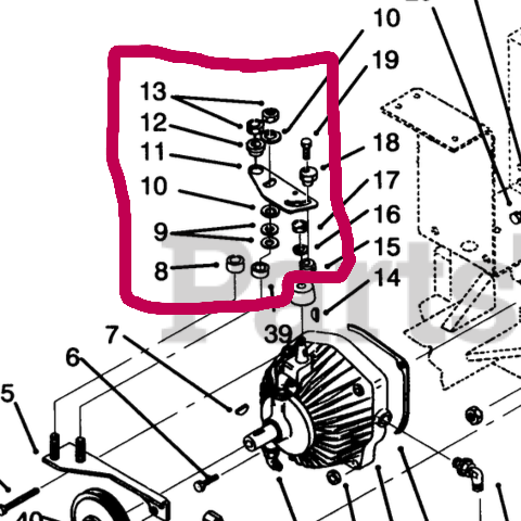

jsoluna
Does anyone have a picture of the (2) spring washers under the lower friction washer on the hydro cam plate? (#9 on the parts diagram below.)
Just took this one apart and found what I think is a single domed, solid washer.  None of the parts diagrams show that.  Wondering if I have a previous owner "fix"....
I assume they are like spring/wave washer of sorts?  Or are they bellville washers?
Edited by jsoluna
  • Like 3

jsoluna
2 hours ago, ebinmaine said:
Check  @cleat 's thread about his 416
Cleat's thread is fantastic.
However, during the rebuild, he did not use the factory spring washer and tension washer setup at the hydro cam plate, so for OEM reference it does not suffice.
https://www.wheelhorseforum.com/topic/110413-got-another-one-a-416-this-time/?do=findComment&comment=1253363
  • Like 2
  • Thanks 1

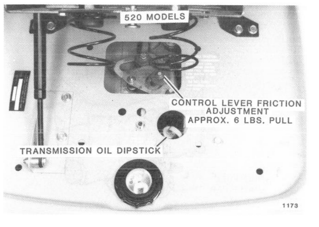

cleat
Thanks Guys.
My 416 is going to foot control so removed those spring washers.
There should be two dome shaped washers that go in facing each other for spring action.
I wonder if your is missing one or they are just facing the same direction and stacked.
Likely either way will work so long as you can get the proper drag when tightened as shown below.
Edited by cleat

jsoluna
Thanks Cleat.
The washers are NLA, found some NOS and have them coming.
