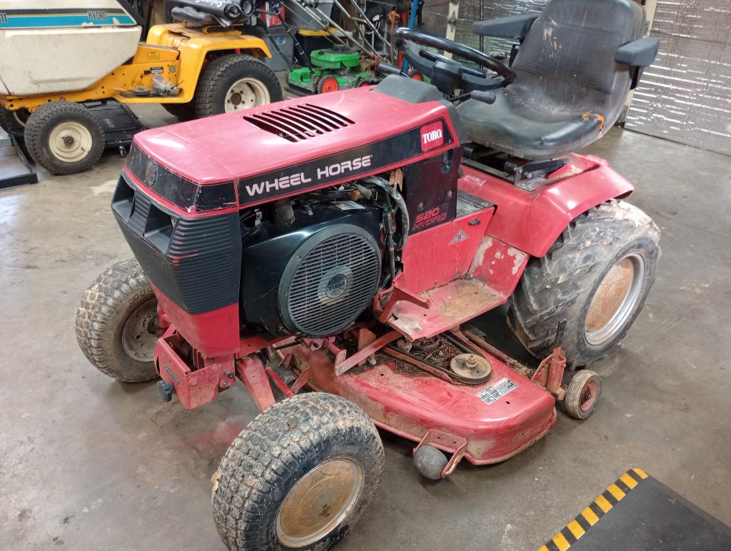

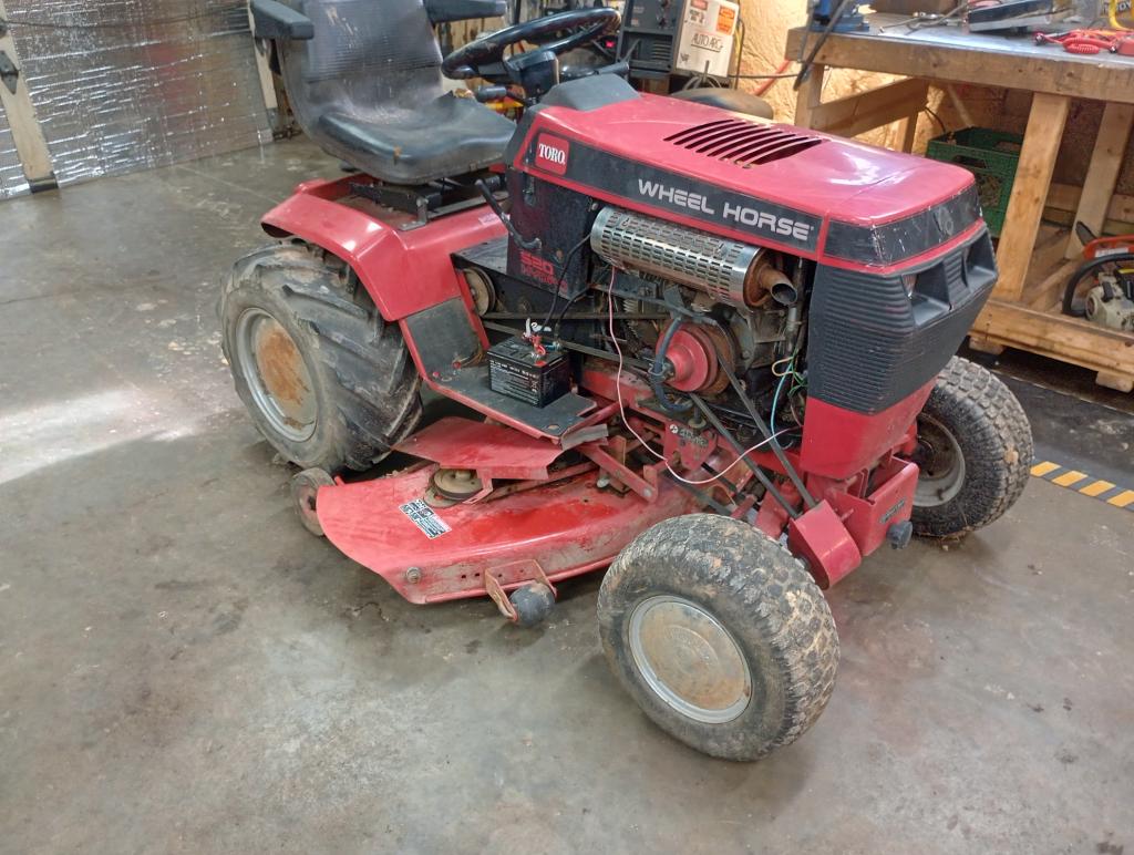

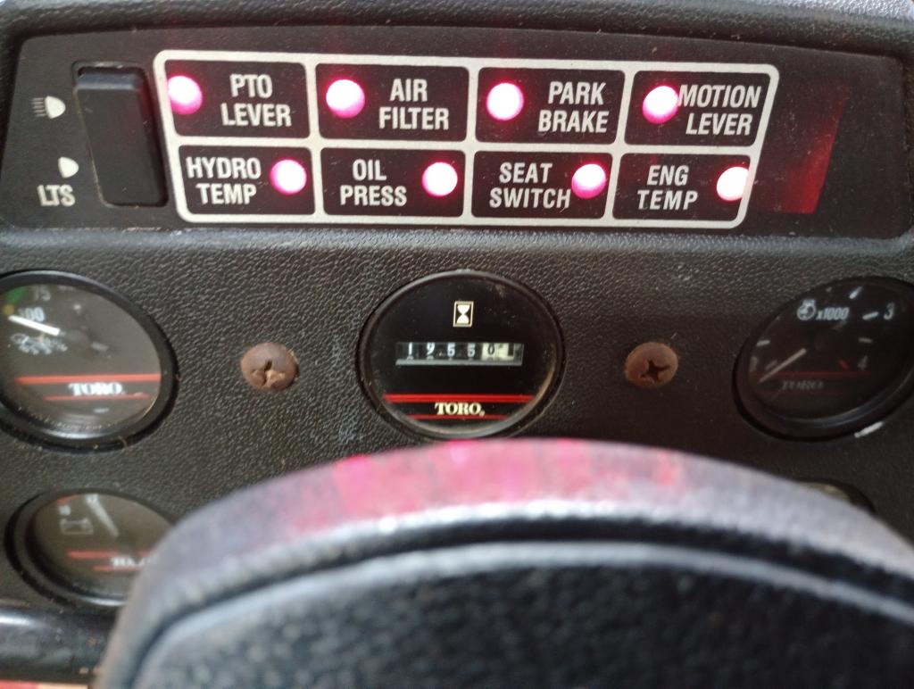

jsoluna 514 #1 Posted November 22, 2025 (edited) It appears the Wheel Horse bug has hit for real. Stumbled upon this 520-H not even 5 minutes from our shop. Really don't need another project to add to the list, but couldn't pass it up for the price. It's pretty rough. Almost 2k hours, single owner machine though. What I know so far: Owner said "it needs a starter solenoid".... Does not run. Will crank (solenoid is fine) and has compression. Looks like they hooked up the replacement ignition coil wrong and sent battery 12v+ to the ground side of the ignition module. It's toast, as is the coil. Pretty pricey way to start the revival, but it is what it is. Followed proper procedure for testing both components and they are indeed bad. Steering is extremely sloppy. Most of it is in the tie rod ends, but a good portion of it appears to be in the steering gear backlash. Has hydraulic leak near the rear somewhere. Has previous owner wiring "fixes". Loaded rear old school Goodyear treads. Deck shell looks newer than the rest of the tractor. Maybe a replacement? Has axle bracket installed. Dash lights all come on at startup, but I will plan on going through the whole system. Don't like having hidden gremlins and I enjoy the electrical challenge. All in all, pretty excited. Edited November 22, 2025 by jsoluna 2 8 Share this post Link to post Share on other sites
ri702bill 13,392 #2 Posted November 22, 2025 (edited) Nice start... Not too many of us ever feel we "enjoy" the electrical challenge though.... Edited November 22, 2025 by ri702bill 2 1 1 Share this post Link to post Share on other sites
lynnmor 9,081 #3 Posted November 22, 2025 Looks like she was rode hard and put away wet. That steering gear backlash might come out when you adjust the nut in front of the gear, that requires a cotter pin removal and a 3/4" wrench. If it is severely worn a washer behind the nut will give more adjustment and still have cotter pin engagement. You might find a complete kit of ignition parts on eBay for way less than OEM, they are aftermarket but some have had good success. 2 1 Share this post Link to post Share on other sites

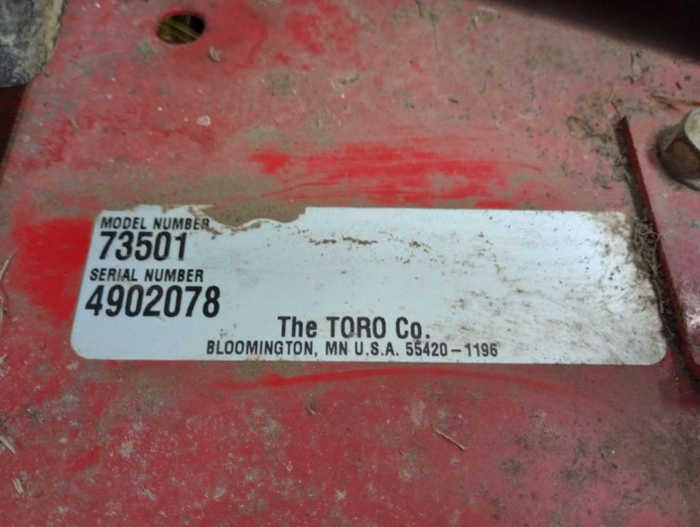

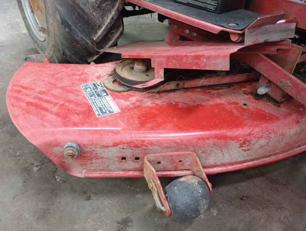

Ed Kennell 47,944 #4 Posted November 22, 2025 47 minutes ago, jsoluna said: Deck shell looks newer than the rest of the tractor. Looks like a $400 48" er. 3 1 Share this post Link to post Share on other sites
jsoluna 514 #5 Posted November 22, 2025 (edited) 1 hour ago, lynnmor said: Looks like she was rode hard and put away wet. That steering gear backlash might come out when you adjust the nut in front of the gear, that requires a cotter pin removal and a 3/4" wrench. If it is severely worn a washer behind the nut will give more adjustment and still have cotter pin engagement. You might find a complete kit of ignition parts on eBay for way less than OEM, they are aftermarket but some have had good success. Thanks, I'll look into that steering gear and see what I can find. Found a few kits on eBay that are clearly aftermarket copies, any experience with a particular seller? Or is it like most of these things, where it's luck of the draw? Edited November 22, 2025 by jsoluna 1 Share this post Link to post Share on other sites
jsoluna 514 #6 Posted November 22, 2025 Definitely rode hard and put away wet. 1 Share this post Link to post Share on other sites

JoeM 10,318 #11 Posted November 23, 2025 Those Onan 20's really have a lot power. Often wondered why they use a lot fuel. Onan 20 has 47cid Kohler CH20 has 38cid. Those extra cubes put it in the same class as a 25-27HP engine. just saying. Like the car guys say "there is no replacement for displacement!" Sure would have been nice if WH left all whose "idiot lights" off the machine. Imagine how clean the wiring system would be! 2 Share this post Link to post Share on other sites
jsoluna 514 #12 Posted November 23, 2025 (edited) On 11/23/2025 at 5:21 AM, JoeM said: Those Onan 20's really have a lot power. Often wondered why they use a lot fuel. Onan 20 has 47cid Kohler CH20 has 38cid. Those extra cubes put it in the same class as a 25-27HP engine. just saying. Like the car guys say "there is no replacement for displacement!" Sure would have been nice if WH left all whose "idiot lights" off the machine. Imagine how clean the wiring system would be! The flatheads are much less efficient due to the nature of the combustion chamber and valve arrangement, and have lower compression than a typical OHV engine. This, they use more fuel to make the same power. They tend to be very torquey engines though. My personal favorite is the Magnum twin. I enjoy the engineering behind the wiring systems on the 520-H. Definitely overcomplicated for a garden tractor, but really cool all the same. Edited November 29, 2025 by jsoluna 4 1 Share this post Link to post Share on other sites
ebinmaine 81,281 #13 Posted November 23, 2025 20 hours ago, jsoluna said: I enjoy the electrical challenge. All in all, pretty excited. 20 hours ago, ri702bill said: Nice start... Not too many of us ever feel we "enjoy" the electrical challenge though.... I do... to a point... Building a wiring harness from scratch for a 6 or 10 wire system is relaxing to me. I dont have much desire to tackle a 520 set up. But it is certainly interesting to see and understand. @jsoluna I've personally had better luck installing used OE electrical parts than new aftermarket. Possibly @76c12091520h Brian Badman or Lincoln at A to Z Tractor in PA could be a source. 3 Share this post Link to post Share on other sites
lynnmor 9,081 #14 Posted November 23, 2025 5 hours ago, JoeM said: Sure would have been nice if WH left all whose "idiot lights" off the machine. Imagine how clean the wiring system would be! The "idiot lights" can be covered with duct tape if you hate them so much. Personally I never had problems with them. 1 Share this post Link to post Share on other sites
Handy Don 17,735 #15 Posted November 23, 2025 2 hours ago, ebinmaine said: a 520 set up. But it is certainly interesting to see and understand. The shift to using solid state components to “interpret” the sensors and activate LED indicators was inevitable. Most buyers were impressed with the lights but discrete bulbs, sockets, and wiring would have been a maintenance PITA. Like @lynnmor, I’m good with having the extra instrumentation Share this post Link to post Share on other sites

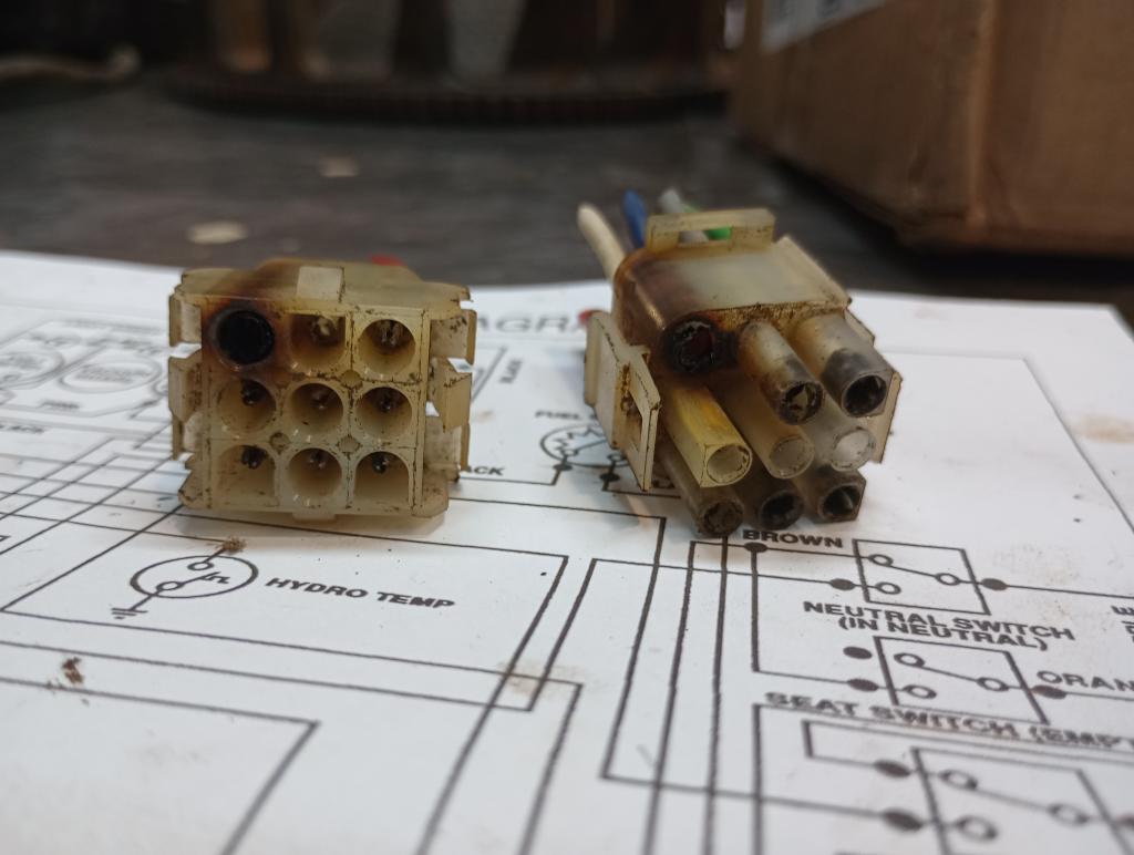

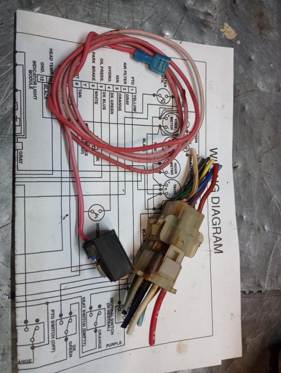

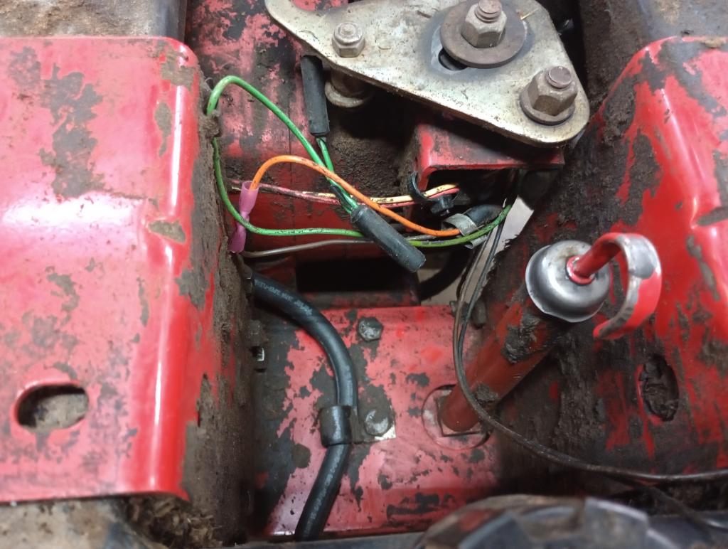

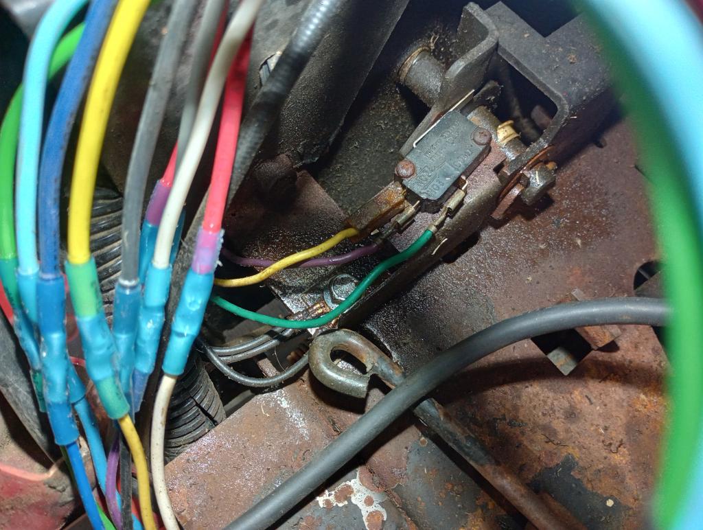

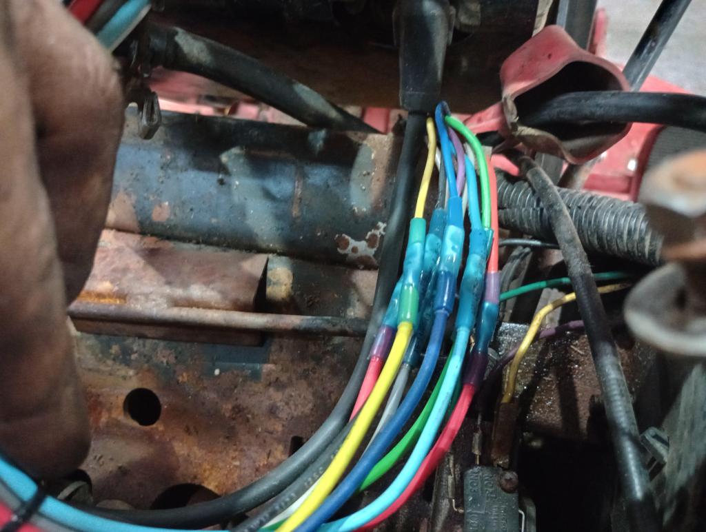

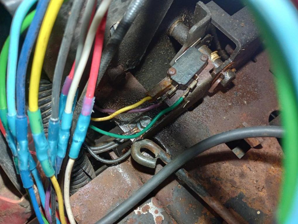

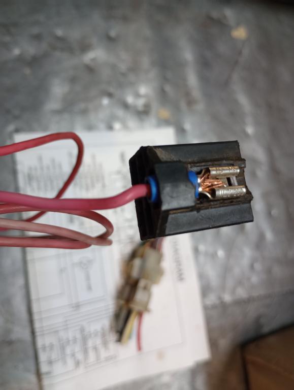

jsoluna 514 #22 Posted November 28, 2025 Lots of small things underway while we wait for the ignition parts. Would rather not be fighting any electrical issues during the engine diagnostics. First step was some wiring repair. Stage 1 of the wiring repairs is complete. Eliminated the 9 pin connector and will relocate a new Deutsch connector somewhere easier to access. Fixed the previous owner's starter wire jumper and replaced the keyswitch connector. Repaired the awful grounding spot near the PTO switch. Repaired the broken LED in the indicator module for the cylinder head temp light. Now all lights are functional, and all electrical systems behave as expected. 3 1 Share this post Link to post Share on other sites

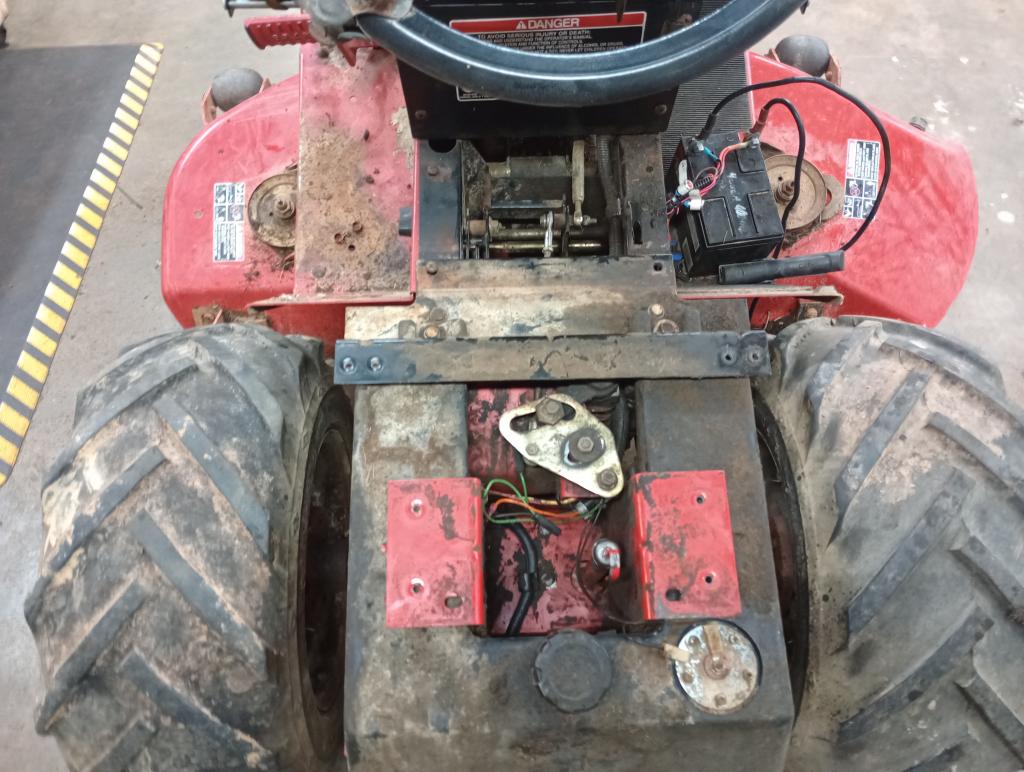

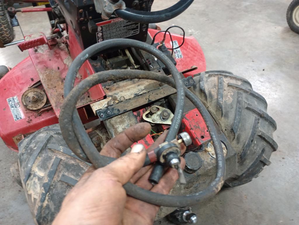

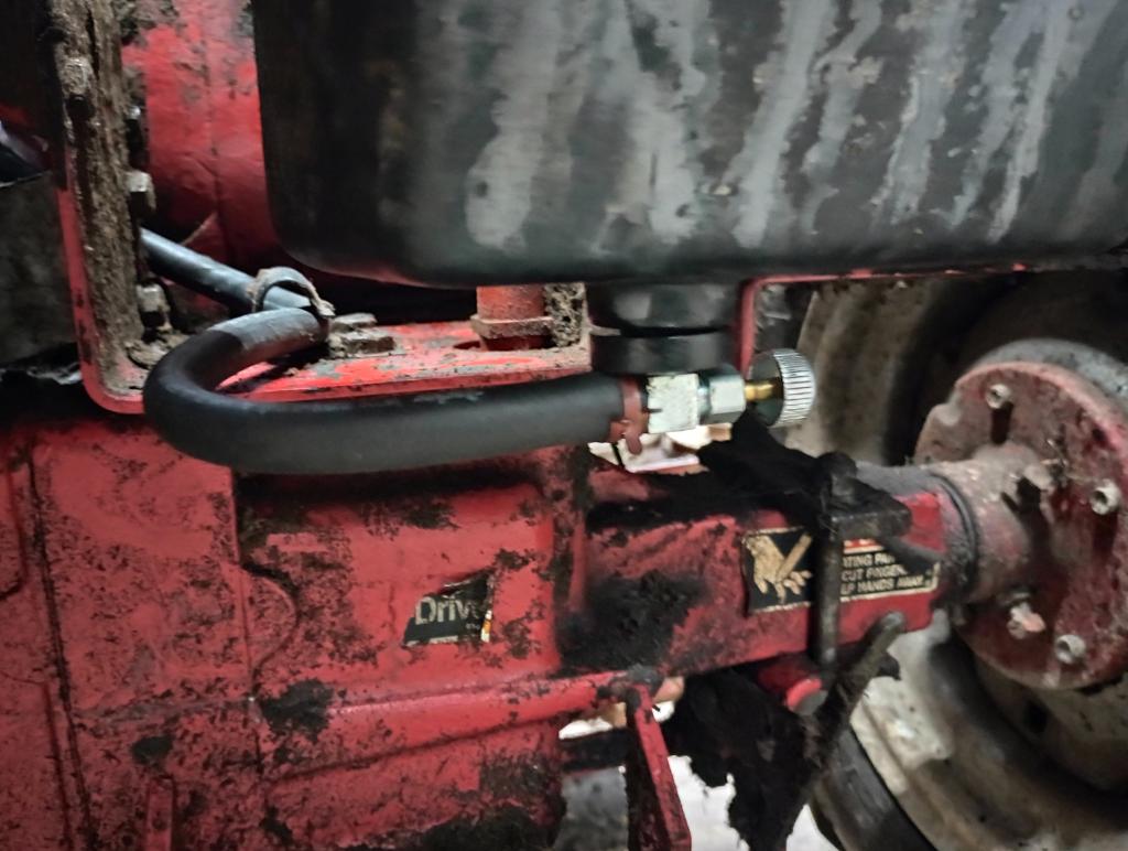

jsoluna 514 #23 Posted November 28, 2025 Next was to replace the fuel line and tank valve/grommet. The line was starting to collapse from age and being coated in oil/debris. Don't want to fight fuel system issues or electrical issues during engine diagnostics. I wanted to also access the hydro area and see if I could get any visibility into the source of the leak, so I removed the fender pan and tunnel cover. They really shoehorned the hydraulics and hydrostatic pump on these things. Crazy feat of engineering to get that all to fit. I must have removed 5 pounds of debris. It literally didn't even look like there was a machine back there, it was all debris. It has to be a nasty leak. No smoking gun yet but will leave the fender pan off during testing so I can watch for leaks. It really needs a good pressure wash, but that will come later. Gotta get it moving under its own power first. 3 Share this post Link to post Share on other sites

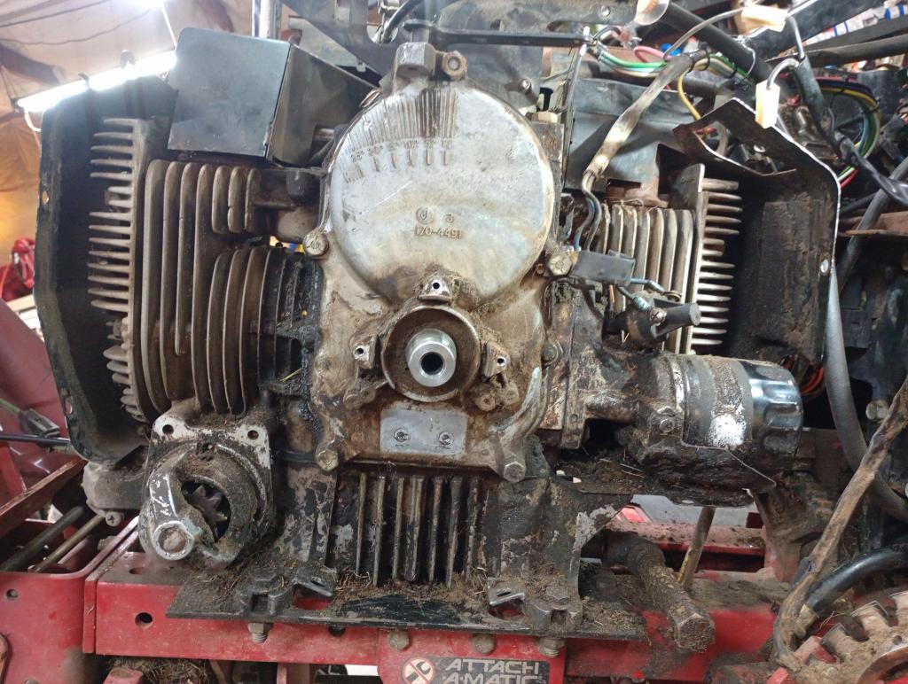

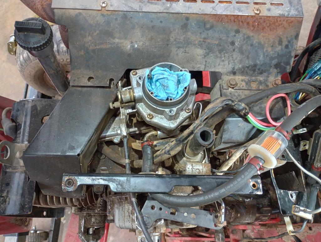

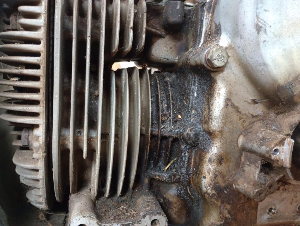

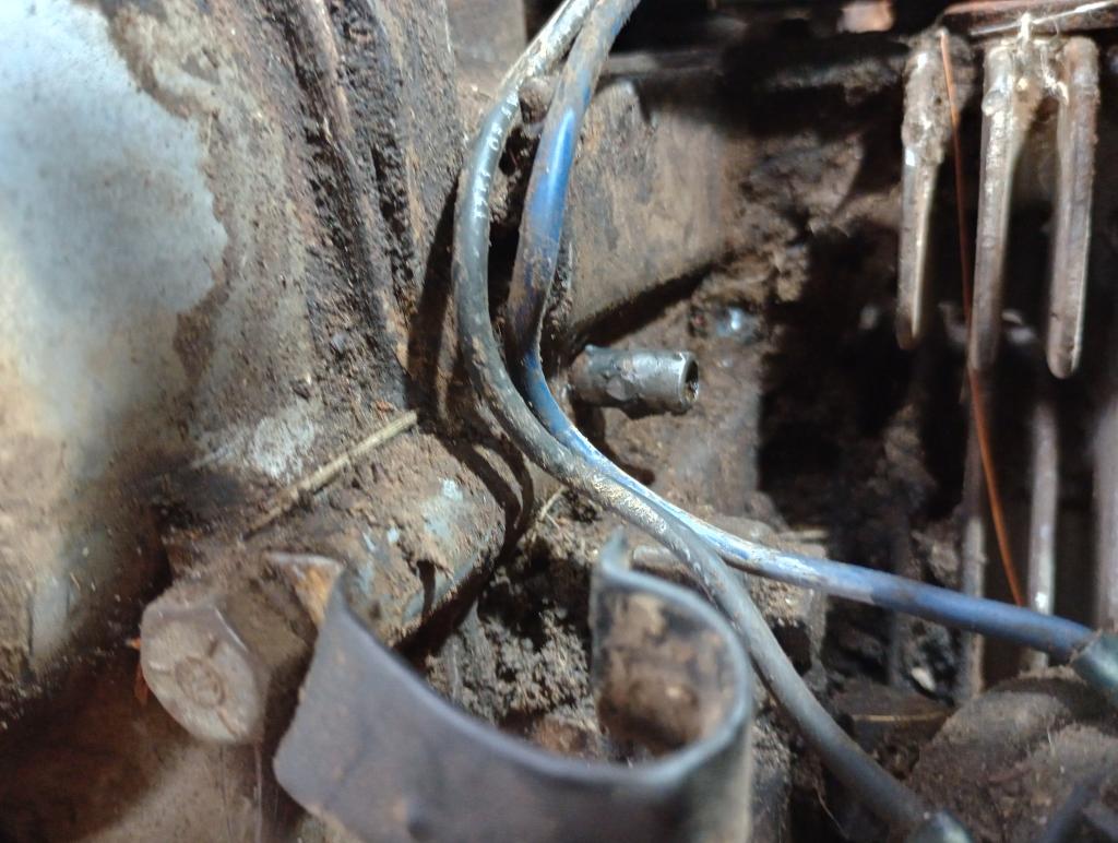

jsoluna 514 #24 Posted November 28, 2025 Next is engine prep for ignition parts replacement. Someone has been in here recently. Lots of missing fasteners, mangled tins, etc. Gonna be fun to put back together. The fuel pump pulse line had cracked and basically fell off the crankcase port when I removed the pump. Not sure how it was pumping fuel, but given the fuel smell and dilution of fuel in the oil, it was doing something. That pulse line will get replaced, obviously before the tins go back on. The engine needs a thorough cleaning, and could use a full going over, but for this stage I'm just focusing on cleaning out the cooling fins and tackling any immediate issues. If we get it running and can confirm it's a solid candidate, then we will pull the engine and do it right. The reluctor wheel for the crank trigger appears to be in good shape. Going to add some super glue to the housing in the areas that the halves meet to make sure it doesn't separate. Charging stator windings look good. There is one small area where I can see some of the coating coming off the winding, so I'll insulate that and test the stator for continuity and shorts. Crank seal seems to be doing fine, so probably going to leave it alone for now. Lots more debris to clean. This poor thing was really just beat on for the end of its life. Shame. For 2000 hours, though the Onan really doesn't look too bad. They definitely have a different approach to engineering than Kohler or Briggs or Kawasaki. They can overcomplicate things, in my opinion. Stout engine, but some of the things they do just make you wonder... One of the things that has always bugged me about the Onans is their electrical wiring sheathing they use. That stuff is tough but really inflexible and puts a lot of tension into the connection points, so I'll probably use some other sheathing wherever I can to help clean up the wiring to the stator, ignition coil, regulator, and out to the tractor connector. 5 1 Share this post Link to post Share on other sites
lynnmor 9,081 #25 Posted November 28, 2025 Pull the gas tank and clean under there, it is a good place for debris to cause rust. In my opinion a pressure washer has no place in the Wheel Horse world. I use an engine cleaner with a parts cleaning brush and then rinse with a garden hose. That small space under the engine should be kept clean so the fins under there can cool the oil. 3 Share this post Link to post Share on other sites
