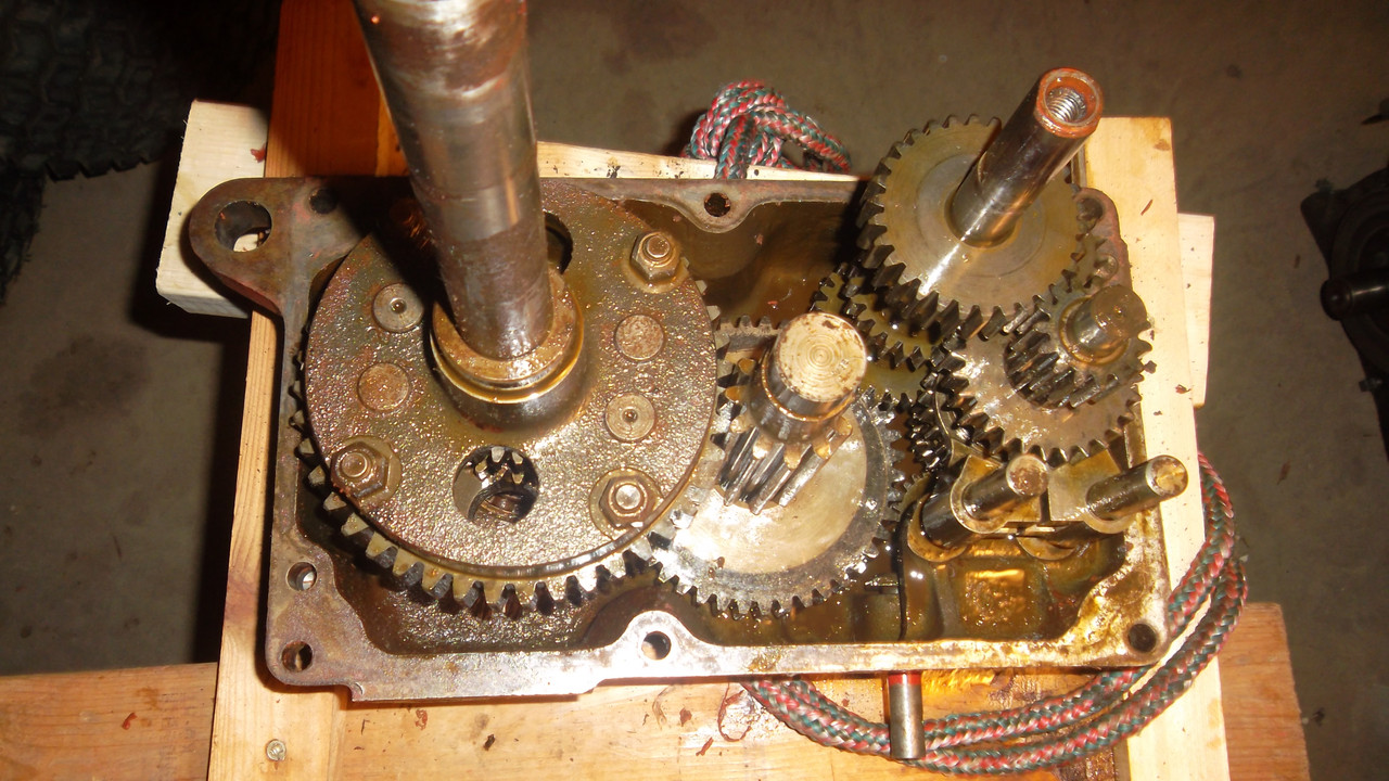

Lee1977 7,813 #16 Posted November 28, 2025 The two bolt holes where the fender bracket mounts could be where the water got in if it sat out side that long. The last 312-8 i got sat in a shed with the rook blown off, don't know how long. all the cast iron in that transmission was rusted. The worst was at the back behind the two speed shifter where the two bolts hold the fender bracket. I used a putty knife and scraped out bunches of rusted crap on both sides of the transmission. The rust on the rest of the cast iron did not look good but it was just surface rust. Share this post Link to post Share on other sites
