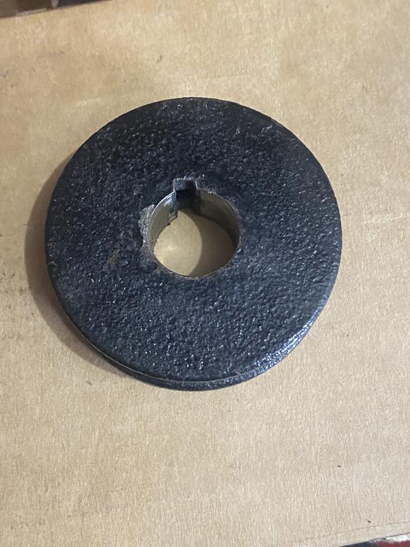

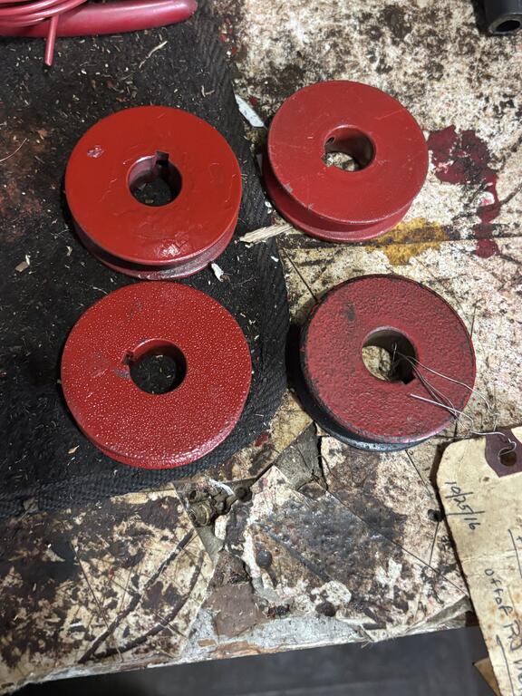

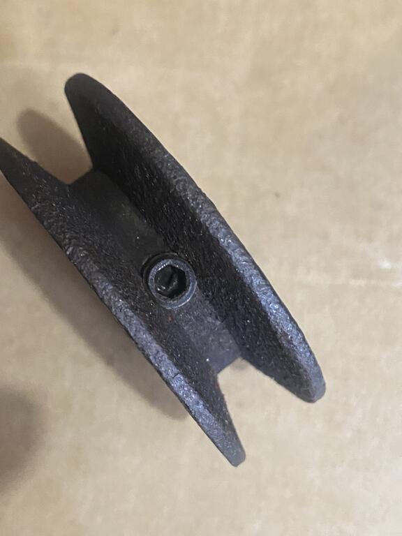

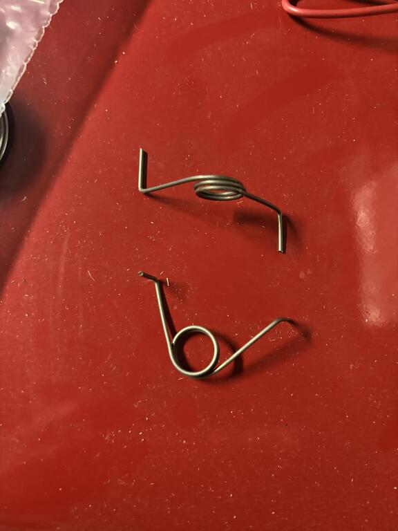

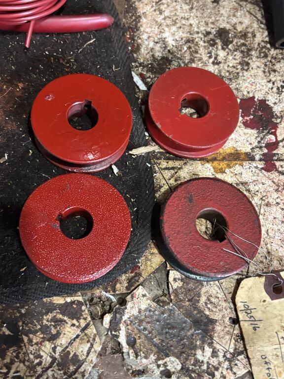

Does anybody have a picture of how this goes together with the spring it's the lift arm and does anybody have a engine drive pulley

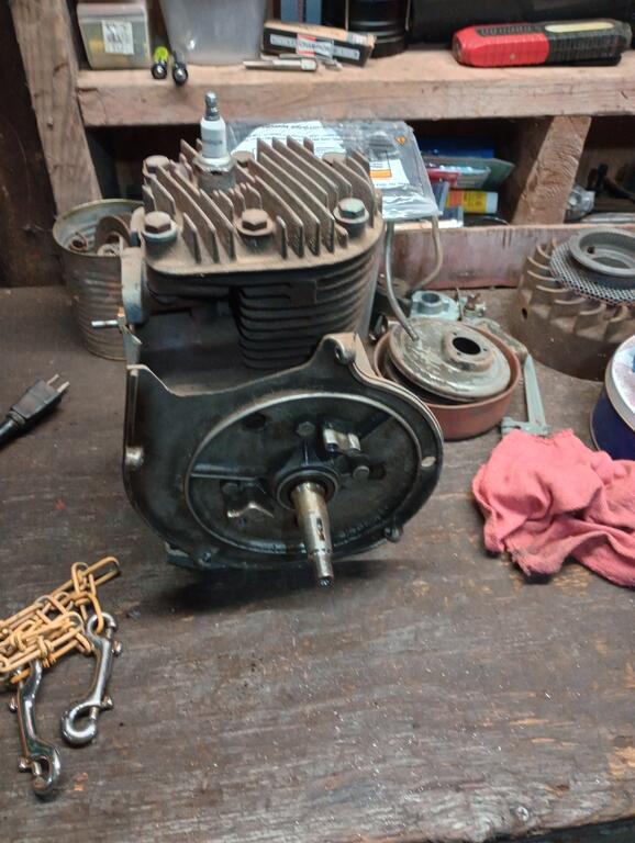

Chrishar

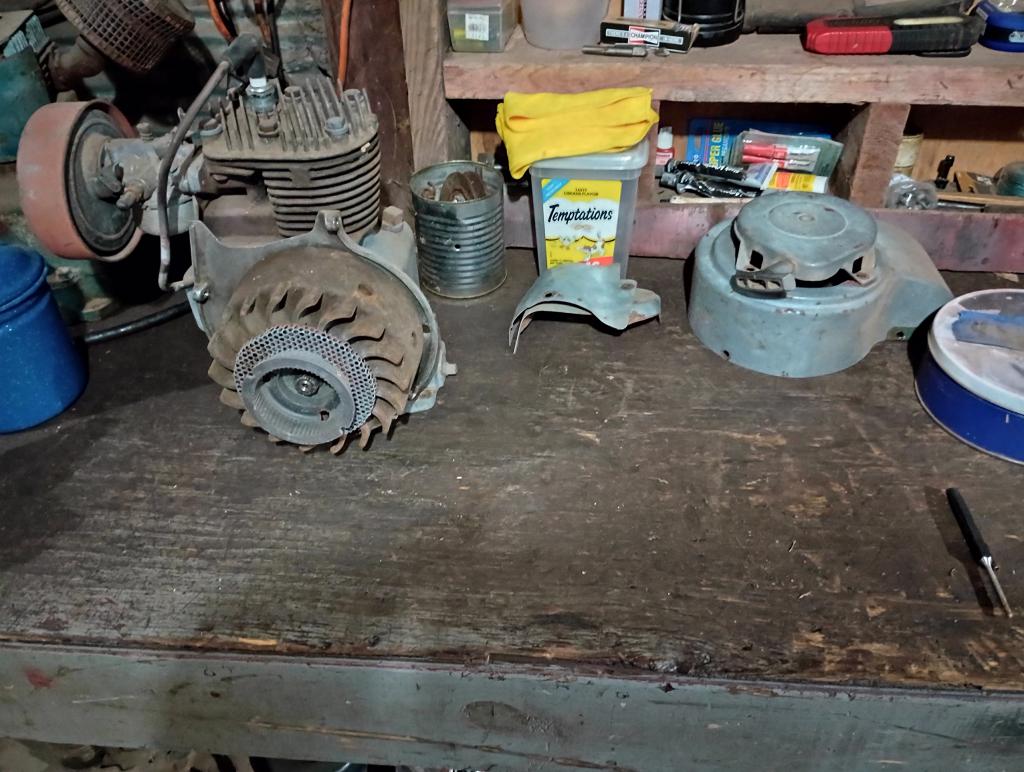

Got the engine almost all apart going to reseal the engine and paint it been working on the frame a little bit getting it ready to paint it too and waiting for parts to come in

Check with @Lane Ranger on the input pulley.

Lane Ranger
On 12/4/2025 at 8:05 AM, WHX?? said:
Or just what a PO had on the shelf??
Good luck Chris  ... :popcorn:
ok yes!  I see  my sales rep Jim Parsons has stuck again!
yes i have a couple original Wheel Horse RJ drive pulleys.   I will PM you Chrishar with the info you need.  I was surprised to find this many.

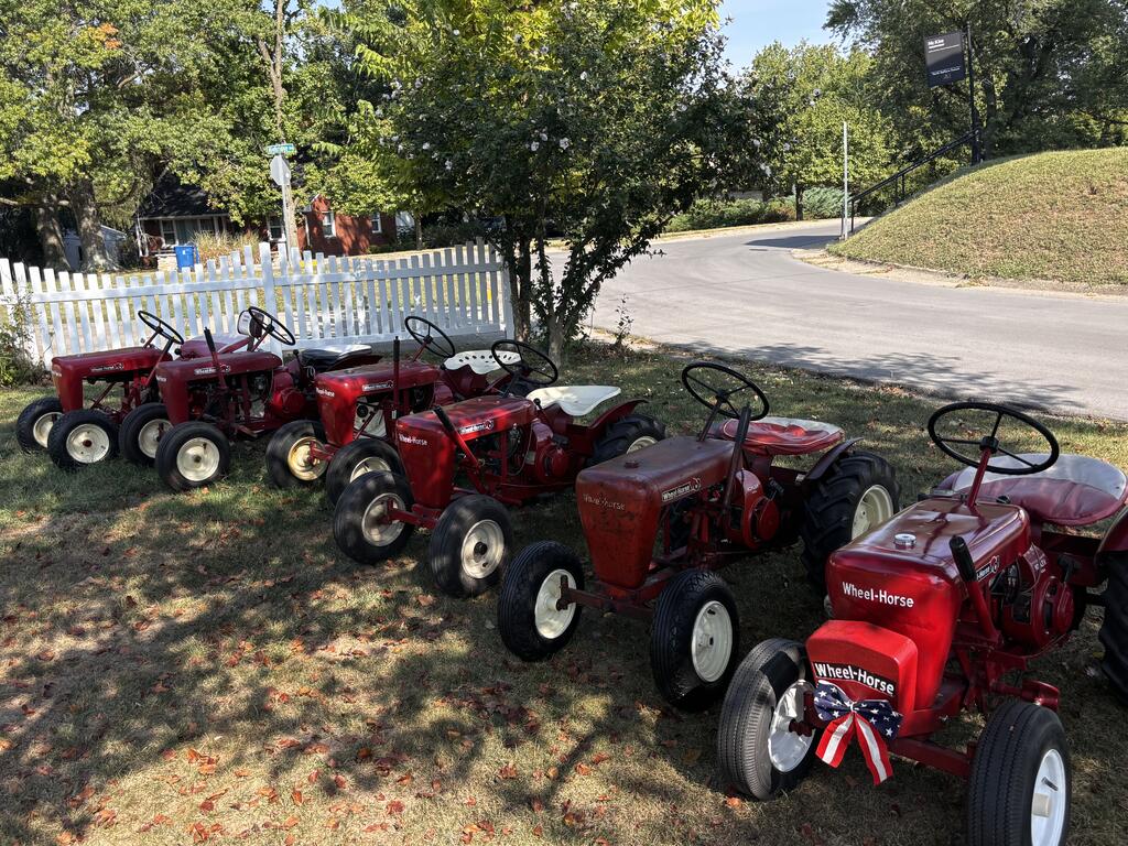

i have probably owned 15 RJs however!

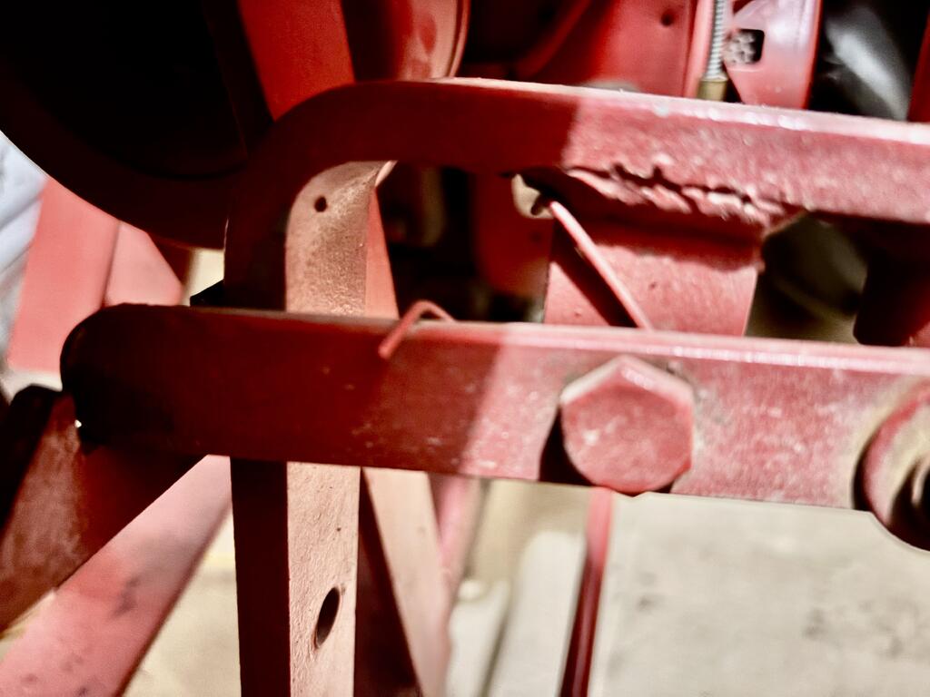

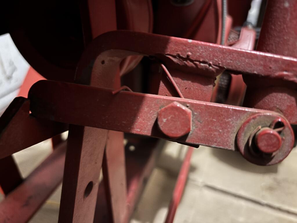

The RJ lift handle spring is a pretty simple arrangement when you see the spring removed from the lift handle.  I have two new springs and a couple of photos of the lift handle location where they get installed !   A bolt and cotter key have to be removed to place a new spring in for the lift bar to work on the lift handle.

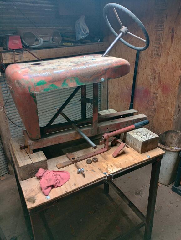

Chrishar

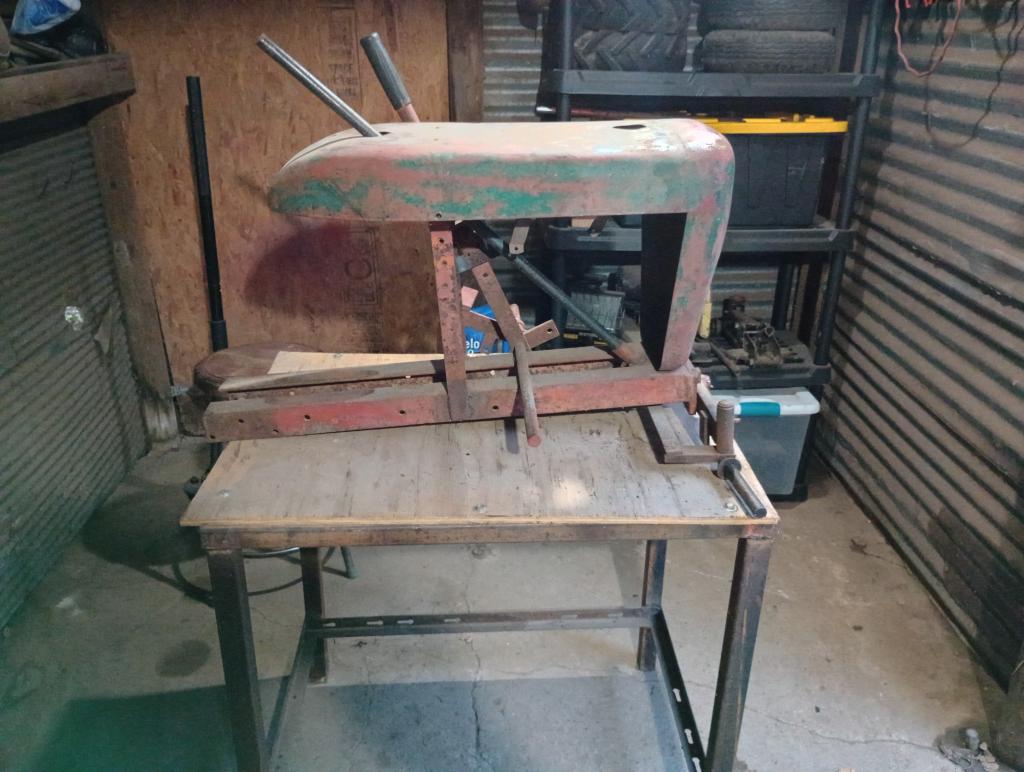

Had some time to mess with rj58 took the front axle off and put the steering wheel and shaft on that I got at the wheel horse show to make sure it work like it should now working on the lift handle assembly wants I get everything how I like it then I'll paint it

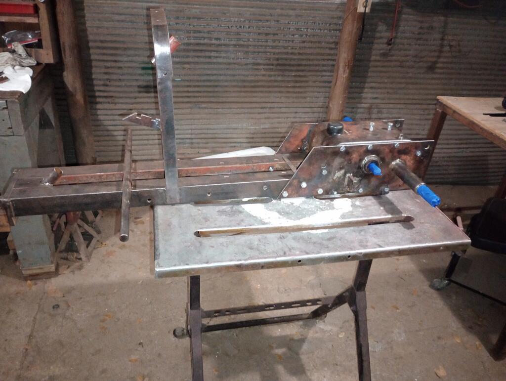

Chrishar

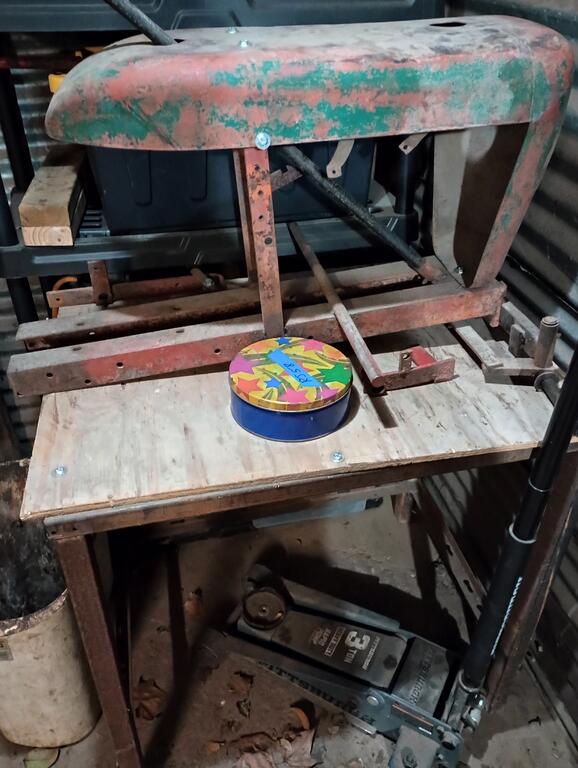

Transmission is back together just working on getting the old paint off so I can paint it and have to do some welding on the frame

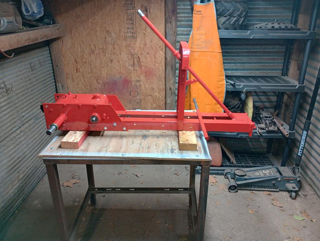

Chrishar
The frame, transmission and steering pieces are painted

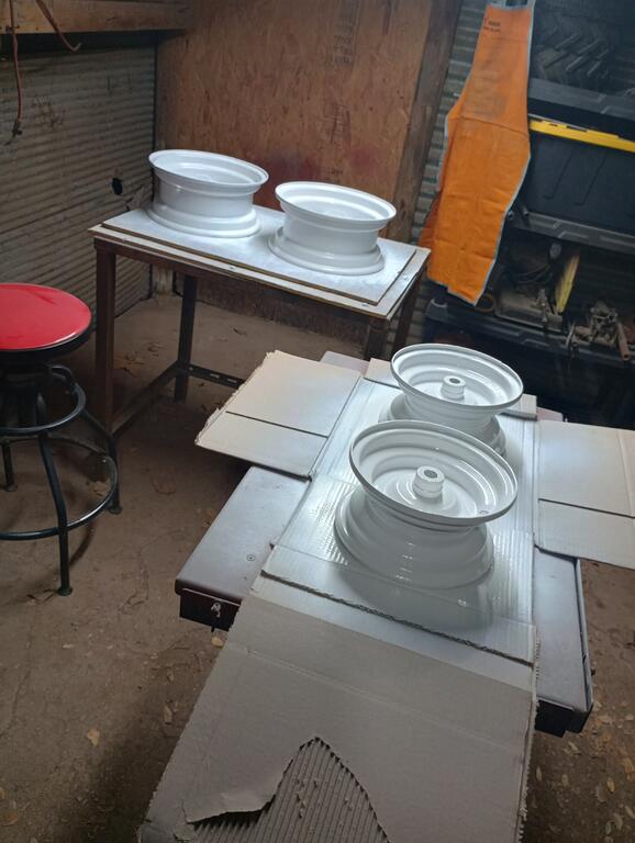

Chrishar
Rims are painted

Chrishar
The transmission and frame are together

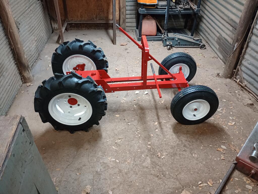

Chrishar
It has new shoes on now and it roll
