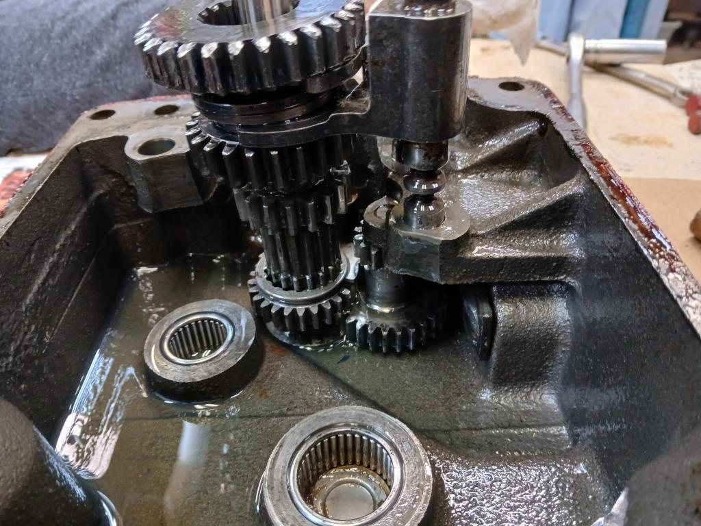

702854boy 1,106 #1 Posted November 17, 2025 We put my six speed in the tractor last night and trying to drive it, I found out that low range was another neutral but high range worked. I was able to shift through all gears in low range with the clutch disengaged and go from low to high without grinding. We took the tranny back off today and tore it apart again and found out what was wrong. Are any of you tranny experts able to see whats wrong from this photo? I might not have taken the best photo but I tried Share this post Link to post Share on other sites

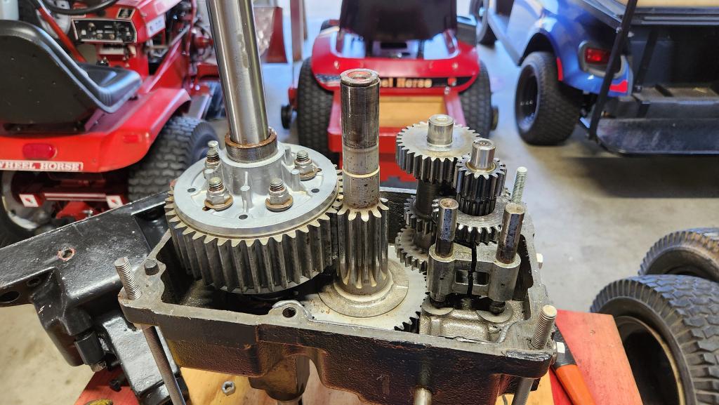

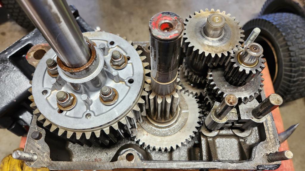

Racinbob 13,112 #2 Posted November 17, 2025 I'm feeling bad about this Howard. First the axles and now this. I ran it through all the gears during the flushing process and everything seemed fine but that was just on the bench driving the input shaft with a drill. I tried to compare your picture with the one I took and I can't pinpoint anything but they aren't the same views. @stevasaurus Steve, do you see anything? Here's my pictures again. Share this post Link to post Share on other sites

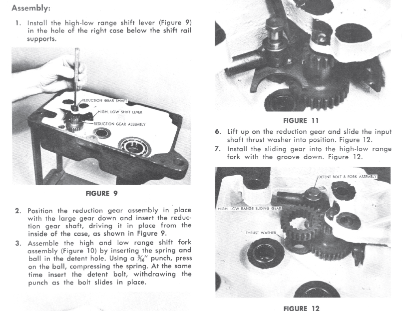

JoeM 10,163 #4 Posted November 17, 2025 Does this help? 1 Share this post Link to post Share on other sites
Racinbob 13,112 #5 Posted November 17, 2025 I'm thinking Joe is on the right track here. Just pull things out, maybe even everything, and step by step put it back together. If the problem can be identified most likely you'd have to do that anyways. Share this post Link to post Share on other sites
702854boy 1,106 #6 Posted November 17, 2025 26 minutes ago, Racinbob said: If the problem can be identified most likely you'd have to do that anyways. We had identified the problem last night because of dad's memory from watching a bunch of videos, I was just curious to see if anyone could see what we found was wrong Share this post Link to post Share on other sites
ineedanother 2,818 #7 Posted November 17, 2025 12 hours ago, 702854boy said: We put my six speed in the tractor last night and trying to drive it, I found out that low range was another neutral but high range worked. I was able to shift through all gears in low range with the clutch disengaged and go from low to high without grinding. We took the tranny back off today and tore it apart again and found out what was wrong. Are any of you tranny experts able to see whats wrong from this photo? I might not have taken the best photo but I tried Looks to me like the cluster gear is assembled incorrectly. I could be wrong though... Share this post Link to post Share on other sites
702854boy 1,106 #8 Posted November 17, 2025 (edited) 5 hours ago, ineedanother said: Looks to me like the cluster gear is assembled incorrectly. I could be wrong though... If that's the assembly of gears that is on the input shaft you would be right, the bottom gear for the high shift fork was installed upside down, @Racinbob, we think it was the dude before you that took it apart and didn't put it together right because you didn't dig into any of that. But anyway, it was a free fix, and we learned how it all goes together and learned how it works so I'm not complaining Edited November 17, 2025 by 702854boy 1 Share this post Link to post Share on other sites
Racinbob 13,112 #9 Posted November 17, 2025 32 minutes ago, 702854boy said: If that's the assembly of gears that is on the input shaft you would be right, the bottom gear for the high shift fork was installed upside, @Racinbob, we think it was the dude before you that took it apart and didn't put it together right because you didn't dig into any of that. But anyway, it was a free fix, and we learned how it all goes together and learned how it works so I'm not complaining You're right, I saw no reason to tear into it any further. If I had noticed (and I should have) the axles being wrong I likely would have because I would have changed them. Howard, I love your attitude and desire to learn. @stevasaurus if you ever decide to retire as the guru here this young man will be waiting in the wings. 1 Share this post Link to post Share on other sites
