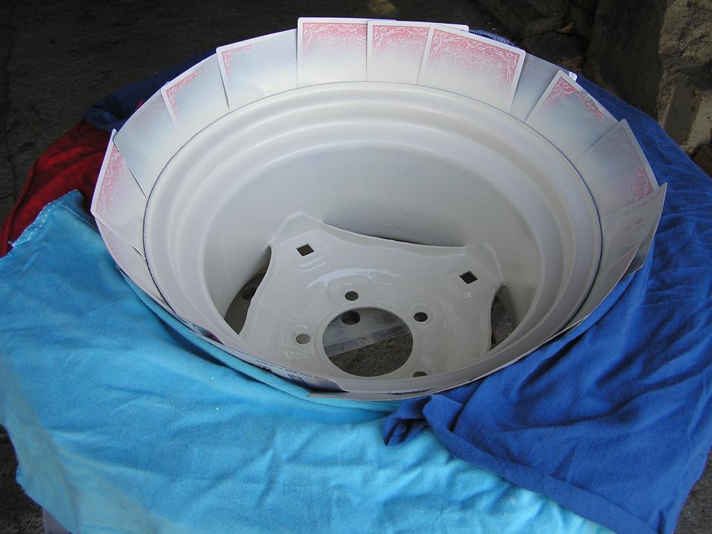

Painting the rims - better to mount your tires first, inflate them & check the pressure after a couple of days to see if there are any issues that require dismounting them....
If all is fine, then use the playing card trick on uninflated tires. Works just fine...

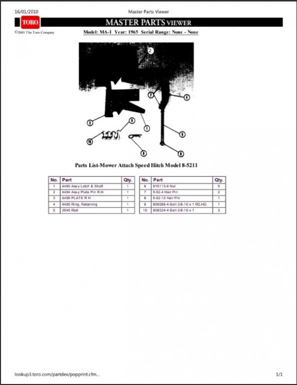

an MA-1 quick attach system is used for the blade.  Is the mechanism circled in red an MA-1 quick attach?
I've never heard it referred to as MA-1, but don’t take that to the bank.
What is circled is often referred to as the “mid-hitch” and that one is of the early style. It uses an R-clip to lock the latch in either its open or closed position. Later versions used button/spring/disk lock system and an external lever for open/close that was a bit easier to operate.
The grader blade in the attached PDF is, I believe, the first one WH sold. It would work just fine with your tractor’s mid-hitch. Be aware that to adjust that blade’s rotation angle you must reach underneath the tractor to lift a latching pin and then reposition the blade. Later models had a release that you could operate with your foot while seated and use your other foot to reposition the blade. (Also note that the WH 50” blade, if you come across one, will not work--it is for long frame tractors only.)

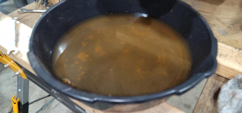

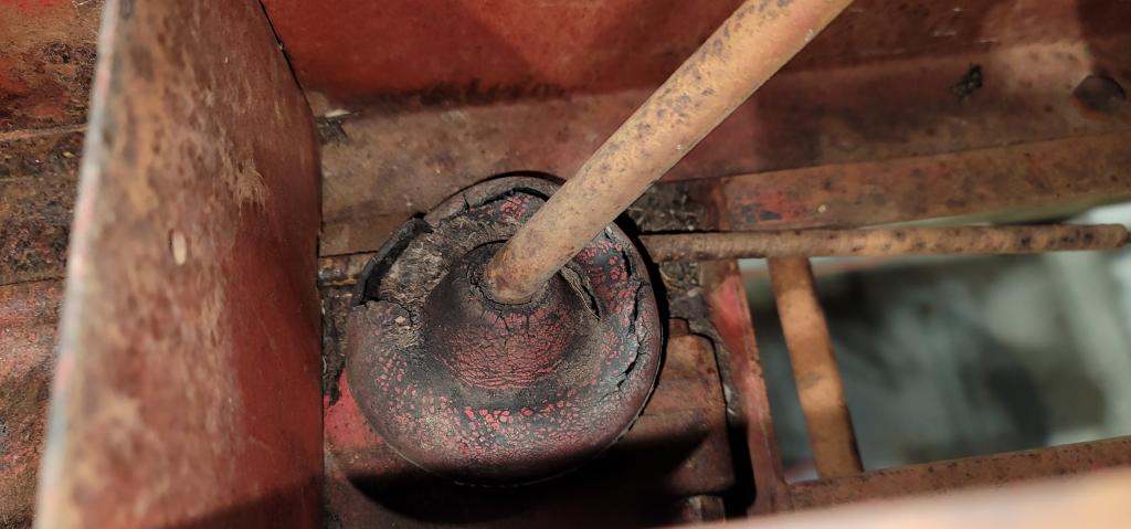

Well....it looks like it's going to be a while before I need to worry about things like tires and wheels or a grader blade.  I decided to drain the oil in the gearbox to see just how much was actually there and it's condition and do a refill.  To say I was surprised to find that it only had water in it would be an understatement.
Here's a short video showing the last of the water draining out of the gearbox.  I was so surprised by this that I didn't start taking the video until it was almost done draining.  The water was clear and there was NO oil in the gearbox at all.  Something else I found was the shifter will move side to side and will move forward and back a little on each side but will not go into any gear, I even tried rotating the input shaft to see if that would help.
I'm sure the water came in through the rotted boot on the shifter.

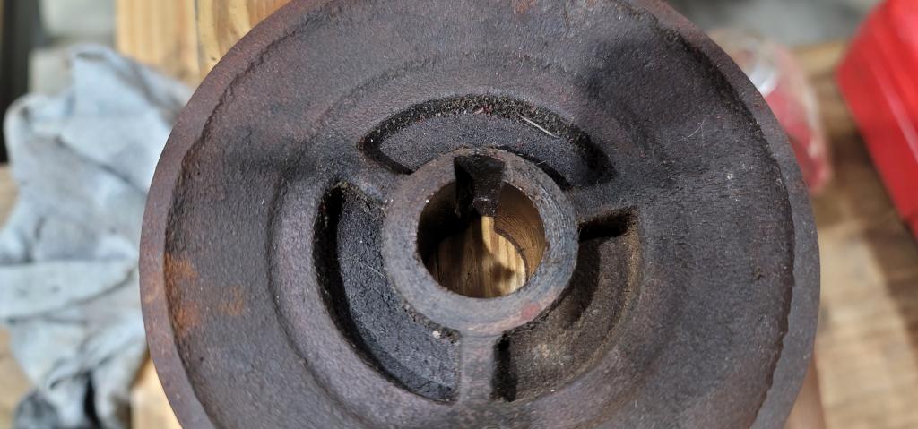

Another minor problem is the gearbox output shaft pulley is badly worn so I'll need to replace this pulley as well.

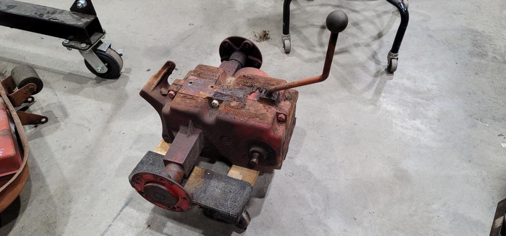

After discovering the water issue I went ahead and removed the gearbox from the chassis.  Any suggestions on how to start the tear down to see just how bad it is inside and what to look for?  Any thing to worry about when splitting the case?

This is why I was thinking the 656 used the MA-1 speed attach.  It looks like what is on mine.
Mine uses the R-clips.
Thanks for the info.

OK - where to begin....

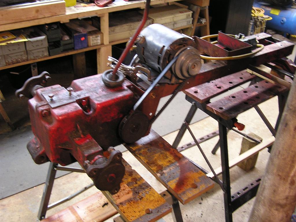

Did any metal pieces come out with the "liquid"?? Roller bearing needles or bits of gear teeth?? If so - expect a costly rebuild.
But first - to drain ALL the liquid, you need to elevate the front of the Unidrive about 45 degrees to allow the fluid to go over the hump inside....
Then you may wish to flush it  - some folks use Diesel fuel (me), others kerosene or ATF.
Then - the first hurdle - looks like the cast slot sitch is rust-frozen in place. Both the hitch and all of the 3/4" pin must be removed before splitting the case.

My flushing setup...

BradKahler
There was nothing in the water, it was crystal clear and nothing in the pan.
Thanks for the tip on elevating the unit to finish draining it, I would have had an oily workbench otherwise.
I'm not sure flushing will do much in this case because it's not in gear so only the input shaft is turning, or am I missing something?

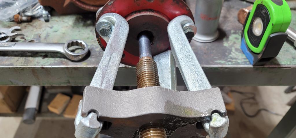

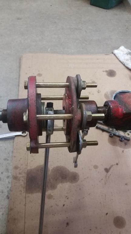

BradKahler

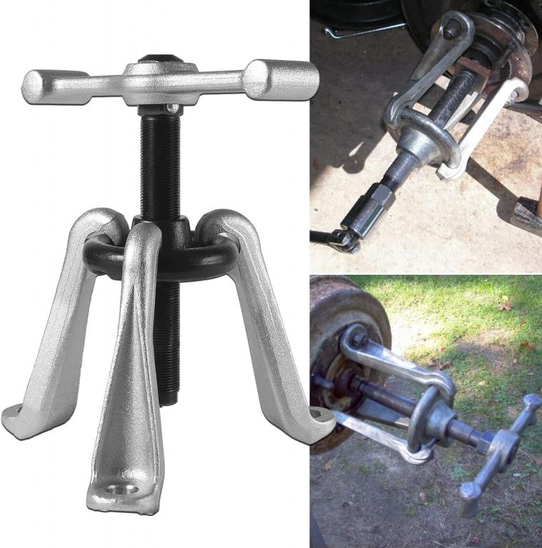

Quick question.  Is a puller like this suitable for pulling the hubs off the axles?  At the moment it's the only puller I have that is large enough.
  • Excellent 1
ri702bill
You will also want to remove the hubs - first to have more room to get the hitch pin out, second to get the transmission apart.
Look up from under the hitch to see if there is a gap on both sides of the case where you can cut thru the pin with a Sawzall. Then you only have to deal with the pin in the case halves. Numerous threads have been posted on this. DO NOT try to drive the pin out thru the thin half - bad things can happen breaking the casting!!
ri702bill
Best not to use that on the thin "star" style hub... You need full contact from behind the flange - AFTER you remove the grub screw. Again, plenty has been posted on this very subject....

BradKahler
My hubs are round.  Does that make a difference with the puller that I have?
WHX??

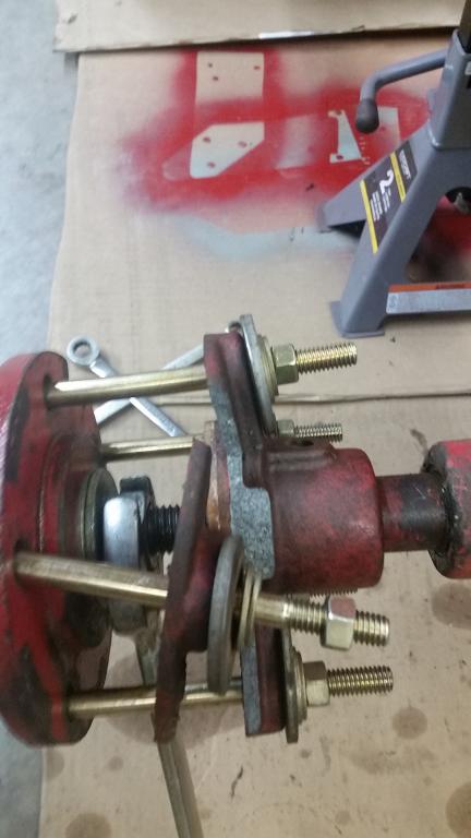

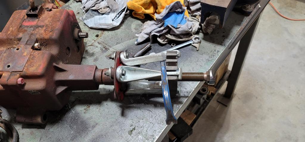

Ideally a bearing collar behind the very inboard side of the hub. Pic below is another method but yes as mentioned be carful since you will have the more fragile "star" hubs. Being a neub you probably don't have a spare junk hub tho. You can try the puller you pictured but with extreme caution. If it don't feel like its gonna go lightly don't push it. 2nd pic ask me how I know. :hide:
My way now is to try and get what appears to be the easiest one to get off. Then split the cases which allows one to disassemble the differential and get the other axle out and to a press.
getting hitch pins out and hubs off are a rite of passage here.
Any issues STOP ...set the wrench down and slowly step away ...  and use a shout out. :lol:
Edited by WHX??
  • Like 1
  • Thanks 1
Handy Don
Not really. Round are somewhat stronger but not all that much. The force simply must be applied very close to the shaft. Remember this is a casting, not a forged item. A rare few have made 5-bolt pullers and had success.
Many, many, many posts here on the adventures of hub pulling. Pretty much everyone considers it a rite of passage.
Edited by Handy Don
  • Like 3
  • Thanks 1

BradKahler

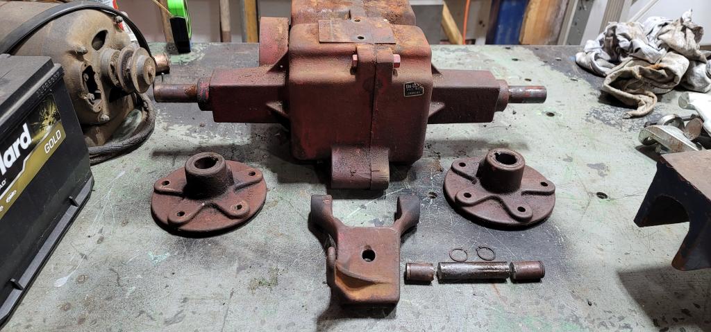

I believe I have successfully completed level 2 of the "The Wheel Horse Devil's Trifecta" :D
I decided to tackle the hitch first.  I knew from tinkering the pin would rotate inside the transmission casing so I only had to deal with the hitch itself.  In the hopes of just hammering the pin out with a punch, I hosed everything down with PB (it's all I can find locally) and then heated each end with a propane torch.  My acetylene bottle is empty and the local dealer doesn't currently have my size in stock, so I was stuck with MAPP gas.  After heating I doused the pin with PB again and then with a hammer and brass punch I was able to get the pin to move the pin a little less than 1/16" in the hitch.  It didn't seem to want to move any more after that so I got out my 4-1/2 grinder with a cutoff wheel and proceeded to cut the pin out.  Other than a few light scraps on the hitch itself :unsure: it went smoothly.  The remnants of pin in the transmission case and hitch came out using the brass punch and hammer.   One down, one to go.
I was able to remove the hubs from the axles using my 3 legged puller.  Based on all the comments I was NOT going to use any sort of brute force method to turn the screw on the puller.  Needless to say I was quite surprised when using the pry bar and wrench shown in the picture, with very little effort I was able to remove the hubs.  There have been times when I've had to pull harder to remove a spark plug than I did with these hubs.  I don't know if it helped, but I had been soaking them for several days with PB.

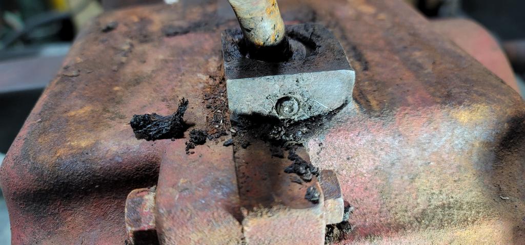

Next up is to tilt the transmission to drain the rest of the oil out and then try to split the transmission in two.  While looking over the shifter arm I noticed what appears to be a bolt on the forward edge of the casing.  Is the head of the bolt broken off, or is there something I'm not understanding yet.  It is now time for me to delve into the transmission manual to see how things go together (or apart that is).
I really want to thank ri702bill, Handy Don, WHX??, 953 nut for helping me get this far without breaking anything!  Sometimes knowing ahead of time what not to do can help make the difference between success and failure.
As for reaching level three, the steering wheel.  I'm really hoping I don't have to attempt to reach that level :lol:

Ed Kennell
That is a dog point set screw that fixes the shifter rod in place.  Loosen the lock nut and back the set screw out to remove the shifter rod.
  • Like 2
ri702bill
Yup, sorry to say, but the special full dog point 1/4-20 shifter retainer screw IS broken off and must be dealt with...
The unbroken one would protrude out of the boss by about 3/8" to accept a hex nut to set the adjustment.
SOMETIMES, you can get lucky drilling it with a left-handed bit, the size for a screw extractor, aka Easy-Out.
Your next task!!!
Edited by ri702bill
  • Like 2
Ed Kennell
:text-yeahthat:  I missed that pic  showing the broken set screw.  Someone overtightened the lock nut?
  • Like 1
