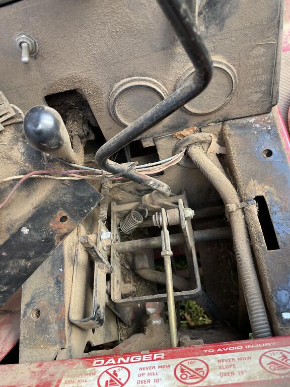

heysavoy 22 #1 Posted November 15, 2025 I have a 1990 wheel horse classic model # 31-12KE01 with a hydrostatic transmission. I've noticed recently when I put it in reverse, it seems to hesitate to want to go backward. I also found I needed to keep my hand on the gear or it would sometimes abruptly stop. Today I had a scary experience when it lunged unexpectedly to the point the front tires came completely off the ground and almost flipped me over backwards. I took the middle plate off at the gear shift (see picture below) trying to figure out what was wrong and didn't see anything that looked out of order but honestly I don't know what I am even looking for. When I've had other problems, my only saving grace has been this forum which has always been there to help me when I needed it. And I really need some help now because I'm in the middle of leaf season with over an acre of yard and 25 hardwoods. I live in the Charlotte NC area but don't know anyone who works on a wheelhouse especially a 1990. Thanks in advance for any help someone could offer. I love my old tractor and was hoping it would last me another 10 years. Share this post Link to post Share on other sites
Ed Kennell 46,793 #2 Posted November 15, 2025 Check the cam plate and linkage under the seat. 5 Share this post Link to post Share on other sites
WHX?? 57,629 #3 Posted November 15, 2025 ...then give it a bath and lube job. That kind of dirt build up can wear away pivot points quickly not to mention plugging cooling fins. Remove the fender pan and clean thoroughly. Inspect & adjust per the manual. Cleanliness goes double for hydros. 7 1 Share this post Link to post Share on other sites

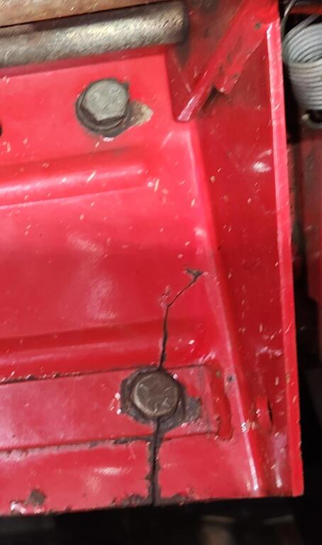

953 nut 68,134 #12 Posted November 16, 2025 Take a look at the "F Plate" where the transaxle bolts to the frame. If it is cracked it will allow the transaxle (and that end of your shift linkage) to move around. It wouldn't take much movement to cause what you are experiencing. I have attached a picture of an F Plate. The cracks could be in the plate or where it is welded to the frame. 1 Share this post Link to post Share on other sites

Brockport Bill 2,448 #16 Posted November 16, 2025 5 hours ago, 953 nut said: Take a look at the "F Plate" where the transaxle bolts to the frame. If it is cracked it will allow the transaxle (and that end of your shift linkage) to move around. It wouldn't take much movement to cause what you are experiencing. I have attached a picture of an F Plate. The cracks could be in the plate or where it is welded to the frame. beware the tranny frame plate crack as noted Share this post Link to post Share on other sites
Ed Kennell 46,793 #17 Posted November 16, 2025 21 hours ago, heysavoy said: So I assume I have to remove the seat to do so? To properly clean the cooling fins on the hydro...YES. To inspect the cam plate and linkage for wear and proper functioning...NO. Just flip the seat forward to access the cam plate thru the hole in the seat pan. 2 Share this post Link to post Share on other sites

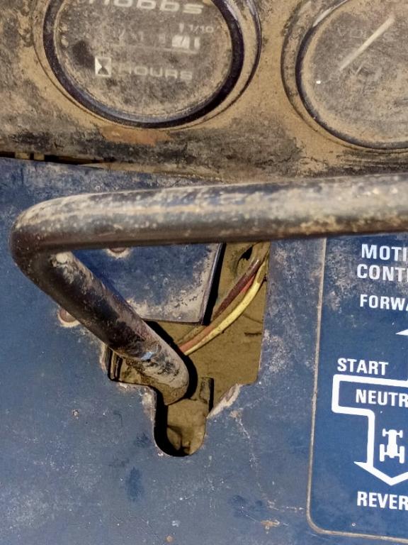

heysavoy 22 #23 Posted November 17, 2025 Is it possible there is too much play in this bracket allowing the shift stick to jump between gears? Share this post Link to post Share on other sites
lynnmor 8,966 #24 Posted November 18, 2025 2 hours ago, heysavoy said: Is it possible there is too much play in this bracket allowing the shift stick to jump between gears? There are no gears, take that rear fender off and do the cleaning, then you will see that the cam plate moves the internals in a way that controls the speed and direction. That cam plate has a friction adjustment so that it stays where you put it, that needs to be clean and dry, it is the only thing that should have no lubrication. Often that needs to be disassembled, sanded and cleaned. 1 Share this post Link to post Share on other sites
