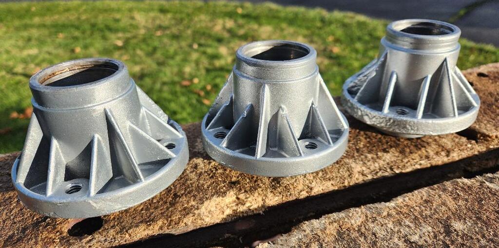

Easton Rich 1,238 #10 Posted December 28, 2025 I know this is an old thread, but I was wondering if 36” RD and 42” RD spindles were interchangeable? Thanks Share this post Link to post Share on other sites
kpinnc 18,296 #11 Posted December 29, 2025 18 hours ago, Easton Rich said: know this is an old thread, but I was wondering if 36” RD and 42” RD spindles were interchangeable? Thanks At least the ones I have seen, they are not interchangeable. The 36 inch deck spindles are much shorter (pulley to blade) than the 42 and 48 inch. Not sure about the bolt pattern. Share this post Link to post Share on other sites
Brockport Bill 2,371 #12 Posted December 29, 2025 18 hours ago, Easton Rich said: I know this is an old thread, but I was wondering if 36” RD and 42” RD spindles were interchangeable? Thanks the 36 spindle is notably "shorter" - considerably different spindle housing unit than the 42/48 - i am rehabbing a 36 deck now - - here is photo of the 3 housings Share this post Link to post Share on other sites
