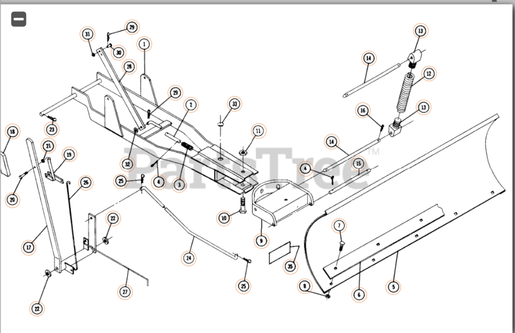

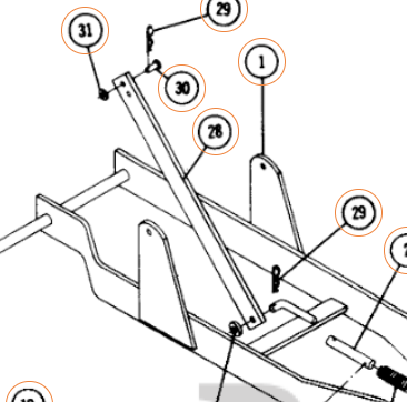

tstab 2 #1 Posted November 11, 2025 Hey all, curious if anyone knew any specs about this lift bar fo the 6-71-21 Dozer Blade. I managed to track one down for my charger 8 but it did not come with the lift bar. I know the part number is Toro 104003 but idk anything about length or what it actually looks like outside of the diagram. I'm trying to avoid making one so if anyone has one I can buy or if you know if there is one that will work on wheel horse parts give me a hollar. I know I can fab one up but I just am very limited on (reno'ing my house) Share this post Link to post Share on other sites

rlrnot 39 #4 Posted November 17, 2025 Just to verify, this refers to Item # 28 in the manual. 1 1/2 by 3/8 bar stock. OAL = 22 7/8. All dimensions are from end with (2) 27/64 holes. 23/32 to ctr. of first hole. 1 11/32 to ctr. of second hole. 21 27/32 to ctr. of 11/16 hole. My bar is straight. I think this gives you the dimensions you need. If not, let me know. Share this post Link to post Share on other sites
