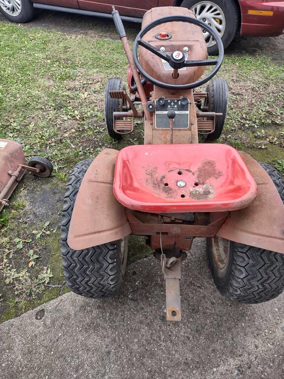

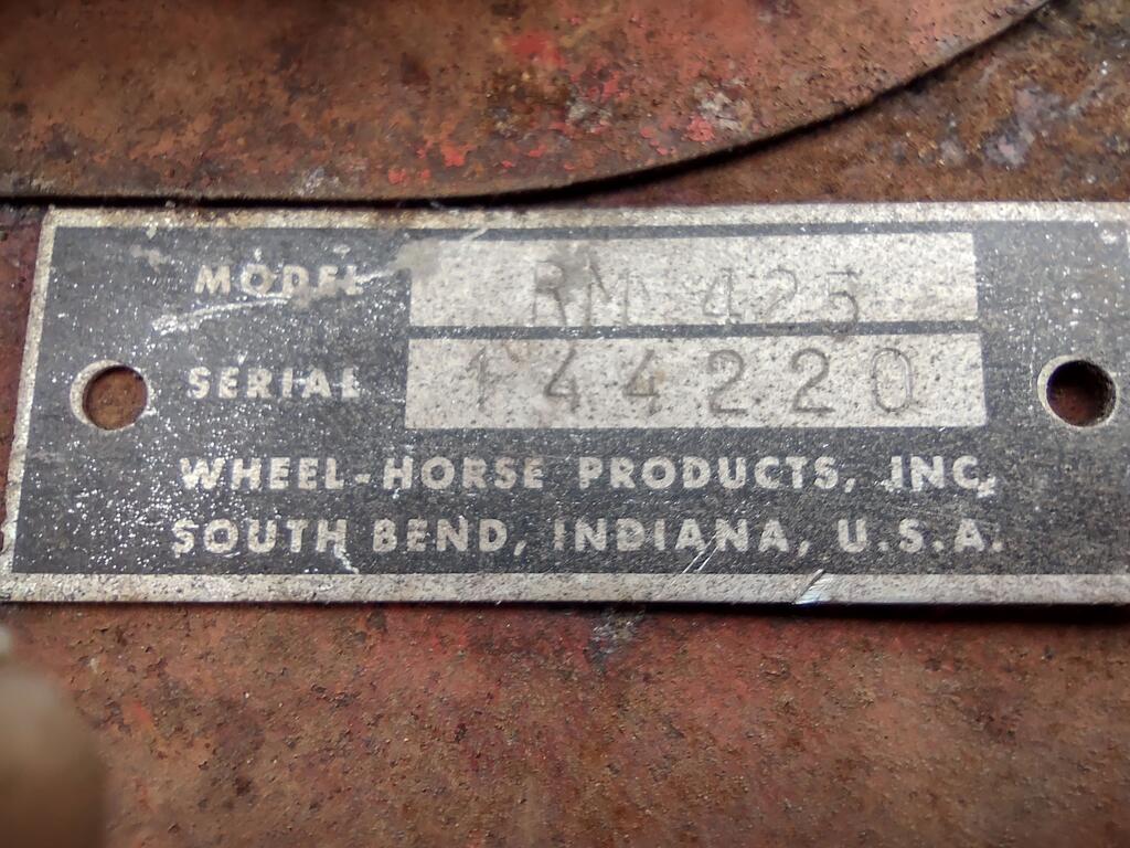

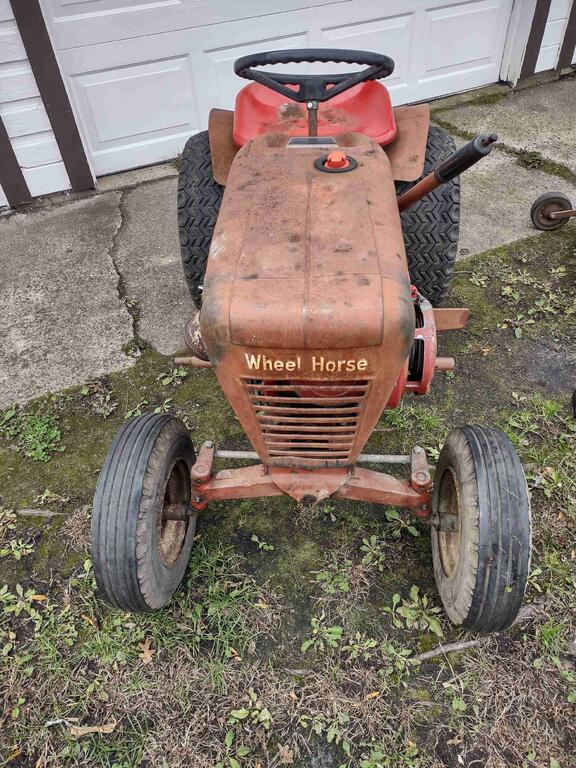

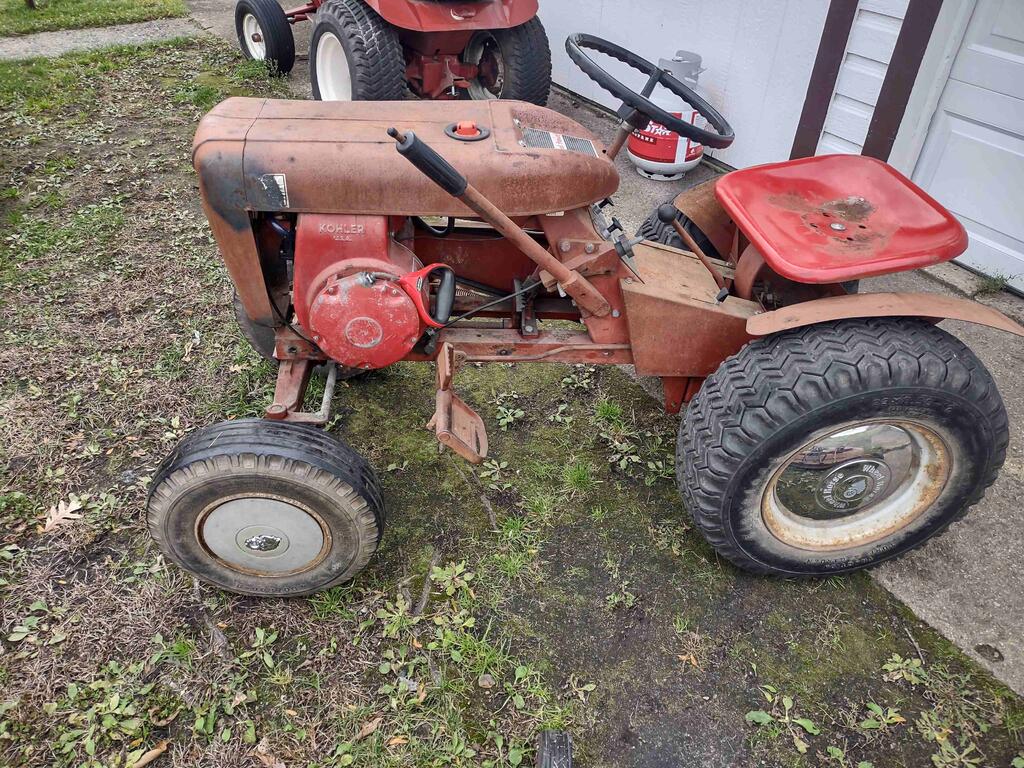

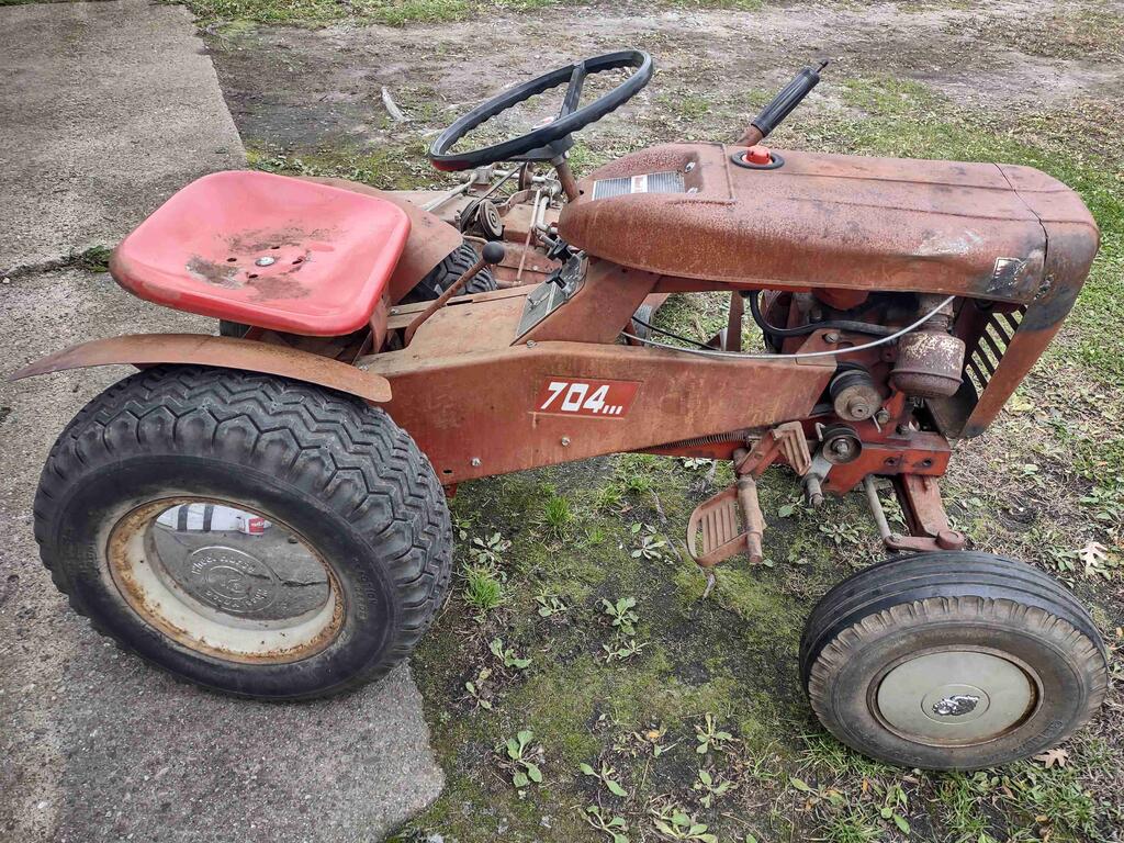

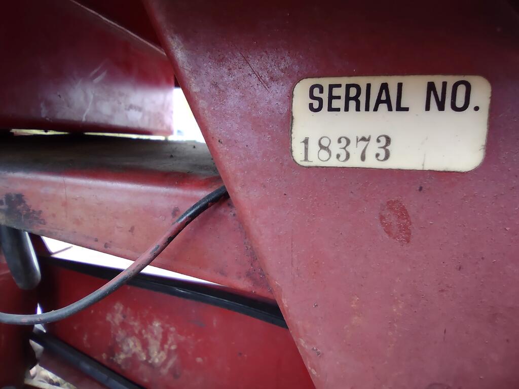

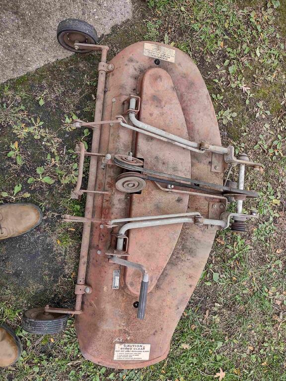

Achto 31,416 #1 Posted November 8, 2025 Added another round hood to my herd. I've always liked the looks of the round hoods, but was not a big fan of the square aluminum gas tanks. For this reason I had been looking for a 704 to add to my herd. @WHX?? alerted me to one that for sale on Face Book close by and was willing to do the FB work to get me hooked up. Thanks Jim !! Pics of the newest addition. PTO does not look correct to me. The gas tank that is in it is not right, but I have the correct one. Anyone see any thing else out of place please let me know. I also got this deck with it. It looks in pretty good shape but is not on the implement list for the 704. Anyone know off hand what it should be mated to? One more of my bucket lister's obtained. Only ? more to go. 3 19 Share this post Link to post Share on other sites
squonk 45,888 #2 Posted November 8, 2025 (edited) Wrong PTO and deck, Wrong rear tires and wheels, Should be 6-12's Loved my 704 until @clueless pried it away. I'll never forget that day. It felt like I sold one of my beloved pets! Edited November 8, 2025 by squonk 1 3 1 1 4 Share this post Link to post Share on other sites
Achto 31,416 #3 Posted November 8, 2025 (edited) 11 minutes ago, squonk said: Wrong rear tires and wheels, Should be 6-12's I did get a usable set of 6-12 Silver Town snow tire treads on rims with it. Edited November 8, 2025 by Achto 4 1 Share this post Link to post Share on other sites

953 nut 64,843 #5 Posted November 8, 2025 5 hours ago, Achto said: One more of my bucket lister's obtained. Only ? more to go. Nice find, only thing I can find fault with is those hub caps, they gotta' go, other than that it looks great. 1 Share this post Link to post Share on other sites
Achto 31,416 #6 Posted November 8, 2025 1 hour ago, 953 nut said: only thing I can find fault with is those hub caps, they gotta' go I agree. I'm not real big on hub caps. I have a nice set of the later metal ones, just have a hard time covering up nicely painted rims. On the other hand.... If I had a nice set of the baby moon style with the painted on them, I just might have to pick one of my restored round hoods to put them on. 3 1 Share this post Link to post Share on other sites

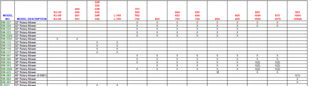

WHX?? 55,830 #7 Posted November 9, 2025 Supposed to be for a 1055 or 1075. Way to big for a 7 HP. Note that serial number is in the list already. . 1 1 Share this post Link to post Share on other sites
WHX?? 55,830 #8 Posted November 9, 2025 (edited) 7 minutes ago, WHX?? said: Supposed to be for a 1055 or 1075. Way to big for a 7 HP although listed for a 854. 704 should have had a RM-3662 Note that serial number is in the list already. . Edited November 9, 2025 by WHX?? 1 1 Share this post Link to post Share on other sites

kpinnc 17,575 #22 Posted November 10, 2025 @Achto Personally never seen that pulley setup on a 42SD deck. Looks like the same design as what came with the 32/ 36 gear driven decks so far as power transmission. Does it even fit under a short frame? Just curious. As I said I've never seen one like that. 1 Share this post Link to post Share on other sites
Achto 31,416 #23 Posted November 10, 2025 4 minutes ago, kpinnc said: Does it even fit under a short frame? Just curious. P.O. said it was hooked up & working when he got the tractor. 2 Share this post Link to post Share on other sites
kpinnc 17,575 #24 Posted November 10, 2025 5 minutes ago, Achto said: P.O. said it was hooked up & working when he got the tractor. Well that's pretty cool. I never knew that any short frames could fit a 42. ...Learn something new every day! 2 Share this post Link to post Share on other sites
Achto 31,416 #25 Posted November 10, 2025 2 hours ago, kpinnc said: I never knew that any short frames could fit a 42. He did say that the engine was not exactly happy about the whole affair. 6 Share this post Link to post Share on other sites
