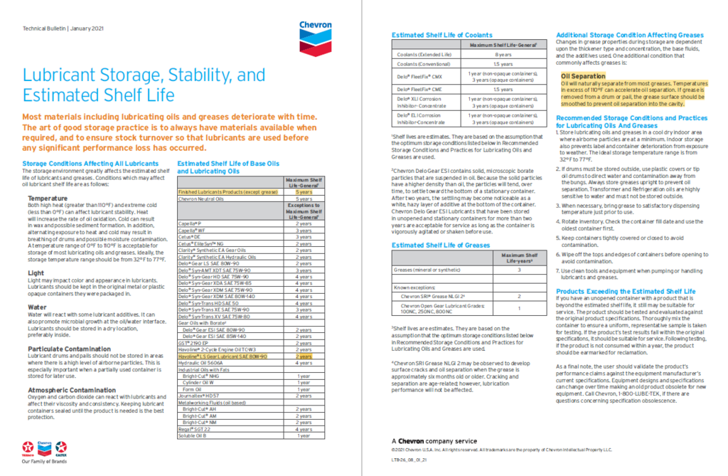

JoeM 10,318 #9 Posted November 7, 2025 Wheel Horse manual transmissions have straight gearing and will pretty much run on anything from motor oil to 80w-90. Using the machine to pull a cart would be considered intermittent loading. I don't think the oil temp would get much higher than ambient. Using a good oil or grease is best practice and yep there is a shelf life if unused. Nothing wrong with using the best if you can afford it. When in doubt change it, cheap insurance. I like buying my oil at places that have a lot of turn over. I am sure some folks here have gotten a tube of grease that has started to separate. After tinkering with these transmissions, water is the biggest enemy. Most gear lubes will not loose any lubrication quality up to 1%, and they have rust inhibitors in the blend. Unfortunately the WH case is not painted inside and rust will form on the inside top of the case. The case is splash lubricated and nothing coats that area. Back in the day, I used Chevron and they always had bulletins concerning their oils and greases. It was nice to have an lubrication engineer available too. But that is the big bucks game. Here is their take on oil shelf life. 2 Share this post Link to post Share on other sites
