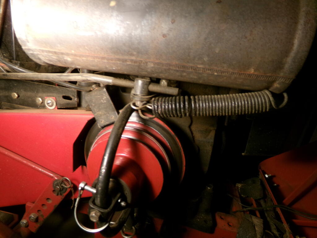

Ed Kennell 45,524 #7 Posted November 4, 2025 15 hours ago, Lance K said: Thanks Ed, I've tried up and down the threaded PTO rod with no success. I'll be checking the PTO switch tomorrow. I figure eventually I'll find it.??!! Thanks though. Check the spring that locks the cam at the bottom of the cam on the PTO engagement lever. It could be weak or disconnected. I actually added a spring on my 312 to keep more tension on the rod. It helps to keep the PTO cam locked in the on and off positions and stops the rattling noise. 1 3 Share this post Link to post Share on other sites
peter lena 9,812 #9 Posted November 5, 2025 @Ed Kennell ED, nothing sarcastic , hitch pin clip , right under that on frame ? turn the outer pto cone , swing clip around , use a lighter spring , same type , and connect the two , as stated , that area is a , gold mine for ENHANCEMENTS . removed my cone brake years back , lucas green , very lightly on / in needle bearing , also did the , lever improvement , sloppy start spot . pete 1 Share this post Link to post Share on other sites
