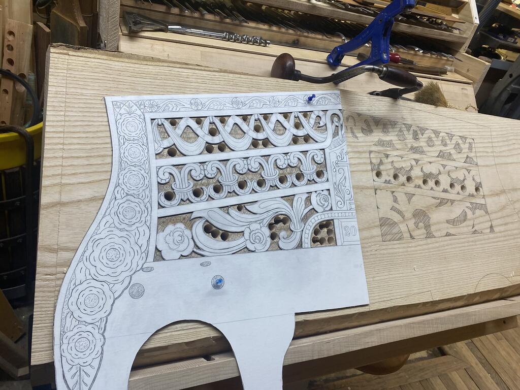

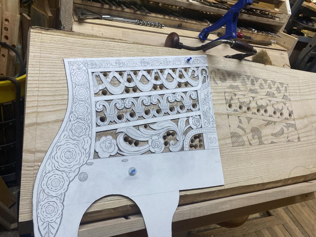

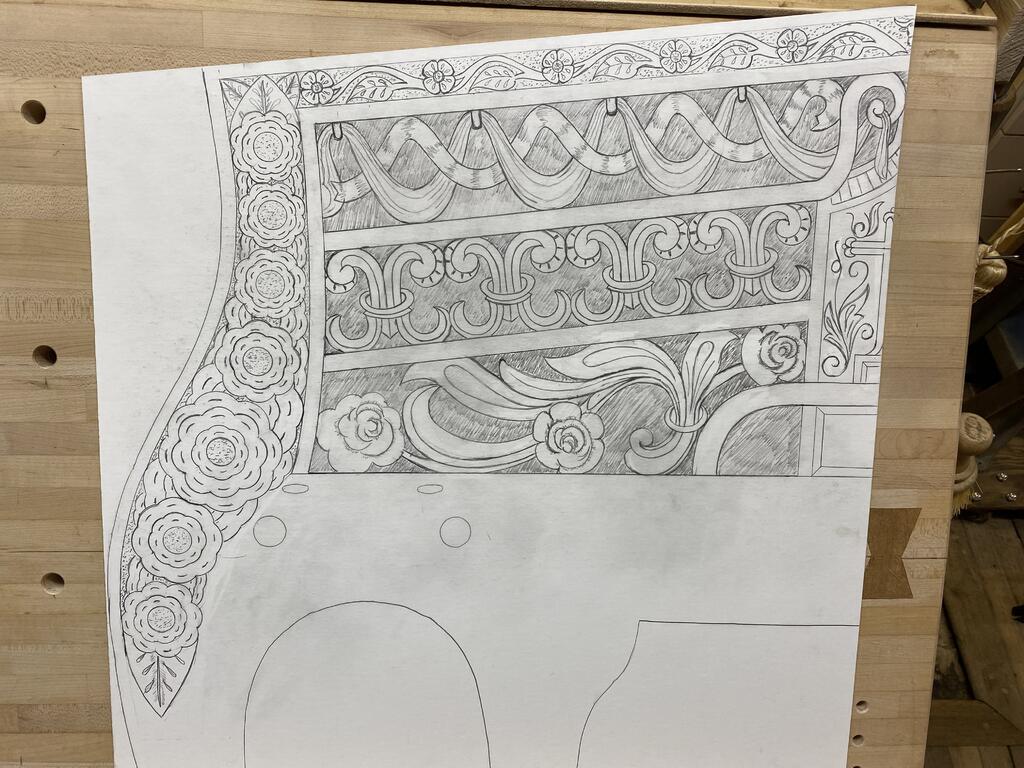

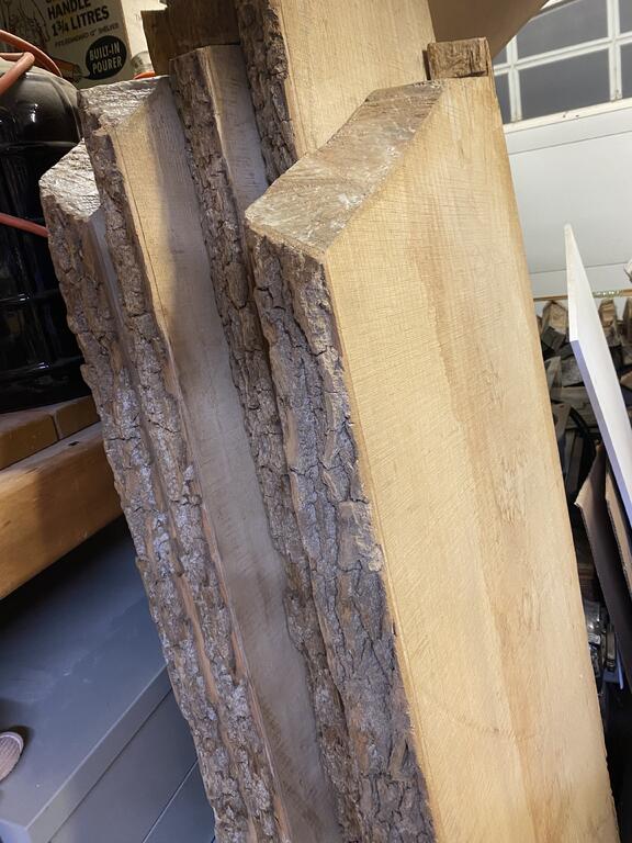

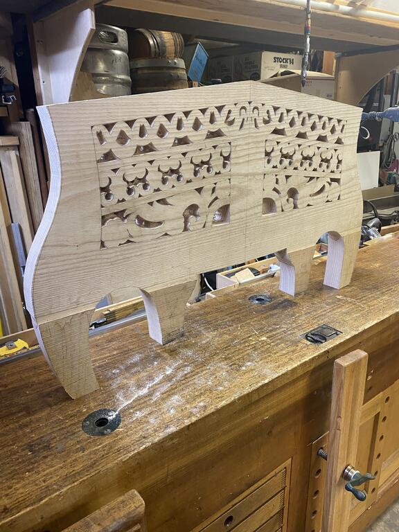

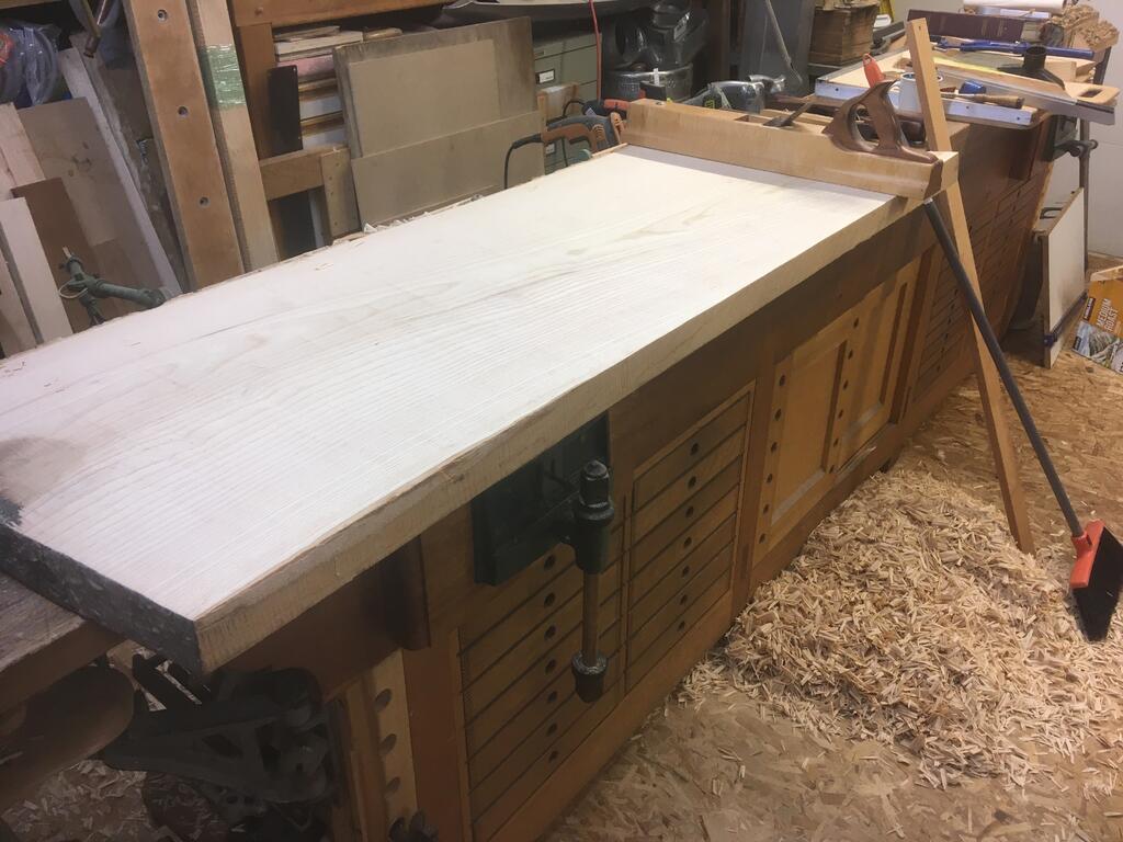

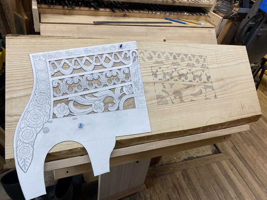

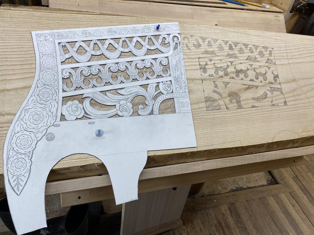

formariz 12,381 #1 Posted November 3, 2025 Started another one a little while ago. Again all entirely done without using any power tools . I am continually asked why . Sometimes it sounds like people think I like to torture myself but it’s much deeper than that. Besides the cultural aspect of it, if I don’t use what was handed to me the way it was handed, it will be lost first by me and consequently by others not having the opportunity to see what is possible without relying on machinery . On a deeper level I like to feel what they felt and to decipher not only the why but also the how of the parts they didn’t have the chance to teach me. Many of those are not even possible with power tools. When that happens they are many times outright emotional moments of accomplishment unequaled by any other time. With your indulgence like before I’ll continue posting its progress as I go along. It all starts with some ideas and a drawing. Always with strong influences from the ones before modified to reflect my own ideas but still respecting and acknowledging the originals. The material comes next. Carefully selected and guarded for many years waiting for this moment. Ash the traditional species used for this due to its strength and flexibility under load or stress. As is from the mill from now on no power tools will touch it. Flattened , straightened , unwound , and reduced into a certain thickness to start the process. a template is made of drawing to choose the best area of plank to use and to layout all the cutouts. Important to choose area of plank carefully since much of end product may have very thin or delicate areas which will be prone to cracking if not done so. 2 5 8 Share this post Link to post Share on other sites

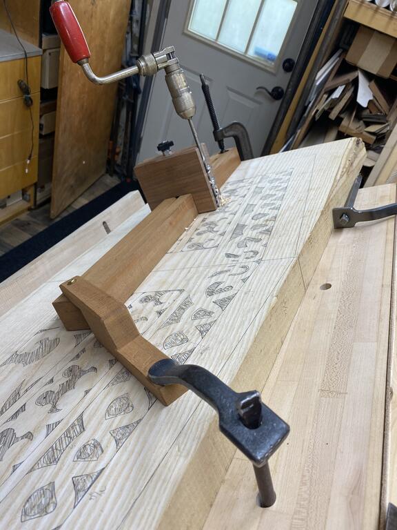

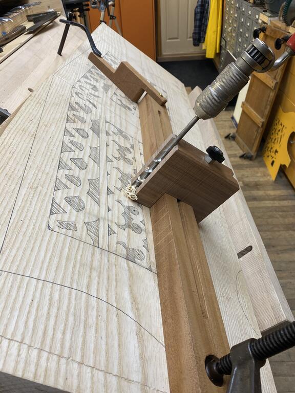

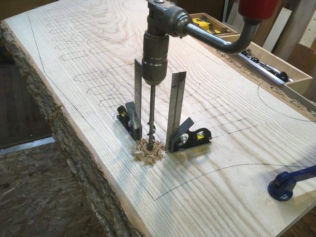

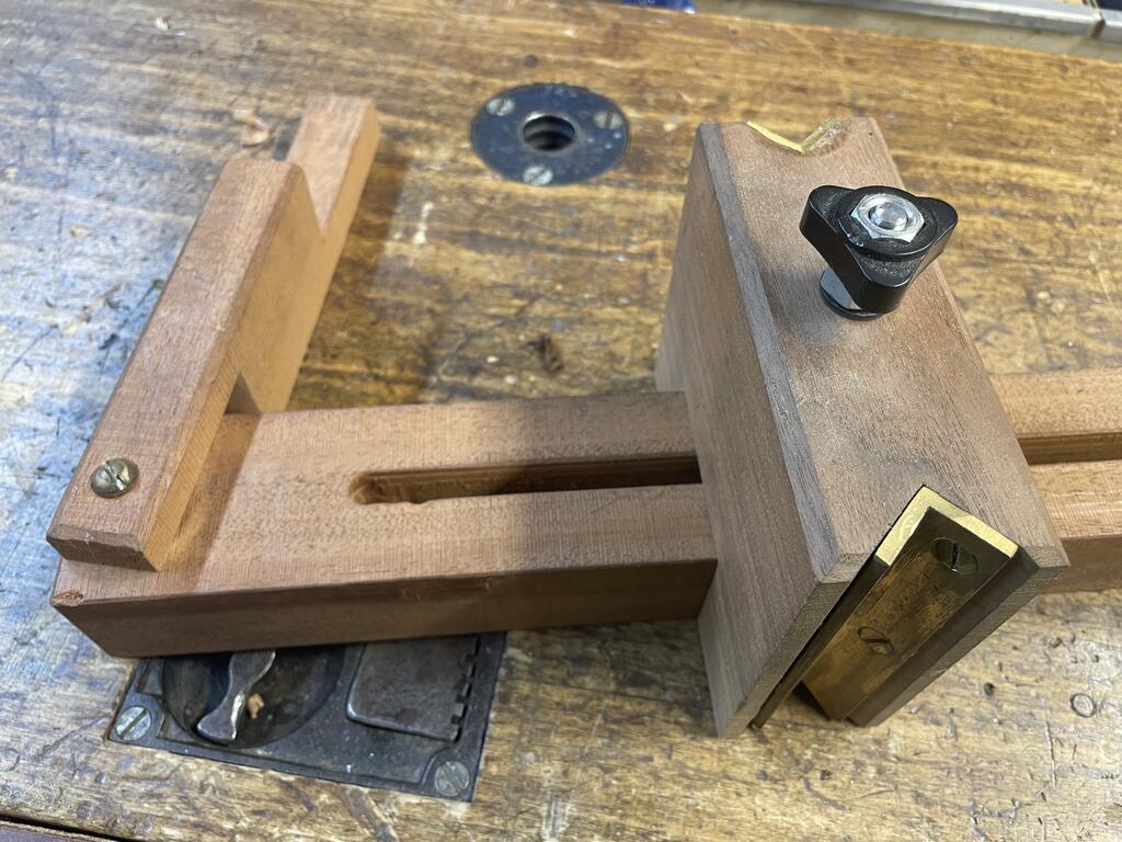

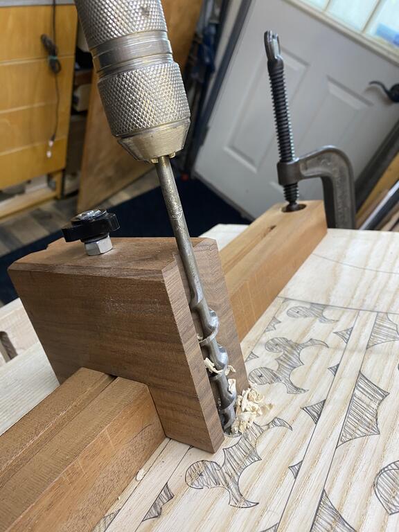

formariz 12,381 #12 Posted November 4, 2025 (edited) Once the plank is marked on one face one proceeds to drill through the parts that will be removed as much as possible minimizing labor in clearing them later. This is one of the most crucial operations since one has to drill it perfectly perpendicular to face of board. Opposite side will have exactly the same carved design and any small deviation in the drilling process can be catastrophic. Contrary to in the past I no longer do that on top of my bench therefor not being able to have a square standing next to the auger for reference. I started drilling it on the actual carving table which is at an angle. The previous way was taking a toll on my back from hours of leaning over bench. At the carving table I stand with a straight back all the time. This however proved to be quite difficult in maintaining auger perpendicular to board since I also could not have a square next to it as reference. For that I devised this articulated jig which will guide auger perfectly perpendicular to board and can be adjusted and moved readily through out it without being removed each time. It will work for any size auger since it guides the side of auger within the "V". One merely "taps" it to put the screw tip of auger on desired hole's centers. I have been improving it over time now adding a bronze angle as a wear strip.Sides of auger were cutting through it quickly.This has proved to work really well specially on my back. Shaded areas to be removed Drilling of shaded areas New way using jig to stay perpendicular to board at tilted table Jig slides and articulates through entire board Jig with bronze wear guides. Old way Edited November 4, 2025 by formariz 9 Share this post Link to post Share on other sites

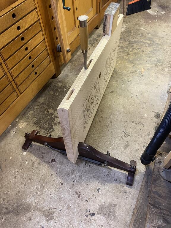

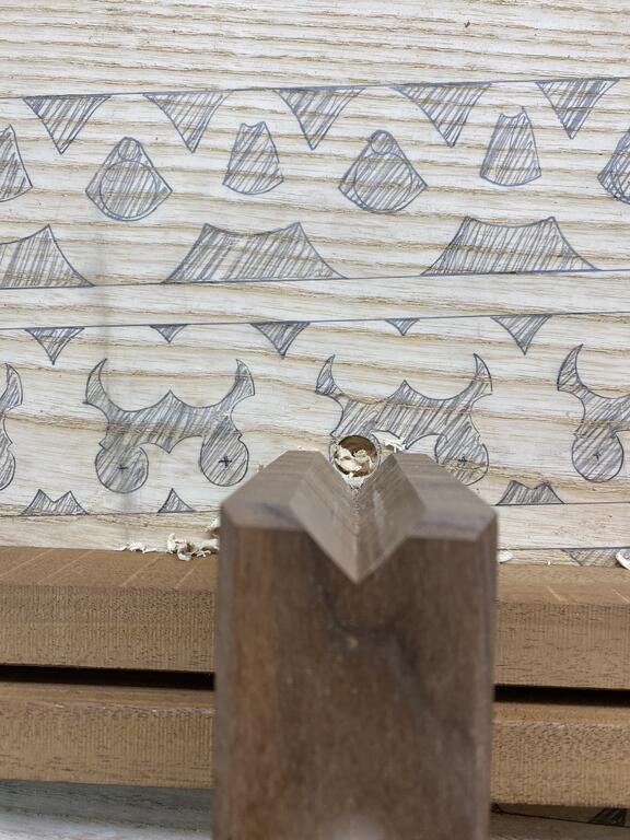

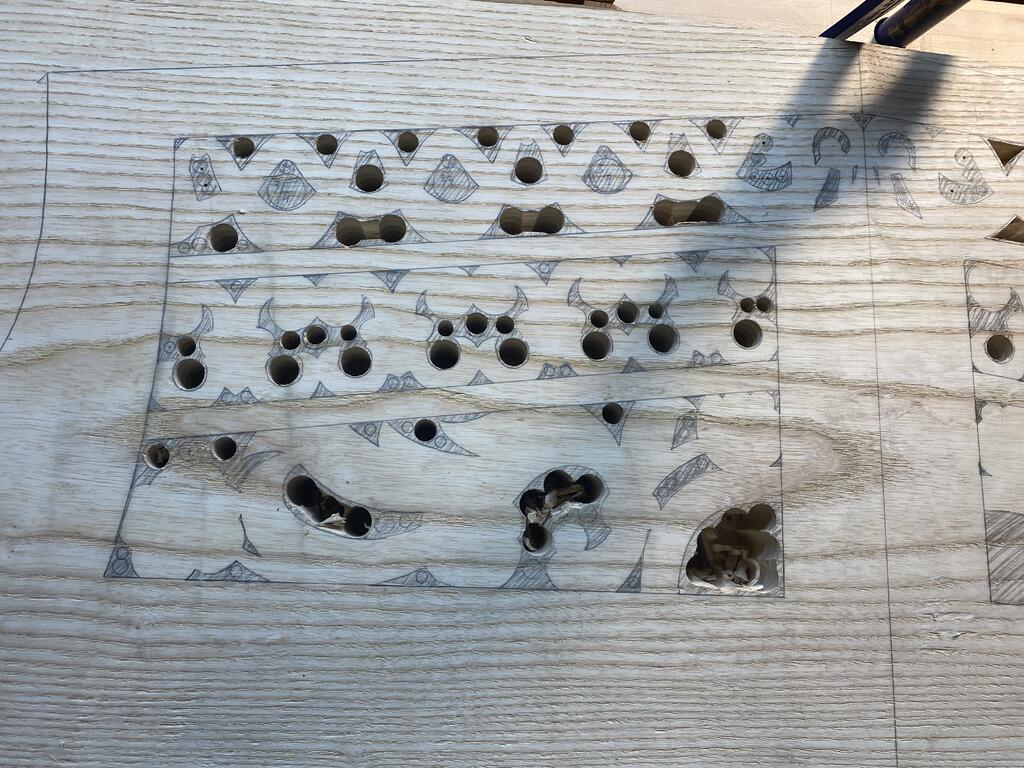

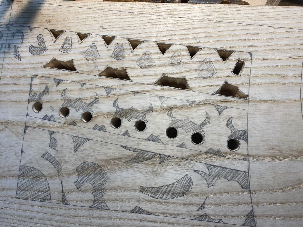

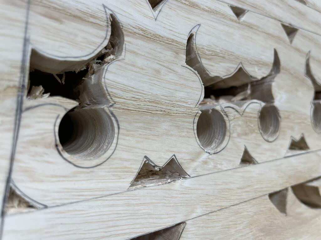

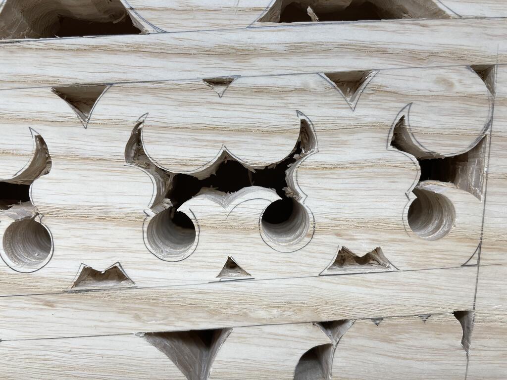

formariz 12,381 #15 Posted November 6, 2025 Once marked one then proceeds to drill through those parts with the appropriate size auger but staying a little away from the line. To break the monotony of the drilling sometimes I start on actually chiseling out those areas. Drilling does not actually goes through the board but stops automatically when auger’s screw tip emerges on opposite side and stops pulling. when board is planed on other side it will reveal all the holes. Not shown on these photos but board is blocked up from table. 5 Share this post Link to post Share on other sites

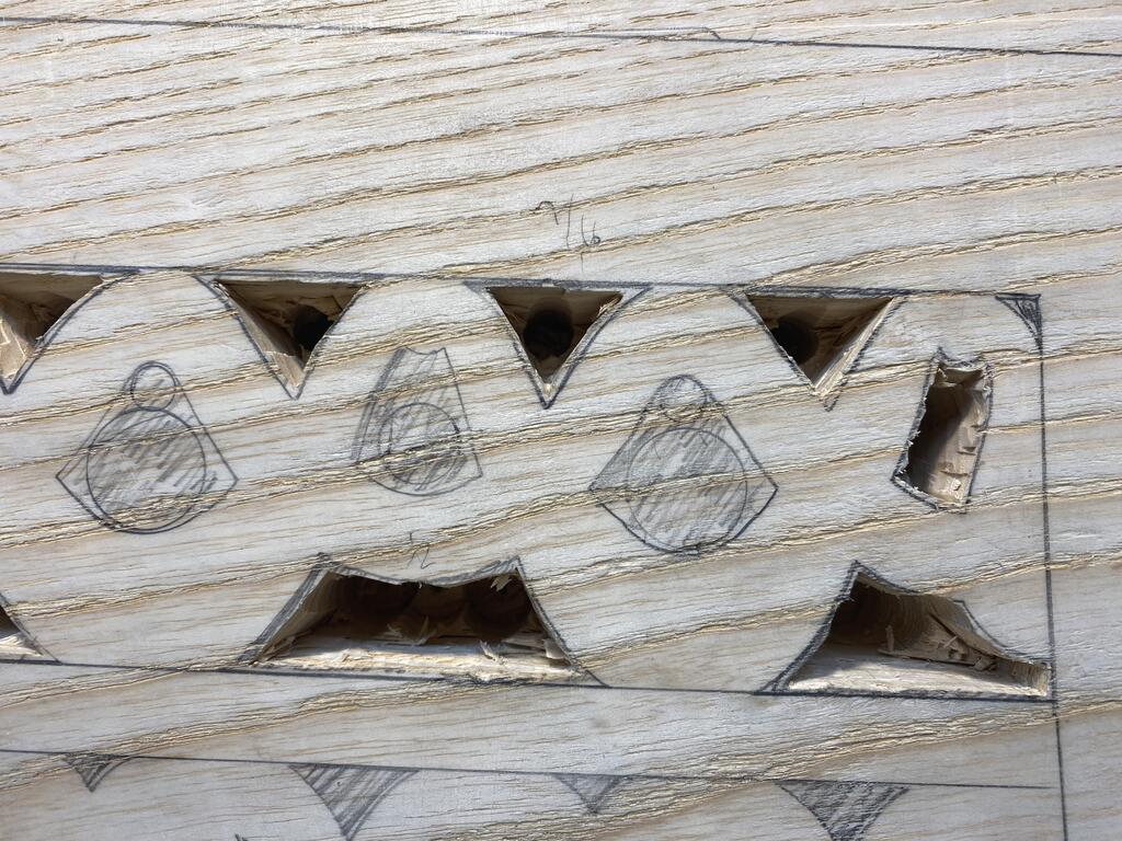

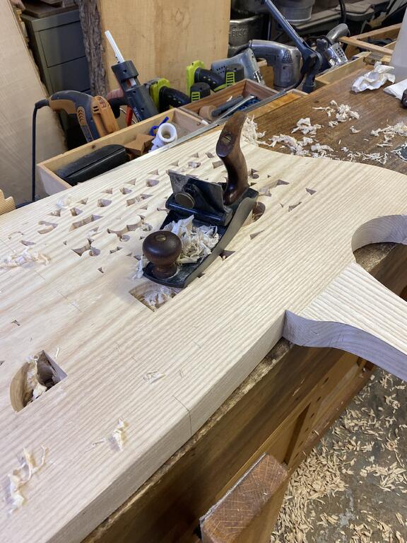

formariz 12,381 #17 Posted November 7, 2025 Next comes the task of going through all piercings. Tedious work still staying away from the lines . Real tight or small areas require extreme patience and sometimes customized tools. Many outwardly pointed areas are also fragile at this point. Also important to stay perpendicular to face of board and not dig in through board thickness. 1 5 Share this post Link to post Share on other sites

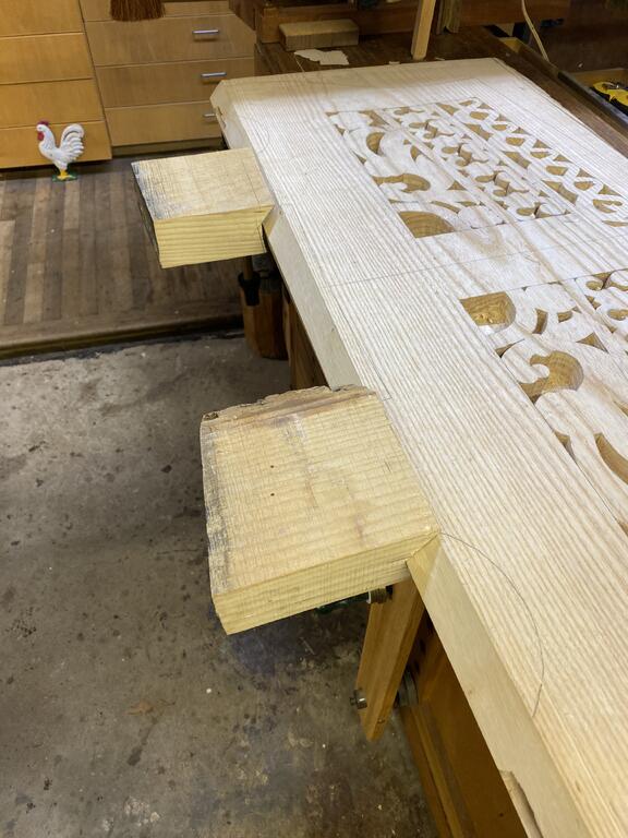

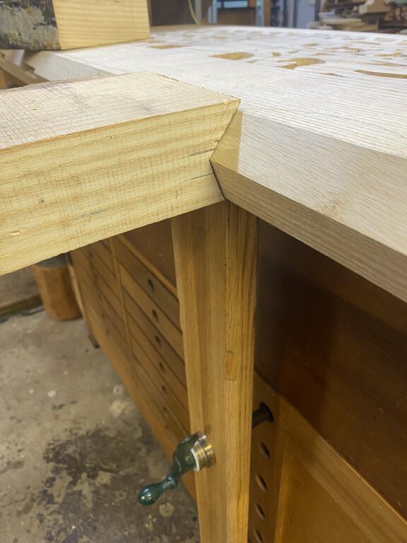

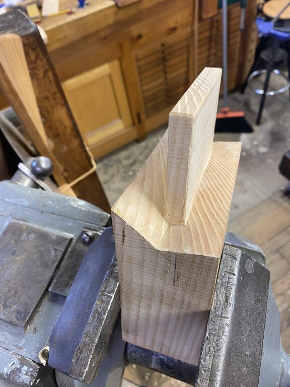

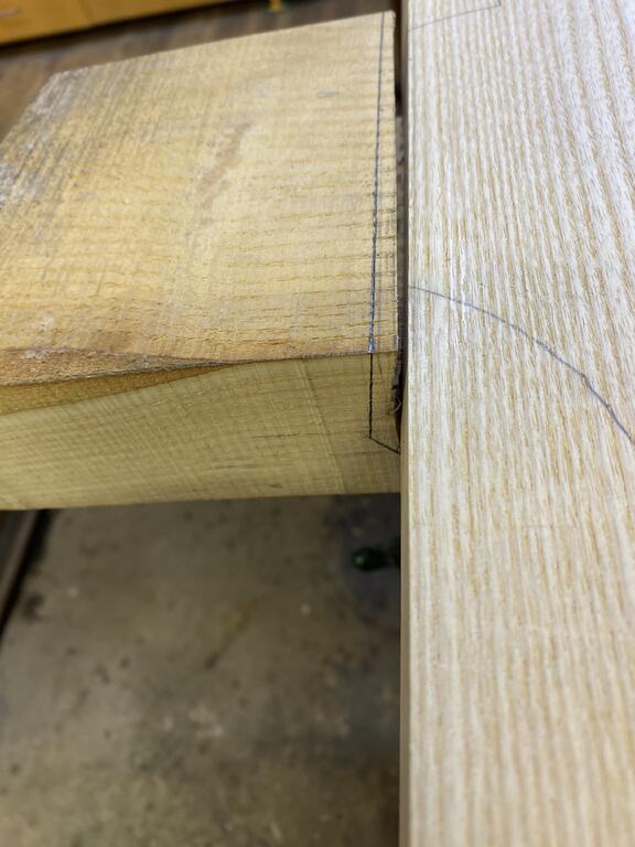

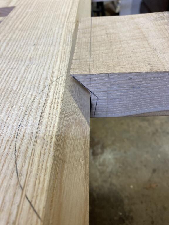

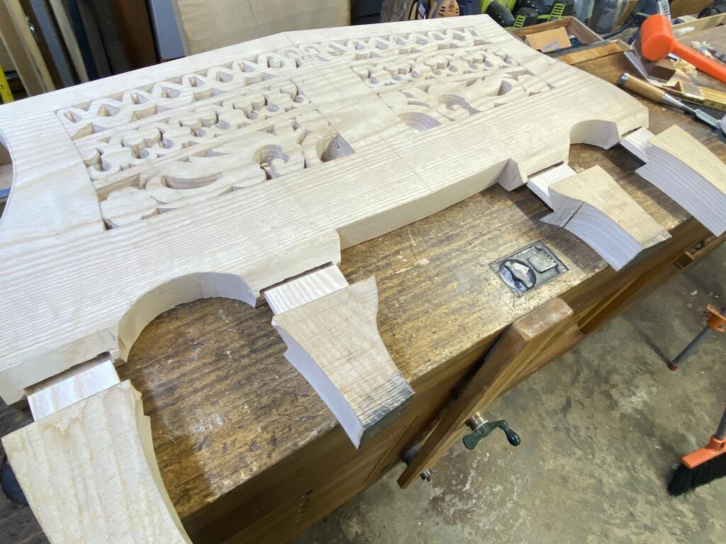

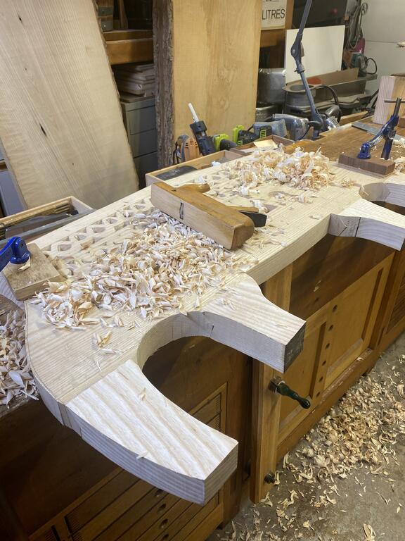

formariz 12,381 #18 Posted November 8, 2025 (edited) Having rough cleared most of openings with the exception of some very small ones it is time now to add the bottom pieces which complete bottom of yoke. These are made from pieces of same board. The reason for these pieces are twofold. First most boards are not wide enough to make it out of one piece. Depending on type of yoke, would have to be a minimum of 24” wide. However despite of being nice having it in one piece structurally it is a mistake. With the cutout for the animal’s neck the grain in those pieces is short and it is almost inevitable that they will break. A lot of pressure is put on those areas when in use. Pieces are mortised into yoke’s body about 3 to 4 inches deep . Mortise is always done first. Part of yoke’s body where the shoulders meet are not always flat. This part is many times the live edge of board and it is utilized in that manner by introducing another bevel on the other side. Most opted to flatten or cut this part because it makes fitting shoulders extremely difficult. Shoulders are scribed to fit. This is a lengthy process . Perfection is a must for strength since nothing is glued. It’s all friction fit. Tenons and shoulders need to fit perfectly. I dry these parts in the oven prior to working on them. This way they are dryer than wood in mortises. When that part eventually dries and shrinks it will get tighter around tenon. If everything is done correctly they will be nearly impossible to to remove without breaking something. The fitting process is entirely done with a paring chisel a highly specialized precise tool. Leaving these parts oversize until the end is necessary as it is the only way to remove them at this point while fitting shoulders by tapping on the end of extra thickness Along with added pieces, yoke body is also only cut to shape once this and all penetrations are done to ensure no cracks occur from the mallet and chisel work. Edited November 8, 2025 by formariz 1 3 Share this post Link to post Share on other sites

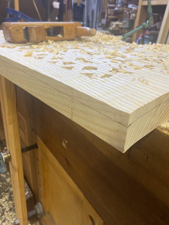

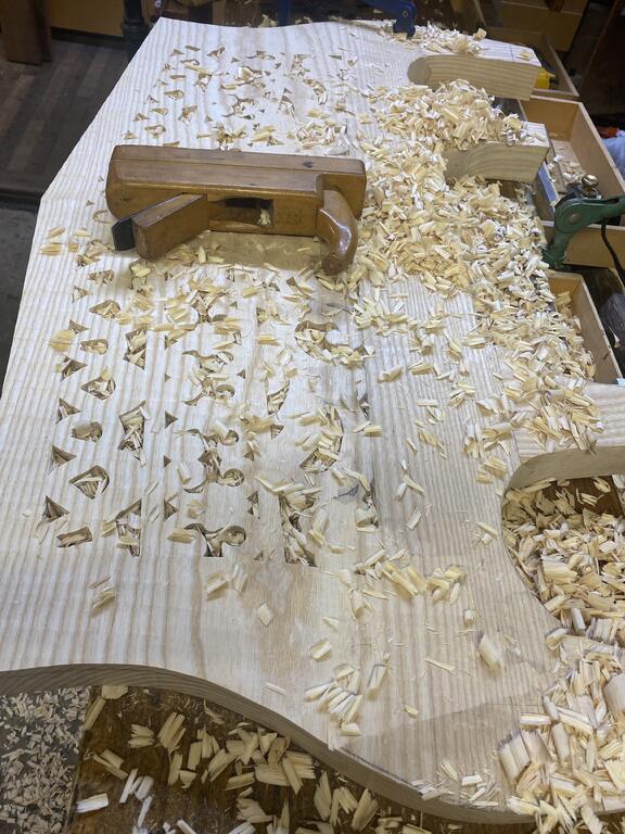

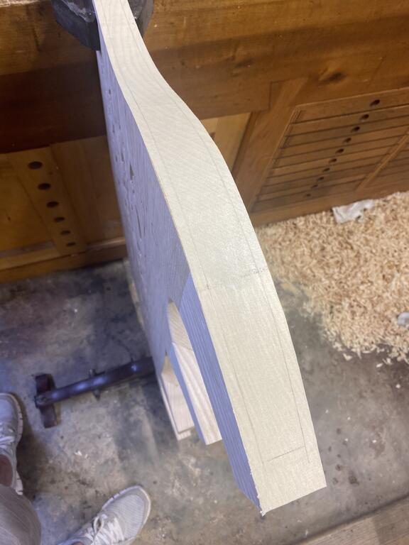

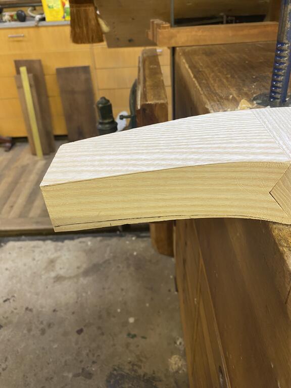

formariz 12,381 #23 Posted November 15, 2025 Once extensions are fitted final shape of yoke is cut and it is planed to final thickness Extensions are finally fitted . Once driven in and planed flush with yoke body it will not be possible to remove them without damage . It has now taken its final shape. Extensions are planed flush and face is planed smooth. Front face is planed straight straight and across . The back is now planed . Back will taper across grain. Purpose of that is to make yoke lighter and elegant rather than having a thick plank. Where it sits on animal’s neck it will be about 1-3/4” while on top will be about 3/4” to 1”. extensions will taper slightly on both sides. Finally both faces are finished off by scraping them with a scraping plane. This will eliminate any tear out from the plane in difficult grain areas. Final thickness of yoke 2 2 Share this post Link to post Share on other sites
