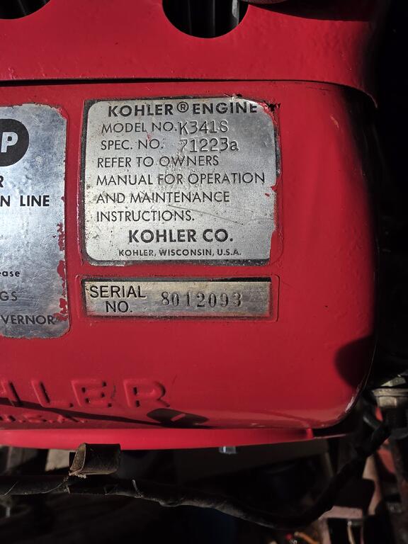

953 nut 67,194 #14 Posted November 1, 2025 12 hours ago, RJR49 said: I have a 1975 C-160. Points, plugs, and a condenser. Runs great. That's what i grew up with. My brother gave me his 1977 C-160. No spark, but no points either! Any advise from you younger guys would be appreciated Is the engine a Kohler? Some 1977 C-160s has Onan engines. What are the engine SPEC numbers on your engine ( should be 711128 ) and the engine from your brother's "77 C-160? The engine in your brother's may not be the engine the tractor was built with. Knowing the Kohler Spec number will allow you to find out what ignition system the engine has. Share this post Link to post Share on other sites

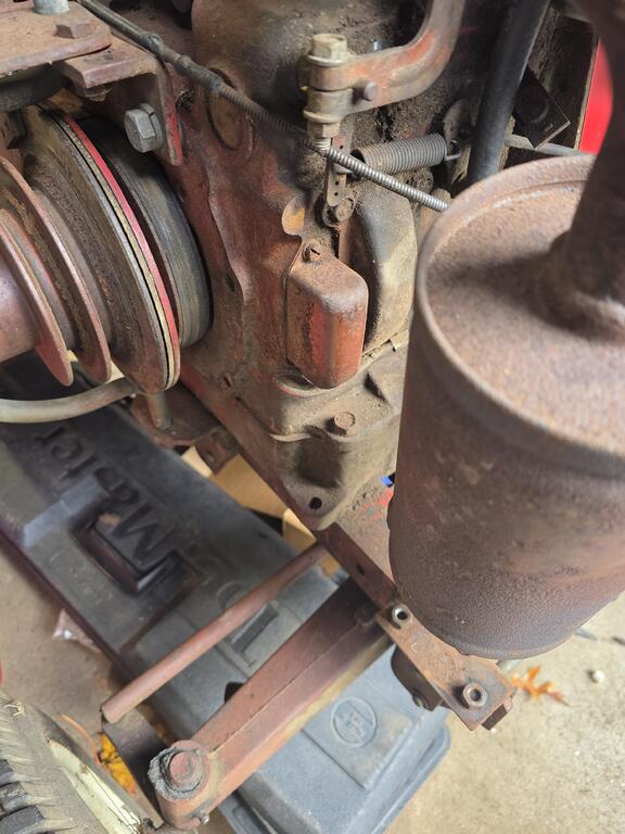

RJR49 168 #16 Posted November 1, 2025 Seems like I made a mistake. It looks like this one does have points. Share this post Link to post Share on other sites
RJR49 168 #17 Posted November 1, 2025 I guess that the easiest thing todo is replace that points and condenser. Probably the coil too Share this post Link to post Share on other sites
ebinmaine 79,491 #18 Posted November 1, 2025 2 hours ago, RJR49 said: I guess that the easiest thing todo is replace that points and condenser. Probably the coil too My advice would be to determine the EXACT issue. CLEAN the points first. See if it runs. At that point determine if the points NEED replacement. ... or just leave as is. My experience shows me that the original stock parts are likely better than most modern pieces. 2 1 Share this post Link to post Share on other sites
RJR49 168 #19 Posted November 1, 2025 They're probably not original but I'll try that first. Do you know how to test the cap & coil? I can "borrow" them from my 75 but I've always been curious about testing. Share this post Link to post Share on other sites
RJR49 168 #20 Posted November 1, 2025 Ebinmaine you've done it again! The points are Kohler and not in bad shape. Especially, since the rubber gasket was not in place. But taking you're advise i cleaned the points. Sprayed some starting fluid in the carb and it started. I let it run for a while then shut it off. Tried again and it fired right up without the starting fluid! Tomorrow I'll tighten the tow valve and see what happens when I try to move it. 3 Share this post Link to post Share on other sites
