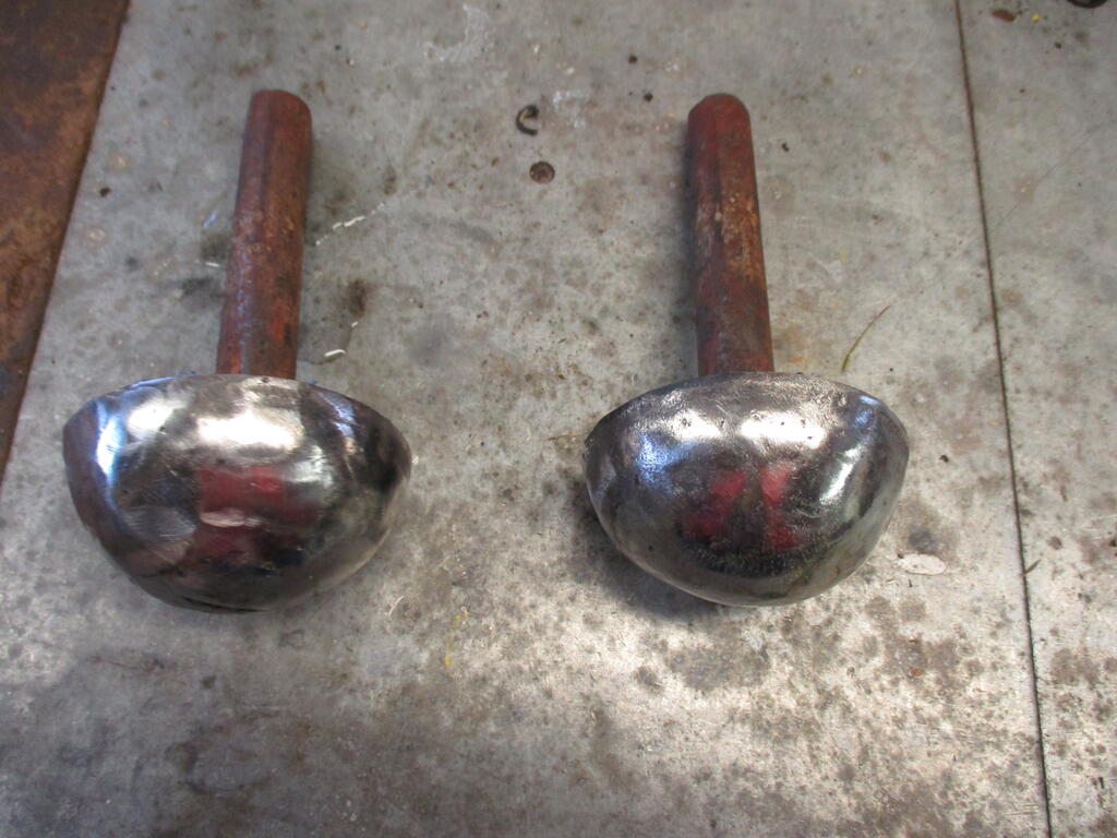

pfrederi 21,342 #2 Posted October 30, 2025 Some I have used prefer the ball type 3 2 1 Share this post Link to post Share on other sites

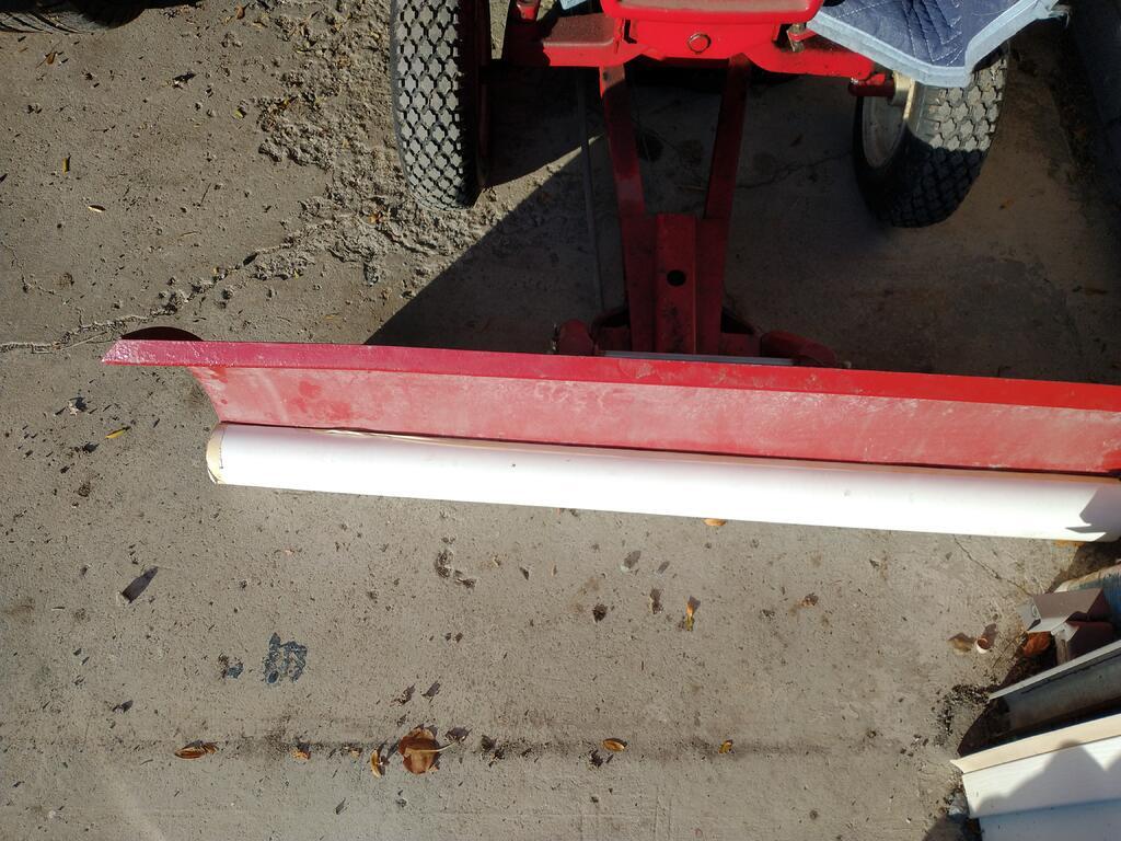

squonk 48,427 #3 Posted October 30, 2025 3" PVC slit longways. 2 1 1 Share this post Link to post Share on other sites

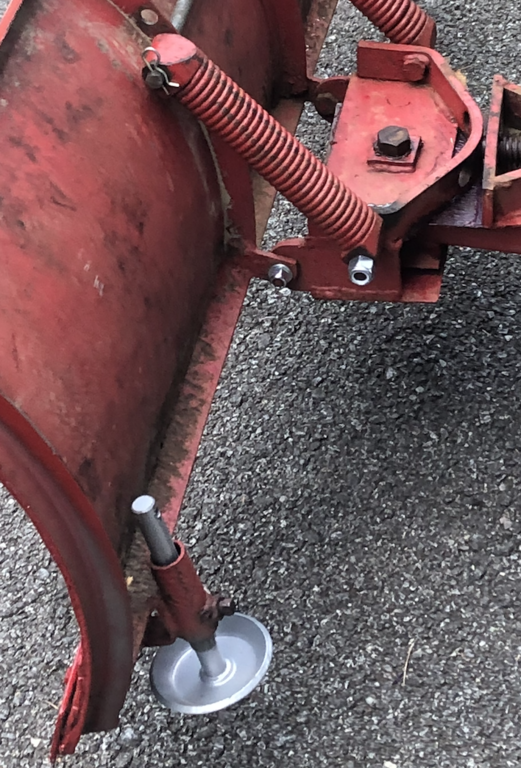

Handy Don 17,735 #4 Posted October 30, 2025 These were priced right, but I had to add a sleeve to get the ⅝” shaft up to ¾” for the holder. After using it last winter, I decided that I’ll modify the holder brackets to have the shoe’s shaft be more vertical (right now the top tilts frontward too much) since I like to have the blade top tilted forward a bit. 1 1 Share this post Link to post Share on other sites
sqrlgtr 4,225 #5 Posted October 30, 2025 Been going shoeless for years but the thought of shoes has crossed my mind since I will be running the 1257 with the hy unit this year. @squonk have any trouble shedding snow with the pvc edge? I do like the thoughts of it being easier on the pavement. Share this post Link to post Share on other sites
squonk 48,427 #6 Posted October 30, 2025 Just now, sqrlgtr said: Been going shoeless for years but the thought of shoes has crossed my mind since I will be running the 1257 with the hy unit this year. @squonk have any trouble shedding snow with the pvc edge? I do like the thoughts of it being easier on the pavement. I use it to keep from digging into the gravel. Share this post Link to post Share on other sites
sqrlgtr 4,225 #7 Posted October 30, 2025 Just now, squonk said: I use it to keep from digging into the gravel. cool. I have gravel drive going to shop and would be perfect for that. Never would have crossed my mind to do this but may give it a try. Share this post Link to post Share on other sites
rjg854 13,454 #8 Posted October 31, 2025 13 hours ago, squonk said: I use it to keep from digging into the gravel. Does it tend to ride up over packed snow? Share this post Link to post Share on other sites
1054 Project 97 #9 Posted October 31, 2025 20 hours ago, Handy Don said: These were priced right, but I had to add a sleeve to get the ⅝” shaft up to ¾” for the holder. After using it last winter, I decided that I’ll modify the holder brackets to have the shoe’s shaft be more vertical (right now the top tilts frontward too much) since I like to have the blade top tilted forward a bit. Thanks. Where did you find these? Share this post Link to post Share on other sites
squonk 48,427 #10 Posted October 31, 2025 (edited) 1 hour ago, rjg854 said: Does it tend to ride up over packed snow? Yes but with hyd. lift it's hard to control the blade height so I clear off what I can then get the 857 with a solid link, regular plow edge and the dial a height to finish it off, Edited October 31, 2025 by squonk Share this post Link to post Share on other sites

Handy Don 17,735 #12 Posted November 1, 2025 11 hours ago, 1054 Project said: 11 hours ago, 1054 Project said: Thanks. Where did you find these? They were on the jungle site. ⅝” Snow Plow Blade Skid Shoes with Lynch Pins Share this post Link to post Share on other sites
