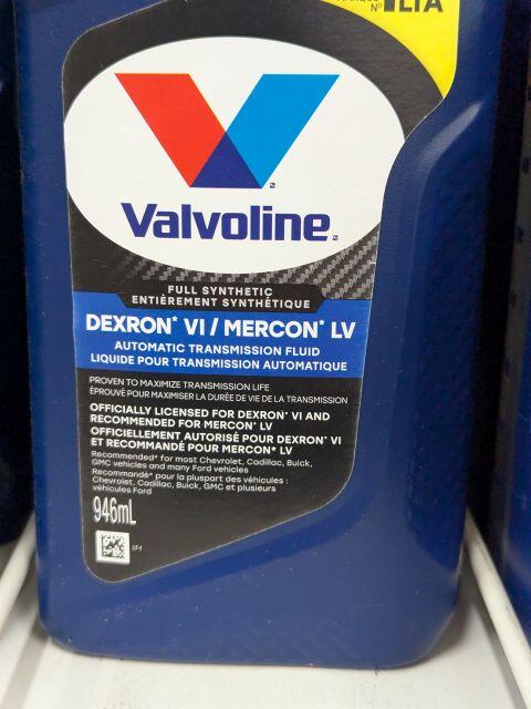

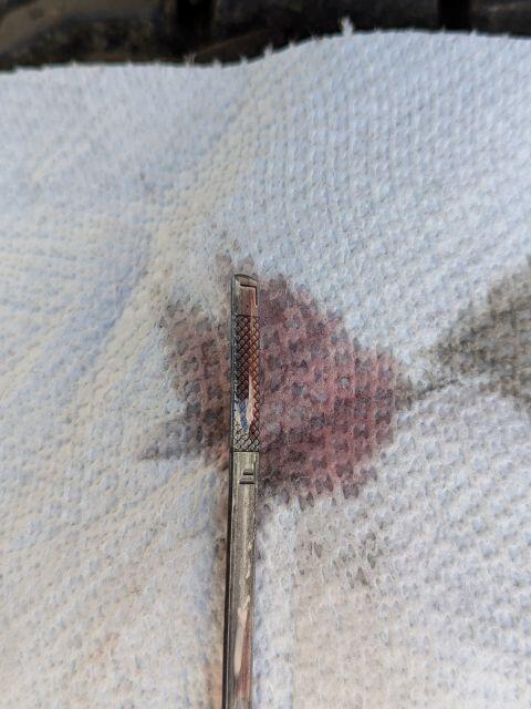

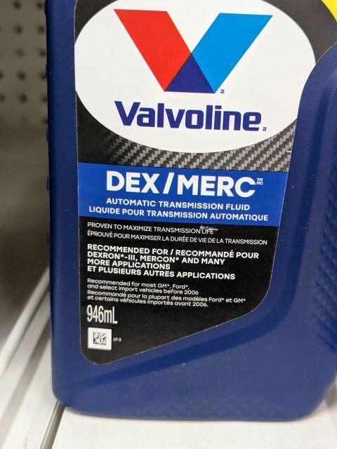

Phan 68 #13 Posted November 5, 2025 Hello - for following up. I found Dec/Merc III (pic 1) and Dec IV (pic 2). I think I need the first one. Can I use it and top it up, I don't know what is in side - but the color shows amber. Share this post Link to post Share on other sites
pfrederi 21,342 #14 Posted November 5, 2025 What you have smeared on the rag looks pink to me. If it is pink/reddish use the first Dex/merc 1 Share this post Link to post Share on other sites
Phan 68 #15 Posted November 5, 2025 2 hours ago, pfrederi said: What you have smeared on the rag looks pink to me. If it is pink/reddish use the first Dex/merc So, I should top up it - Dec/Merc III. Thanks! 1 Share this post Link to post Share on other sites
