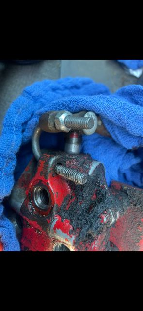

AHS 1,679 #1 Posted October 24, 2025 Moderators, I don’t know if this is in the right place, place it where it is, please. It’s about my auto lift leaking again and again! I had the valve rebuilt by PRC. It leaked the same place it did before i got it rebuilt! It leaks out of the hole behind the push/pull lever is. The owner before me put a U-bolt in the lever to the push rod… so i know that someone has been here before me!! Help would surely be appreciative!! Time for a new valve? Hairline crack?? I don’t know. Share this post Link to post Share on other sites

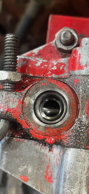

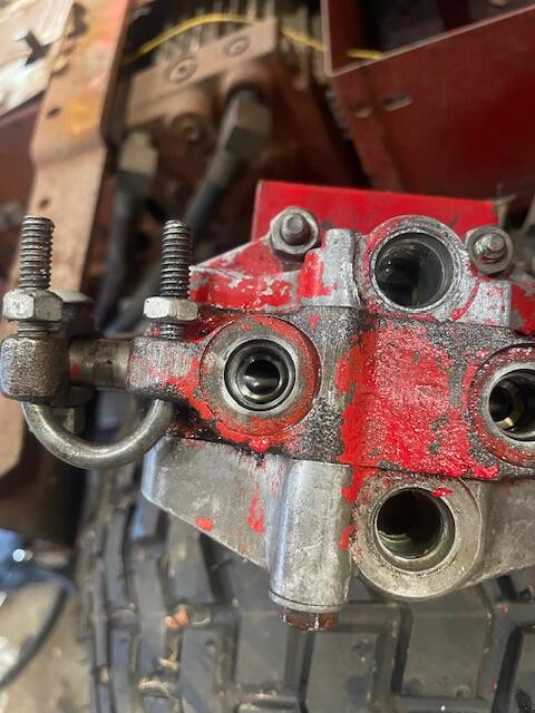

AHS 1,679 #5 Posted October 25, 2025 1 hour ago, ebinmaine said: Do you mean the actual in/out piston? No, the hole behind the piston. Share this post Link to post Share on other sites
AHS 1,679 #6 Posted October 25, 2025 @ebinmaine this one, right here. Before and after the rebuild. Share this post Link to post Share on other sites
ebinmaine 79,129 #7 Posted October 25, 2025 3 minutes ago, AHS said: @ebinmaine this one, right here. Before and after the rebuild. New hose? Or if you switch hoses does the problem move? Share this post Link to post Share on other sites
AHS 1,679 #8 Posted October 25, 2025 8 hours ago, ebinmaine said: New hose? Or if you switch hoses does the problem move? I switched hoses and. The problem stayed at that one. It’s not just like a small leak, it’s a half the floorboard in a minute type deal! Ive got plenty of O-rings, i mean… im trying my hardest to figure it out!! Share this post Link to post Share on other sites
ebinmaine 79,129 #9 Posted October 25, 2025 1 hour ago, AHS said: I switched hoses and. The problem stayed at that one. It’s not just like a small leak, it’s a half the floorboard in a minute type deal! Ive got plenty of O-rings, i mean… im trying my hardest to figure it out!! You should check with the company that rebuilt the valve. 1 Share this post Link to post Share on other sites
