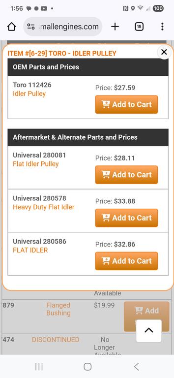

Moparfanforever 933 #9 Posted October 19, 2025 Drive belt is Toro 7478 , 5/8x84 Idler pulley is 112426 or these alternatives . Very common pulley, do a search on those numbers and you will find cheaper prices. Share this post Link to post Share on other sites
Lee1977 7,697 #10 Posted October 19, 2025 As said above 112426 the diameter is 3 3/16" to the out side of the flange. Share this post Link to post Share on other sites
