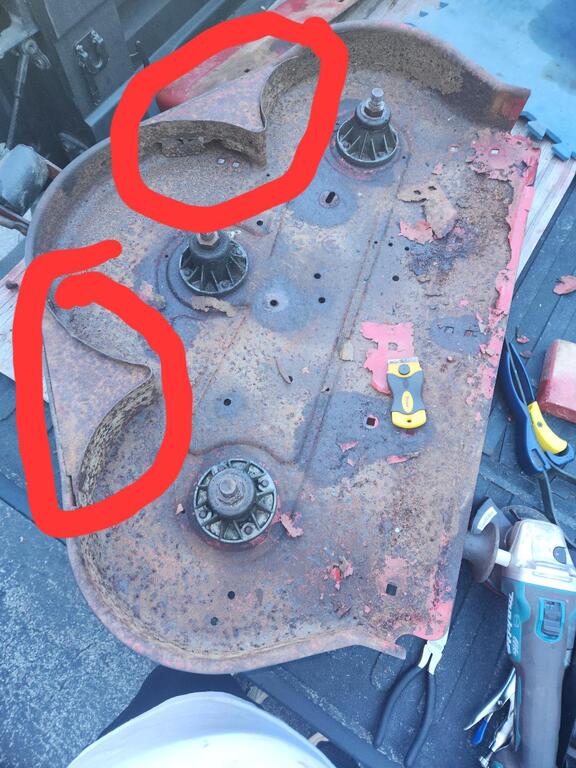

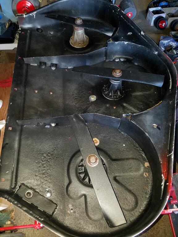

Brockport Bill 2,478 #1 Posted October 18, 2025 i am trying to save/rehab a 36 inch rear discharge mower deck -- right now its at the sand blaster shop --- the face of cowlings are rusted and have rot holes ( see photo ) . Asking for your ideas for solutions??????? W.h. built them with these open slots in each side of the deck cowling steel face -- of course they fill with grass under the enclosure -- which then has to be cleaned out!! Has anyone removed the entire cowling structure? - if YES, how do they cut after complete removal? OR -- What about just cut out the rotted jagged face of the cowling to in effect to widen the original slot opening? OR - another idea is remove the entire face piece that's rotted and replace with a complete solid piece of new steel and then the cowling would have NO opening? --------- Any suggestions? Thanks, Bill Share this post Link to post Share on other sites

Ed Kennell 47,362 #4 Posted October 18, 2025 I've had a couple RDs but never modified or rebuilt one. I can see how the three circular baffles are required to discharge the clippings to the rear rather than so the side like on a SD deck. Would it be better to just remove the two triangle shaped cover pieces to eliminate the trap that collects crass and moisture. 1 Share this post Link to post Share on other sites

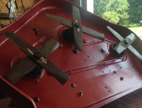

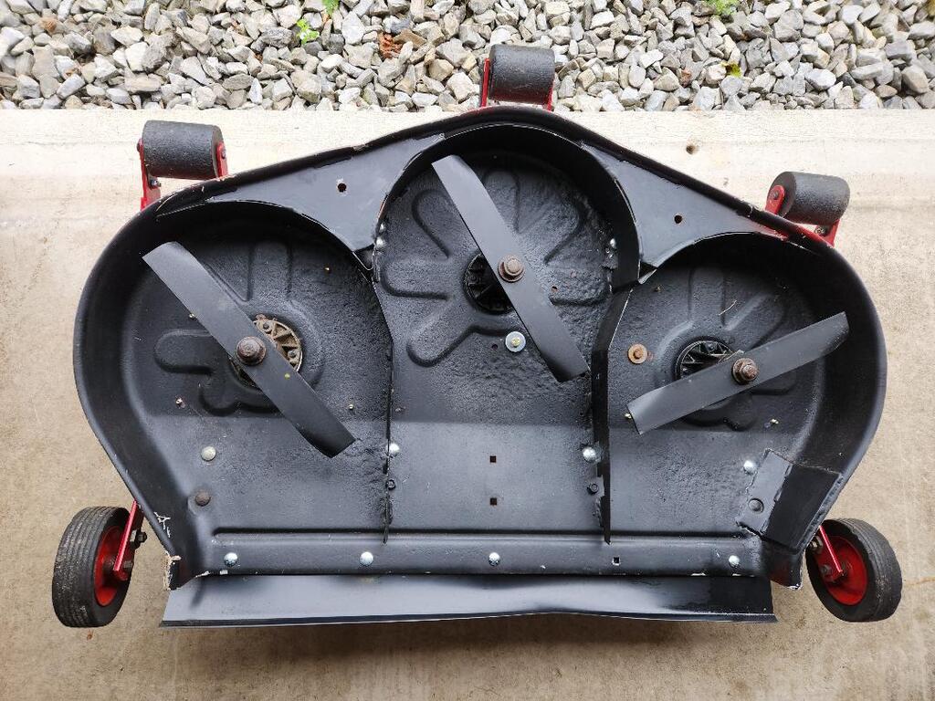

Brockport Bill 2,478 #5 Posted October 18, 2025 i"ve seen the various underneath designs on the 36 and 42 rd's so was curious why WH felt it ok for no cowlings on the 42's but built the 36 with them? If the cutting and grass circulation and discharge worked ok in some 42s without cowling then why was it needed in the 36 ? Here is photo of a 42 rd with a really weird cowling discharge design versus open layout. 2 Share this post Link to post Share on other sites

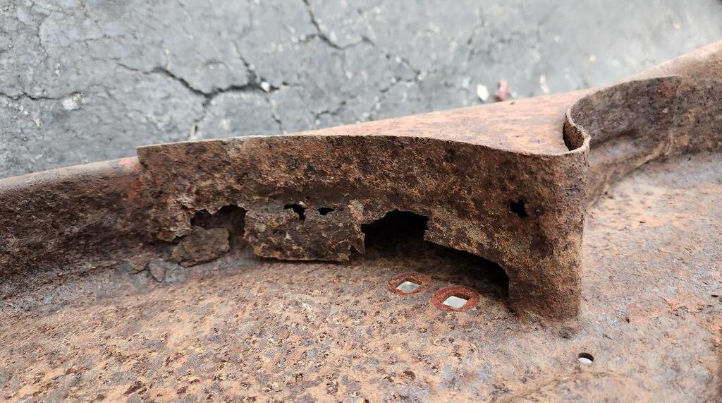

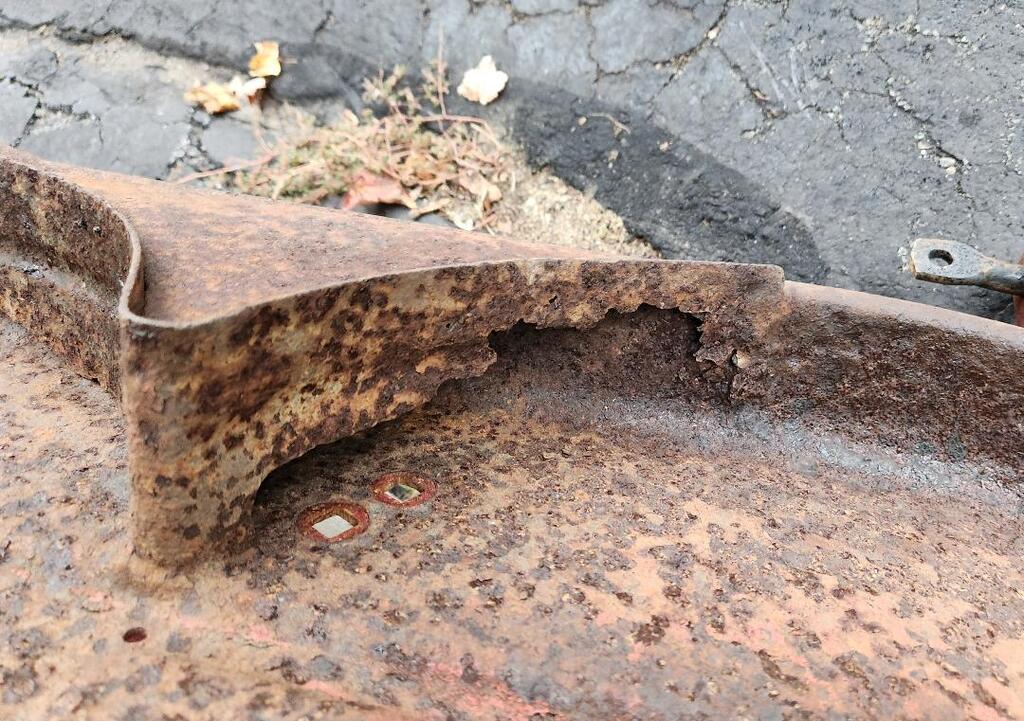

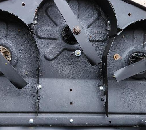

Brockport Bill 2,478 #6 Posted October 18, 2025 here are couple more photos of the rotted cowlings in the 36 rd deck - you can see the outline of the original cut out slots when manufactured by WH Share this post Link to post Share on other sites

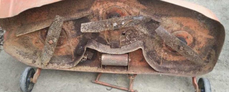

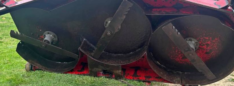

JoeM 10,268 #11 Posted October 18, 2025 I have had them both ways and only seen a difference when the dividers were in place, as far as not wind rowing. I figure the tractor is moving forward and the material wants to go toward the rear Actually not having a gathering effect like the side winders with rear baffles. Marginally effective. Just cut them out. Like Bill shows in his pic. Honestly I never though rear discharge decks cut the nicest anyway. Seems like the grass just doesn't stand up during the cut. To look nice have to cut more often. Just for conversation I included these pics. When I run across odd arrangement I kind of keep track of them this old gilson and exmark had some interesting baffles. gilson exmark Of course me messing around with twin sets of blades (project Norelco) Cut nice and made some mighty fine clippings but sucked up the HP. 2 Share this post Link to post Share on other sites

OoPEZoO 609 #13 Posted October 20, 2025 I cut the baffles out of my 36" RD deck. They were also rotted to the point of being paper thin due to stuff getting stuck in them and not being able to get out. I had used it for 15ish years with the baffles and always thought it cut well. I cut with it for one season without the baffles, but wasn't happy with the cut quality. We had also just moved to a much larger property and the 36" wasn't the best sized deck anyway so it went on the shelf in favor of a 48" SD. I also ended up with a free zero turn with a 42" deck and I now no longer mow with my WH. I've thought about welding baffles back into the 36" deck, but I don't think I will ever use it again. Share this post Link to post Share on other sites
