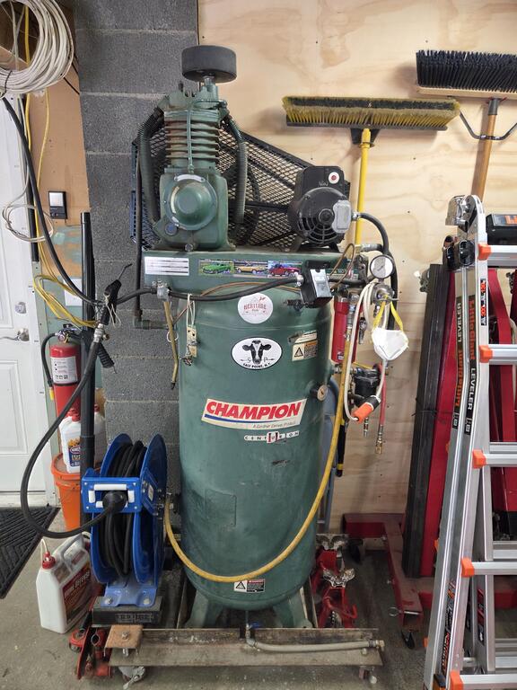

Bill D 3,156 #1 Posted October 9, 2025 I need a new motor for my air compressor. Turned it on yesterday and it started smoking. I got the compressor used, and it's 21 years old, so I guess its about time. Found a good price online from a place called Electric Motor Warehouse. $399 plus tax and free shipping. Anyone here familiar with them? @Pullstart? Thanks. Bill Share this post Link to post Share on other sites

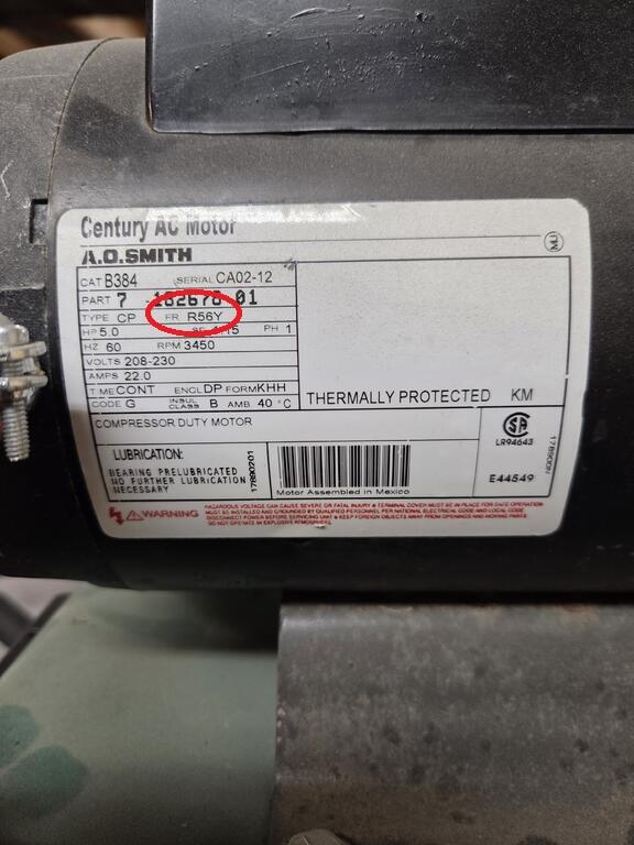

953 nut 69,319 #4 Posted October 9, 2025 Just be sure the frame number is the same, not all five HP motors are the same. 4 1 Share this post Link to post Share on other sites
ri702bill 13,067 #5 Posted October 9, 2025 Bill - one thing to check before investing $$$ on that unit. What condition is the pressure vessel (tank) in?? Any signs of rust around the bottom from trapped moisture inside?? Take a good look around the drain. Replacing a compromised tank is quite expensive.... 1 Share this post Link to post Share on other sites
Bill D 3,156 #6 Posted October 9, 2025 8 minutes ago, ri702bill said: Bill - one thing to check before investing $$$ on that unit. What condition is the pressure vessel (tank) in?? Any signs of rust around the bottom from trapped moisture inside?? Take a good look around the drain. Replacing a compromised tank is quite expensive.... Thanks. I've thought about that too. I've been able to look in the tank and found nothing serious. Pump works fine. I'm comfortable throwing $400 at it. The cheapskate in me would love to find a good used motor, but that's unlikely. 1 Share this post Link to post Share on other sites

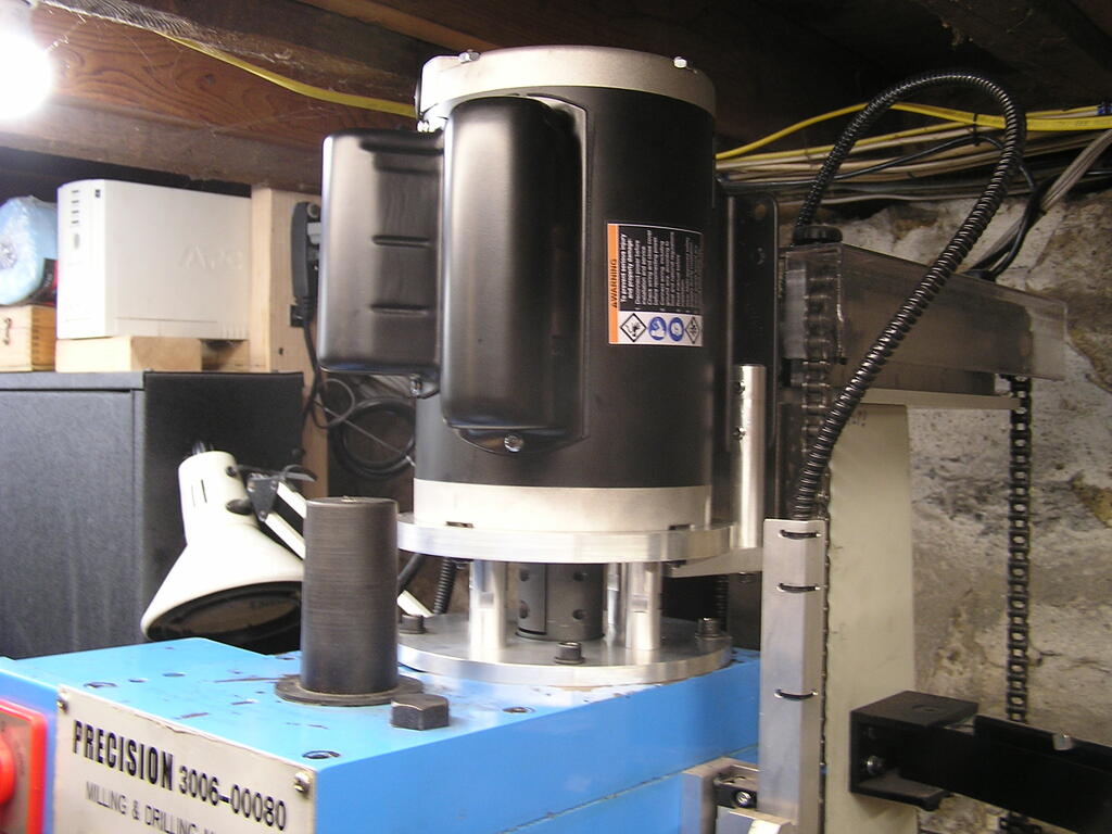

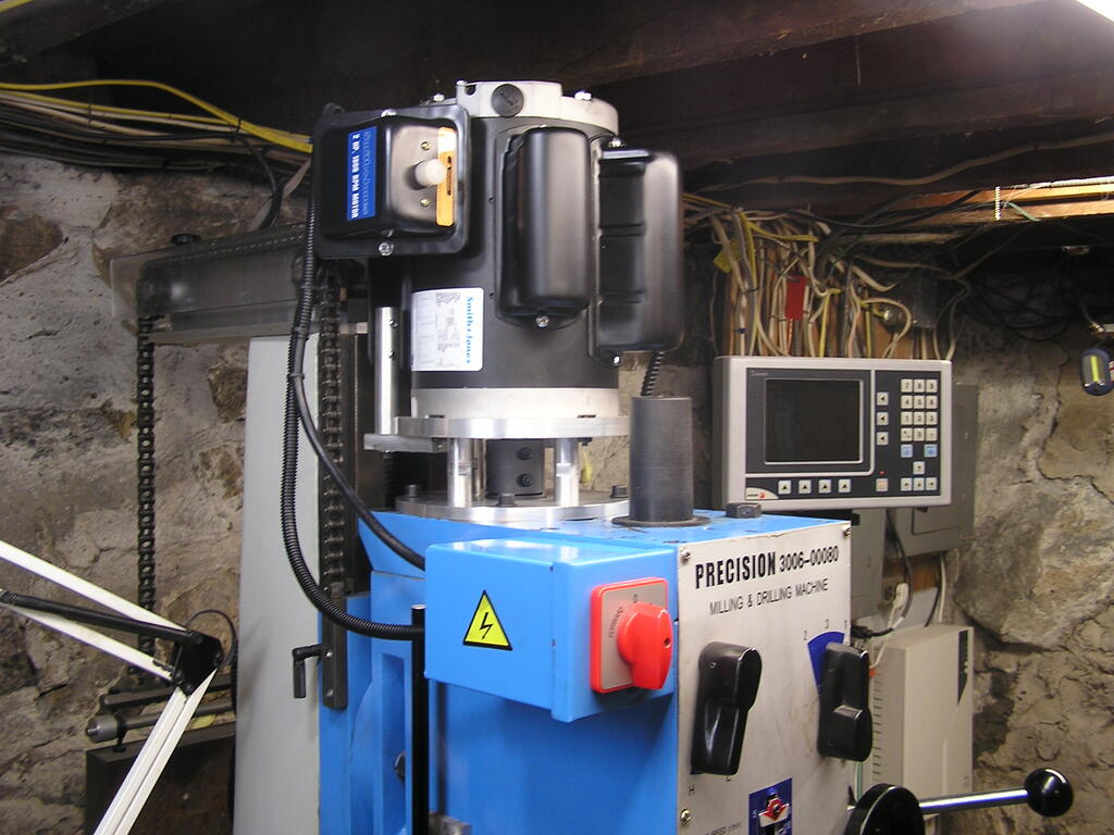

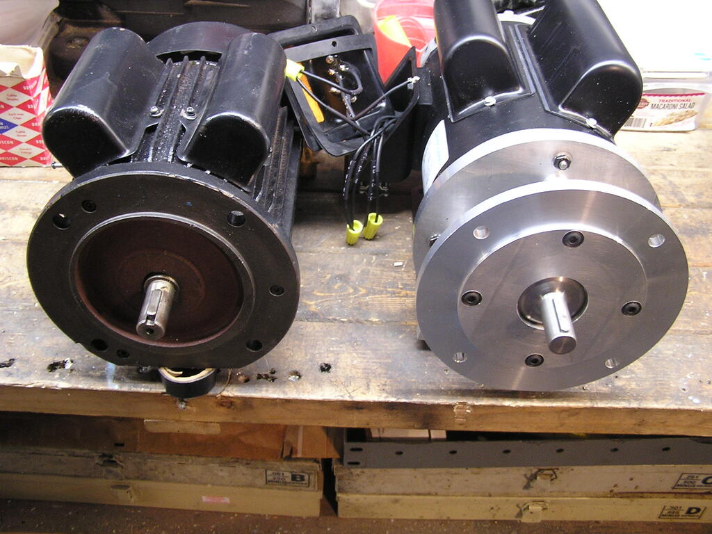

ri702bill 13,067 #7 Posted October 9, 2025 (edited) Another possibility - HFT has a 3 HP 230 volt NEMA 56 motor rated for continous duty, ie compressor. I used the 2HP 115/230 one on my milling machine, after the original suffered a "thermal event" in the connection box. Mine was not a direct bolt in - OE was face mount, HFT was foot mount like yours. The OE was available for $1200, the HFT was $200. A little fabrication, it outperforms the OE. Edited October 9, 2025 by ri702bill 2 Share this post Link to post Share on other sites

Bill D 3,156 #12 Posted October 15, 2025 42 minutes ago, Wayne0 said: Most of the time that is the problem with cap start motors. It was actually the run cap that was bad. Start cap was fine. The motor did start smoking for about two seconds before I shut it down. Not sure how much life is left in it now as a result of it overheating. If anything else goes wrong I'll put a new motor on it. It's already 21 years old with unknown hours. Pump is still good and so is the tank. Pumps the tank up from 0 to 125 in 4 min. Recovery from 90 to 125 is about a minute. Share this post Link to post Share on other sites
