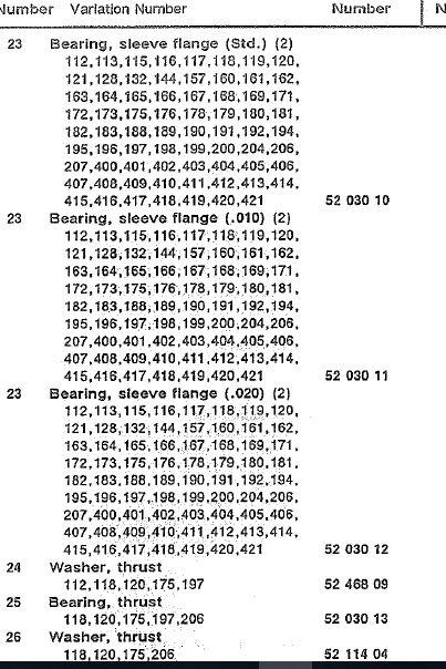

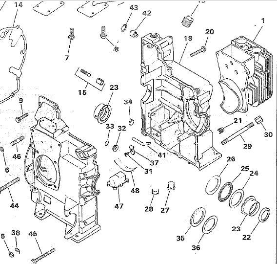

gwest_ca-(File Mod) 12,372 #13 Posted July 18, 2018 Here is the parts list. See if there was any other option. Click on the picture. Garry Share this post Link to post Share on other sites

pfrederi 20,899 #16 Posted July 18, 2018 (edited) Not all magnums had thrust bearings...actually only a very few do. Your spec # 24500 is crankcase variant 400 it does NOT have thrust bearings. In the picture item 24/25/26 are the thrust bearings. as you can see only 5 variants had them. That little flange on item 23 is the only thing to handle end loading if you do not have thrust bearings. Doubt it would last long that is why WH paid extra for the thrust bearing version You could always get an electric PTO from and Electro12 Edited July 18, 2018 by pfrederi Share this post Link to post Share on other sites

PeacemakerJack 11,022 #18 Posted July 18, 2018 Wow! Thanks @pfrederi for your input. I downloaded and printed the whole parts manual that Garry uploaded. I was shocked at the differences between the WH spec'd motors and the one that I picked up. I'll have to think long and hard about what to do with it. I suppose that one would have to split the cases to install the thrust bearing and washers, and there might not even be a provision for them in the 24500 case. Lots to think about... Share this post Link to post Share on other sites
PeacemakerJack 11,022 #19 Posted July 19, 2018 According to the chart from the download above, spec numbers 24510 and 24536 found in the 418-A and 418-C respectively. Those both have a crankcase number of 118. That of course is listed on the above picture of the chart indicating that both engines were spec’d with the thrust washers and bearing. Thanks for the clarification—should’ve researched the Spec Number before making the purchase. Looks like an 18hp Magnum with ultra low hours will be available here in the area soon for applications where side loading won’t occur... Share this post Link to post Share on other sites
pfrederi 20,899 #20 Posted July 19, 2018 (edited) 9 hours ago, PeacemakerJack said: According to the chart from the download above, spec numbers 24510 and 24536 found in the 418-A and 418-C respectively. Those both have a crankcase number of 118. That of course is listed on the above picture of the chart indicating that both engines were spec’d with the thrust washers and bearing. Thanks for the clarification—should’ve researched the Spec Number before making the purchase. Looks like an 18hp Magnum with ultra low hours will be available here in the area soon for applications where side loading won’t occur... Trying t retrofit the thrust bearings may not be possible. They had to make room for them. may be in the crankcase itself in which case you would have to change that... also they may have machined the crank shaft to make room. Only one spec # besides the 2 WH ones uses the Variant 114 Crankshaft.... Why not consider an Electric PTO???....No side loading with that. Edited July 19, 2018 by pfrederi 1 Share this post Link to post Share on other sites
