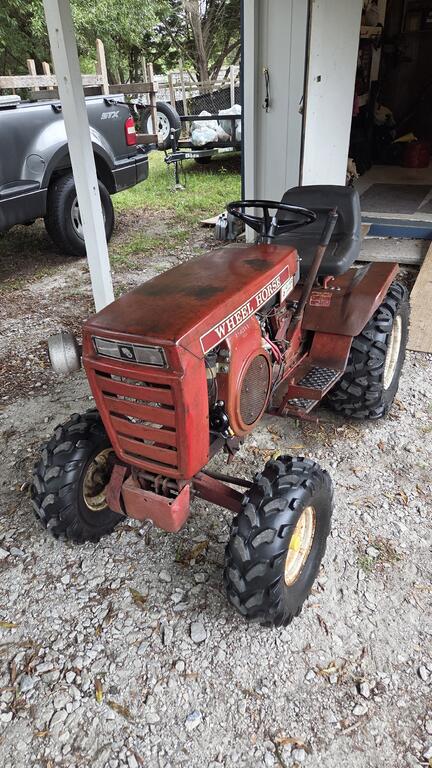

Treepep 1,099 #2 Posted September 27, 2025 @Lee1977 Put me onto some atv tires that I really enjoy on my 1977 C-120. I'd have to look to find the size however I am happy to. Share this post Link to post Share on other sites

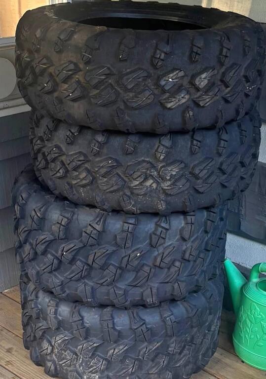

squonk 45,899 #4 Posted September 27, 2025 I got these From @19richie66 at the show 2 years ago. 1 Share this post Link to post Share on other sites
Treepep 1,099 #5 Posted September 27, 2025 Rear 25x10-12 Front 10x7-8 I am not the guy to explain those numbers As stated. I am happy with them. Doesn't mess with my turf. That said I have aggressive warm season grass growing in sand. If you had actual soil or wet soil i could imagine them taking some bites if you weren't careful idk though Share this post Link to post Share on other sites

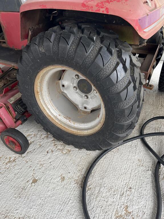

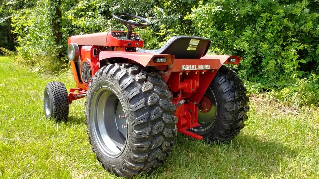

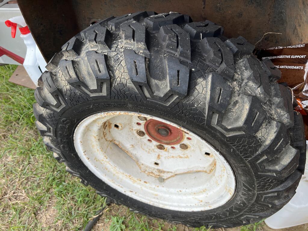

19richie66 17,846 #7 Posted September 27, 2025 I used these on my 1054 and gt14. Traction is fantastic and they don’t tear up the yard. 27-9.0x15 on the 1054 and 27-11.0x15 on the gt14. Maxxis Ceros or Duro Frontier. Even have them on my mower. 😁 1 1 Share this post Link to post Share on other sites

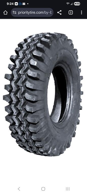

8ntruck 8,700 #8 Posted September 28, 2025 (edited) Good thread. I've been looking into new tires for Clyde, the C-195. I'm thinking I want something along the lines of a Surbanite mud & snow type tread. Edited September 28, 2025 by 8ntruck Share this post Link to post Share on other sites
RED-Z06 2,718 #9 Posted September 28, 2025 Too bad Buckshot Mudders are too tall. Share this post Link to post Share on other sites
8ntruck 8,700 #10 Posted September 28, 2025 Pretty much what I have in mind. There are some automotive tires out there with the tread I like, but don't come in the 9" wide section I want. Share this post Link to post Share on other sites
