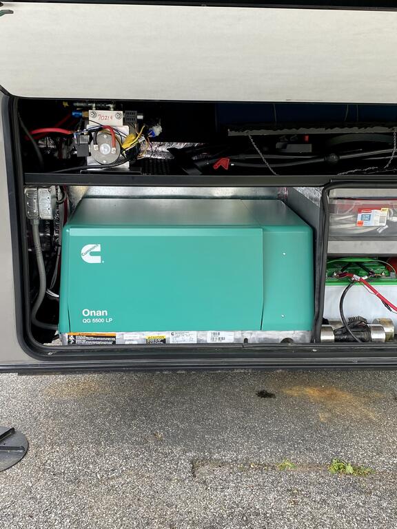

nylyon-(Admin) 9,052 #13 Posted September 24, 2025 On my camper I have both solar and a 5500 generator, both built in. For solar, remember that solar is simply to replenish the batteries, so when sizing the system, battery capacity is key to what you will be looking to do. If you plan to utilize 120v system, then batteries and an inverter are the critical parts, and the solar then gets sized to charge the batteries based on how much they become depleated. My solar is simply to keep the batteries topped off when we are not plugged in, the setup is a simple 200w panel with 2 agm batteries and it works for what I need. The built in 5500 Onan generator can basically power the camper when needed, including the 3 roof top air conditioners. 3 Share this post Link to post Share on other sites

nylyon-(Admin) 9,052 #17 Posted September 24, 2025 Interesting, I didn’t realize that it was all electric. Is this a 120v electric system, or is everything 12v? If it were 120 and If it were me, I would go with a larger inverter like a Victron Multiplus II with 3 or 400 AH of lithium batteries and 400w of rooftop solar with an MPPT charge controller, then you can get away with a small portable generator when the sun don’t shine. 1 Share this post Link to post Share on other sites
