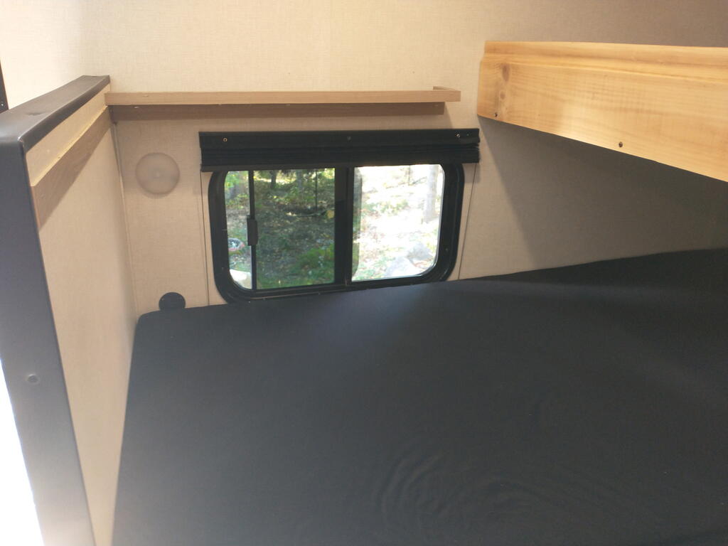

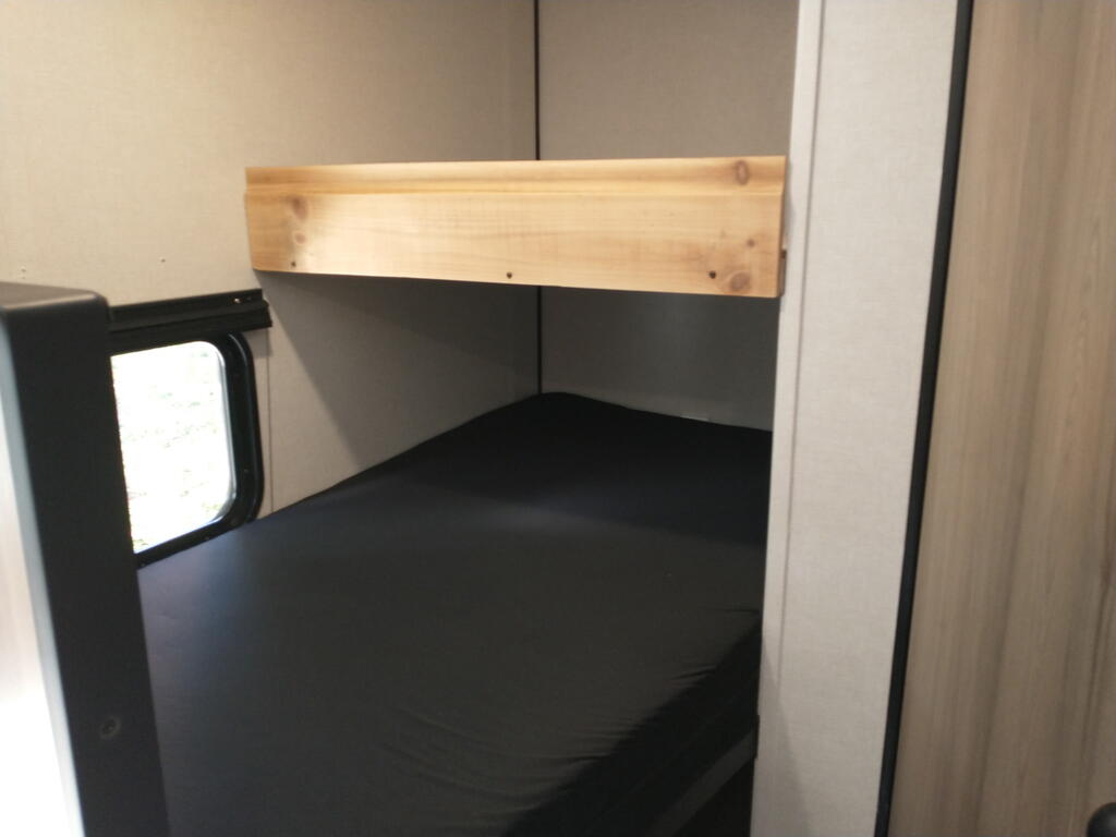

Retired Wrencher 6,954 #126 Posted September 29, 2025 (edited) 15 hours ago, ebinmaine said: Today Trina and her momma put a piece of pine on the end of the cutoff shelf to keep things in place while moving down the road. They also used some of the trim and block off panels to create a small shelf above the window. This will hold very light items only. It has a USB/C port just out of sight above it. Handy dandy for phones or other items to be charged overnight of we're connected to shore power. The piece of trim on the left is to block/cover old screw holes 🕳. Morning Eric. Just wondering, how can you charge your cell phone when you go off the grid. Or is it everywhere you go there’s power available. Buy the way that is stating look nice. I see you have a plan. Edited September 29, 2025 by Retired Wrencher More info 1 Share this post Link to post Share on other sites
ebinmaine 80,465 #127 Posted September 29, 2025 3 minutes ago, Retired Wrencher said: Morning Eric. Just wondering, how can you charge your cell phone when you go off the grid. Or is it everywhere you go there’s power available. Buy the way that is stating look nice. I see you have a plan. We would only be charging the cell phones where we are using them. So it would be in state parks. Off-grid, the only thing it's on for is pictures. Takes several days to drain the battery of a cell phone if it's on airplane mode. 1 Share this post Link to post Share on other sites
Retired Wrencher 6,954 #128 Posted September 29, 2025 Just now, ebinmaine said: We would only be charging the cell phones where we are using them. So it would be in state parks. Off-grid, the only thing it's on for is pictures. Takes several days to drain the battery of a cell phone if it's on airplane mode. I agree with that. Share this post Link to post Share on other sites

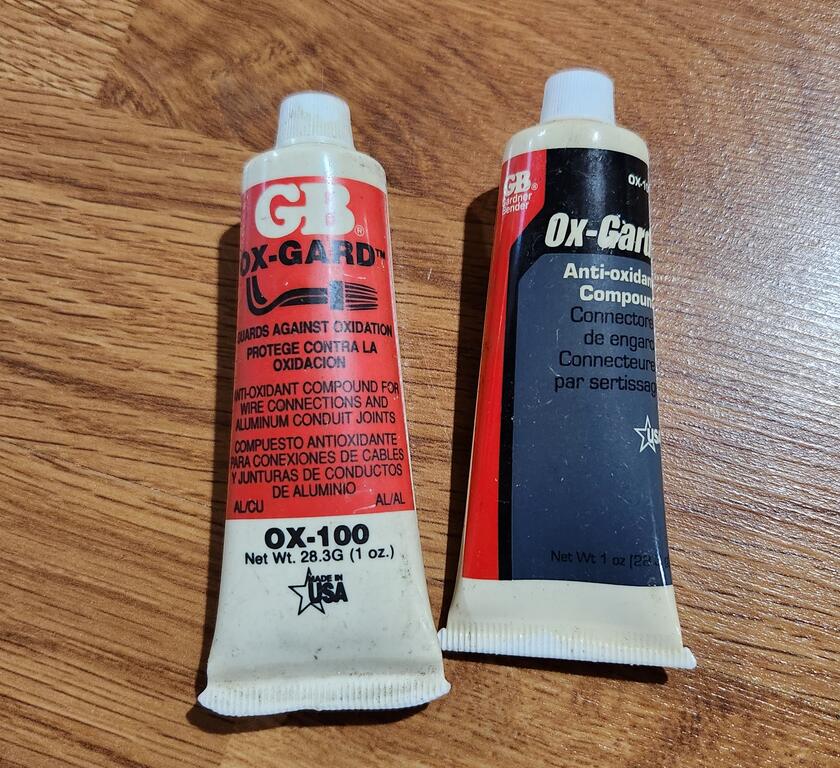

lynnmor 9,026 #131 Posted September 29, 2025 There are many YouTube videos regarding silicone on RVs, you might want to check them out. I use No-Ox on electrical connections. 1 Share this post Link to post Share on other sites
Racinbob 13,122 #132 Posted September 29, 2025 Readily available. 4 Share this post Link to post Share on other sites

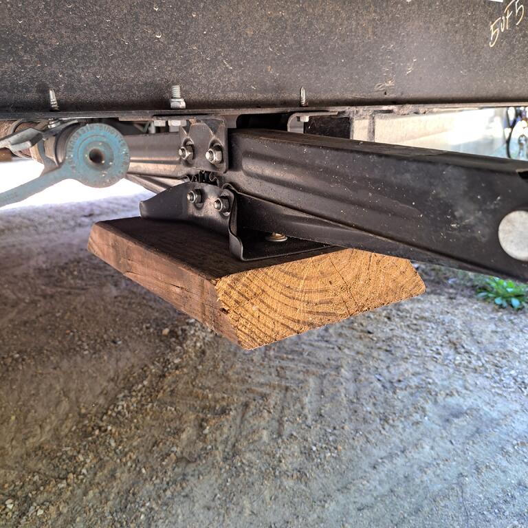

WHX?? 57,923 #138 Posted September 29, 2025 On the jacks EB. Some places still need extra blocks. The jacks work best at 3/4 or less extended. We all use a impact with a 3/4 socket. Not supposed to but these jacks are almost giveaways at rv places if one wrecks. Keep well lubed says greasy Pete 2 1 Share this post Link to post Share on other sites

Ed Kennell 47,119 #141 Posted September 29, 2025 43 minutes ago, WHX?? said: Some places still need extra blocks After flipping the axle on my Coleman I had to make extensions for my jacks to compensate for the 5 inches I lifted the camper. BTW, I needed the extra height. Where I camped at Savage River State Forest in western Md., I had to ford the creek 5 times to get to my turkey hunting spot. Even raising the camper, there was one deep ford that I raced thru to minimize the amount of water in the camper. 1 1 Share this post Link to post Share on other sites
