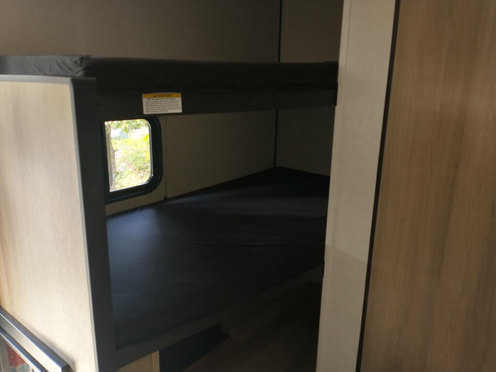

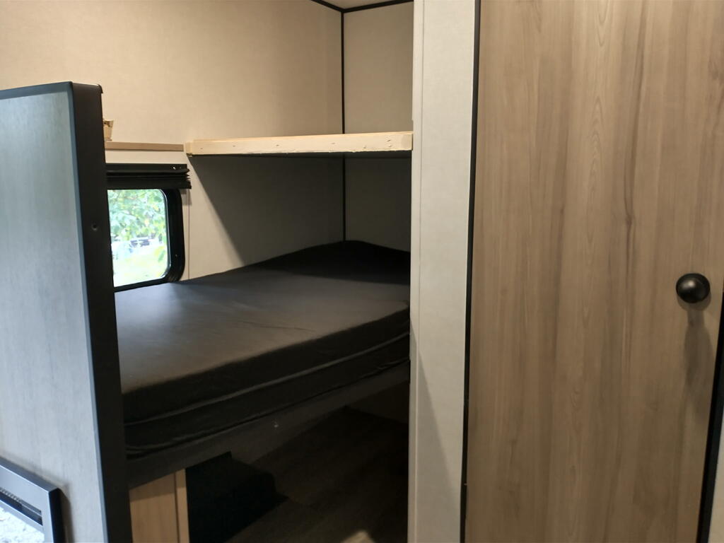

ebinmaine 80,464 #101 Posted September 27, 2025 We cut the forward half of the top bunk out. This makes the middle bunk more user friendly with better light and space. It also offers good storage space in the back, up top. Was: Is: 4 1 Share this post Link to post Share on other sites
SylvanLakeWH 32,292 #102 Posted September 28, 2025 Curious, did you verify that the bunk wasn't structurally needed to hold the top of the wall on left? With these campers sometimes things are held together in very odd ways... 1 Share this post Link to post Share on other sites

ebinmaine 80,464 #104 Posted September 28, 2025 Just now, SylvanLakeWH said: Curious, did you verify that the bunk wasn't structurally needed to hold the top of the wall on left? With these campers sometimes things are held together in very odd ways... Excellent question. And yes we did. The 2025 model year had a bunk that was hinged where we cut it. Keystone Coleman stopped the hinging because several people mentioned that the hinging platform would close on its own while on the roads. We inquired on a 2025 model year but couldn't get it. There's a double cross member right at the end point of the shelf you can see. Bracing. The odds of us wanting the 4th bunk for sleeping aren't zero, but far lower than storage needs. If we ever decide to put the bunk back we've kept all the pieces in usable condition. 3 Share this post Link to post Share on other sites

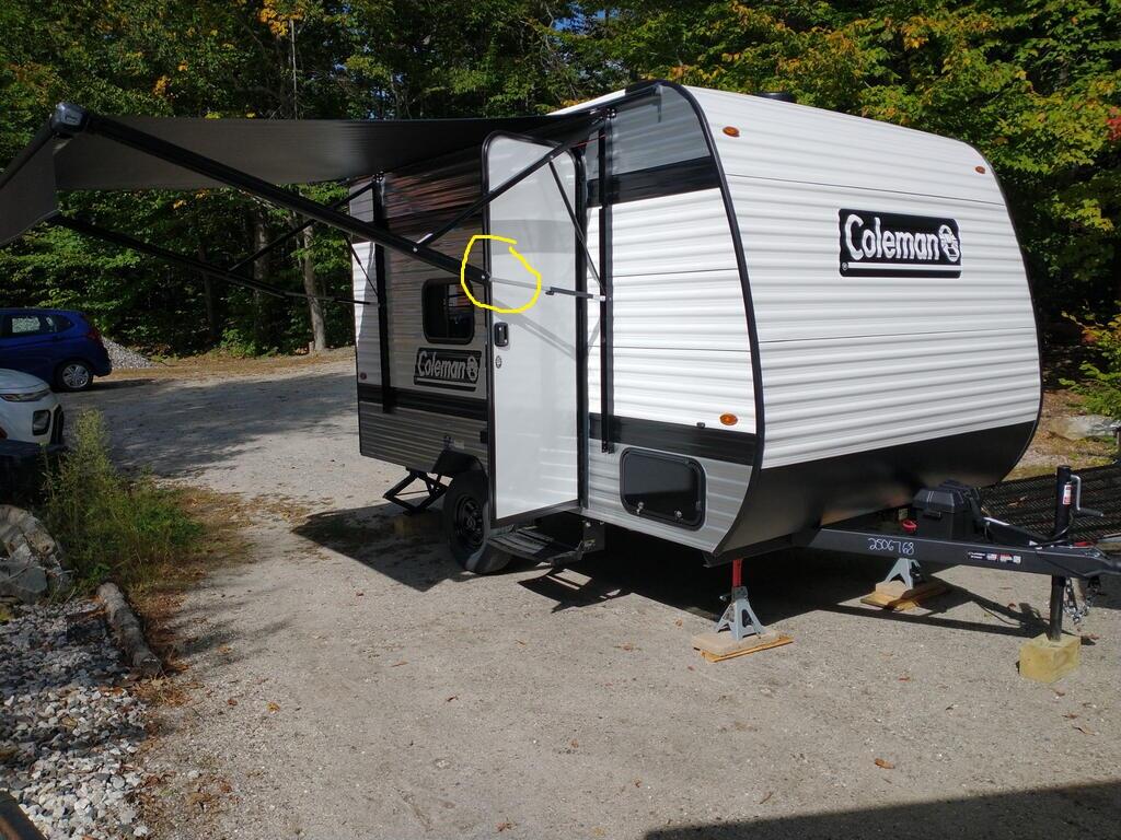

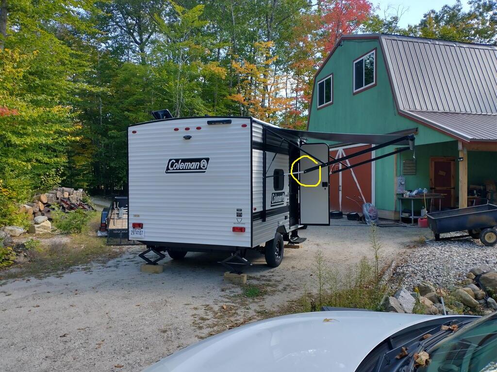

squonk 47,991 #106 Posted September 28, 2025 Good luck with that awning. I can see the door bashing it in the front and someone's head bashing it in the rear. 1 Share this post Link to post Share on other sites
ebinmaine 80,464 #107 Posted September 28, 2025 1 minute ago, squonk said: Good luck with that awning. I can see the door bashing it in the front and someone's head bashing it in the rear. This door has the stiffest hinges I've seen. It takes actual effort to move it all the way from closed to wherever you stop it. Hopefully that'll last and hopefully the door won't bash smash bend the awning frame. I took a brief look at the contact point there. Wondering if I could/ should add protection of some sort. Maybe put a rubber baby buggy bumper on the door edge..... The rear is higher than it looks. My head is the only one close. Will I hit it? You bet! Came damn close at least twice yesterday. That may get a DOT Conspicuity Tape on it. And I'll still hit it. 1 3 Share this post Link to post Share on other sites
953 nut 68,830 #108 Posted September 28, 2025 26 minutes ago, ebinmaine said: door has the stiffest hinges I've seen. It takes actual effort to move it all the way from closed to wherever you stop it. The hinges are probably catawampus, if the hinge pins aren't aligned they will bind against each other. Share this post Link to post Share on other sites
ebinmaine 80,464 #109 Posted September 28, 2025 8 minutes ago, 953 nut said: The hinges are probably catawampus, if the hinge pins aren't aligned they will bind against each other. That was my first thought too but they're a long hinge. I'll check again but it'd be tough to misalign them. If they're outta line I'll fix adjust repair as needed. We don't need them to loosen because of excessive wear. Share this post Link to post Share on other sites
nylyon-(Admin) 9,052 #110 Posted September 28, 2025 17 minutes ago, 953 nut said: The hinges are probably catawampus, if the hinge pins aren't aligned they will bind against each other. They actually manufacture many of the new door hinges this way, in fact I can get a kit to add those to my RV and for good reason. Once when in S.C. I opened the door and the wind grabbed it and swung it opened so hard that the plastic door stopper mounted on the wall of the camper poked a hole in the door. The stiff door hinges prevent that from happening, and I would bet is why Coleman used them in this case, also to hold it open when the awning is extended. This is a really nice camper Eric, I was trying to convince my son to get something like this to pull behind his Wrangler. I think you are on the right path to replace the cheaper tires with good quality tires, and if you can add a TPMS because most blowouts happen from under inflation. With the 120v systems powering the core utilities of the camper, I would definitely consider an inverter and Lithium batteries. My understanding is that this camper is wired for an inverter already. Generators are great, but some places don’t allow them past certain hours. 5 Share this post Link to post Share on other sites
SylvanLakeWH 32,292 #111 Posted September 28, 2025 44 minutes ago, ebinmaine said: Will I hit it? You bet! Add a foam noodle to your camping gear. Cut to size, slit it and put it on the canopy support. Throw it in storage when not in use. I used bright green. Does two things: 1) makes support visible, 2) adds softness to the inevitable head contact... 2 3 Share this post Link to post Share on other sites

ebinmaine 80,464 #114 Posted September 28, 2025 Today Trina and her momma put a piece of pine on the end of the cutoff shelf to keep things in place while moving down the road. They also used some of the trim and block off panels to create a small shelf above the window. This will hold very light items only. It has a USB/C port just out of sight above it. Handy dandy for phones or other items to be charged overnight of we're connected to shore power. The piece of trim on the left is to block/cover old screw holes 🕳. 3 Share this post Link to post Share on other sites
